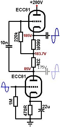

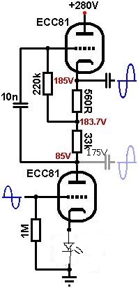

Could I use 1N4148 or infrared LED http://es.rs-online.com/web/p/products/267-8396/?origin=PSF_438282|QVBasket%20Summary-LL in place of cathode resistor bypassed with capacitor?
