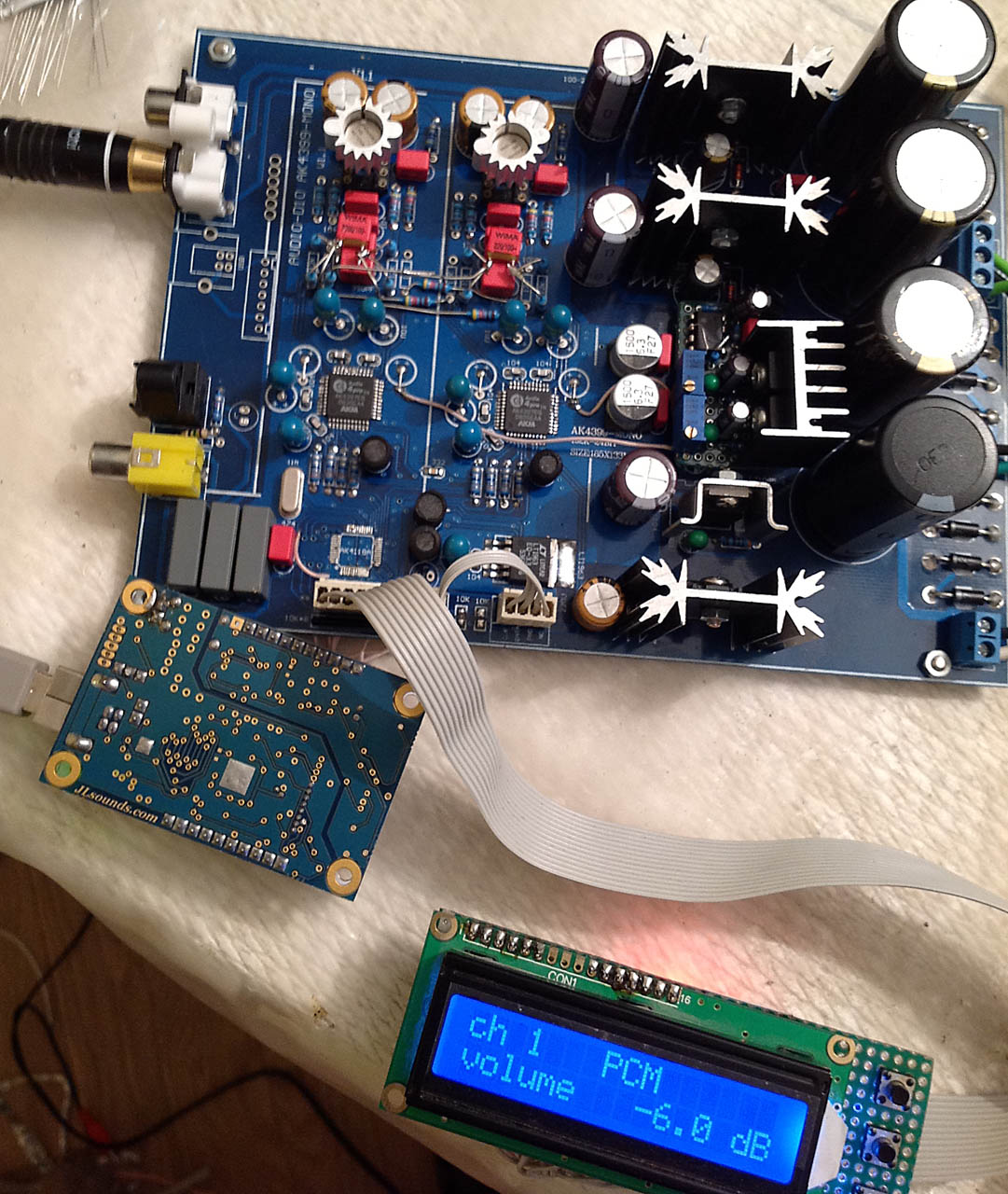

Couple of words for discoveries about display hanging problem of the "red board" DAC (Yuan Jing version). Problem stays despite re-connecting ground planes as described in posting #1014. The hanging of display appears when switching between different signal bitrates, for example going from 48kHz (TV-box) to 44kHz (CD-player) and vice versa. At the moment when bitrate changes the information on display hangs and system also stops to react on push-buttons (not all times btw).
As after some observations and experiments I discovered, to solve the case it's needed to reset the microprocessor. To pull-up shortly of pin No 9 of the microprocessor will do the reset. But this helps only AFTER the display hanging was already appeared. After reset the mircroprocessor in case of hanging, the system works flowlessly during the rest of the working session (until power is switched off). To reset microprocessor in preventive mind before display hangs, will not give result wanted. Must be some sort of software bug? If anybody understanding s/w issues here could better explain this phenomena and how to solve it nicely, would be appreciated. Now I suggest to add a button for resetting the microprocessor to get around the display hanging problem.

NinoSimona, I also have version 1 Weiliang board with AK4113. How can I connect Arduino based controller to this board? Do you have the schematic?
Сергей, just a custom ribbon cable. You can even solder a 12-pin header directly to the duino, thank Nino for his wise pinout.

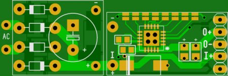

I designed for yourself regulators based TPS7A4700 instead regulators LT1085 (5V and 3.3V) and KA7805 (MC7805) primarily for dual ak4399 and weiliang xmos. This is an archive of PCB and schemes:
http://zalil.su/129646
PCB are made in Sprint-Layout 5.0, schemes in TINA-TI. Regulators are made so as to replace the existing regulators one to one.
The all boards used initially MC7806, and then TPS7A4700, plus 3 smd-caps (1uf). PCB are not do himself, TPS7A4700 soldered neither myself.

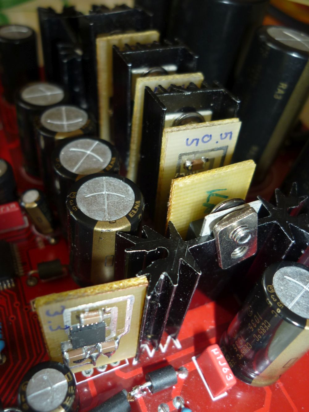

Thanks for sharing regulators, nice work. How do they perform in your 2xAK4399 DAC? Don't they need heat sinks (Vin is quite high, as is current) ?
On youtube you can find instructions on how to hand-solder the qfn packages using a small oven.
Yes. Because I do not have radiators for tsp7a4700, I did a double stabilization. Main voltage drop occurs on the mc7806, who bolted to the heat sink, and a fine stabilization occurs at tsp7a4700, therefore, they do not need a heat sink.Don't they need heat sinks (Vin is quite high, as is current) ?
I note that regulators instead of 3.3V and 5V for ak4113 not the right size ;(. But I was able to place their.

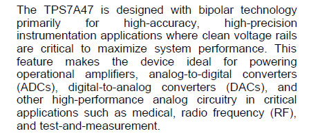

At first I did not think so, because ATDAC-10 is used to power op-amps tpa7a4700:LDO's are suitable only for digital circuits.
http://forum.vegalab.ru/showthread.php?t=69461
But you're right, these regulators are ideal for the digital part DAC, but I did not like in the analog part ;(. But so far I have not finished experimenting.
Ultra low noise LDO
You must inform TI about it 🙂.

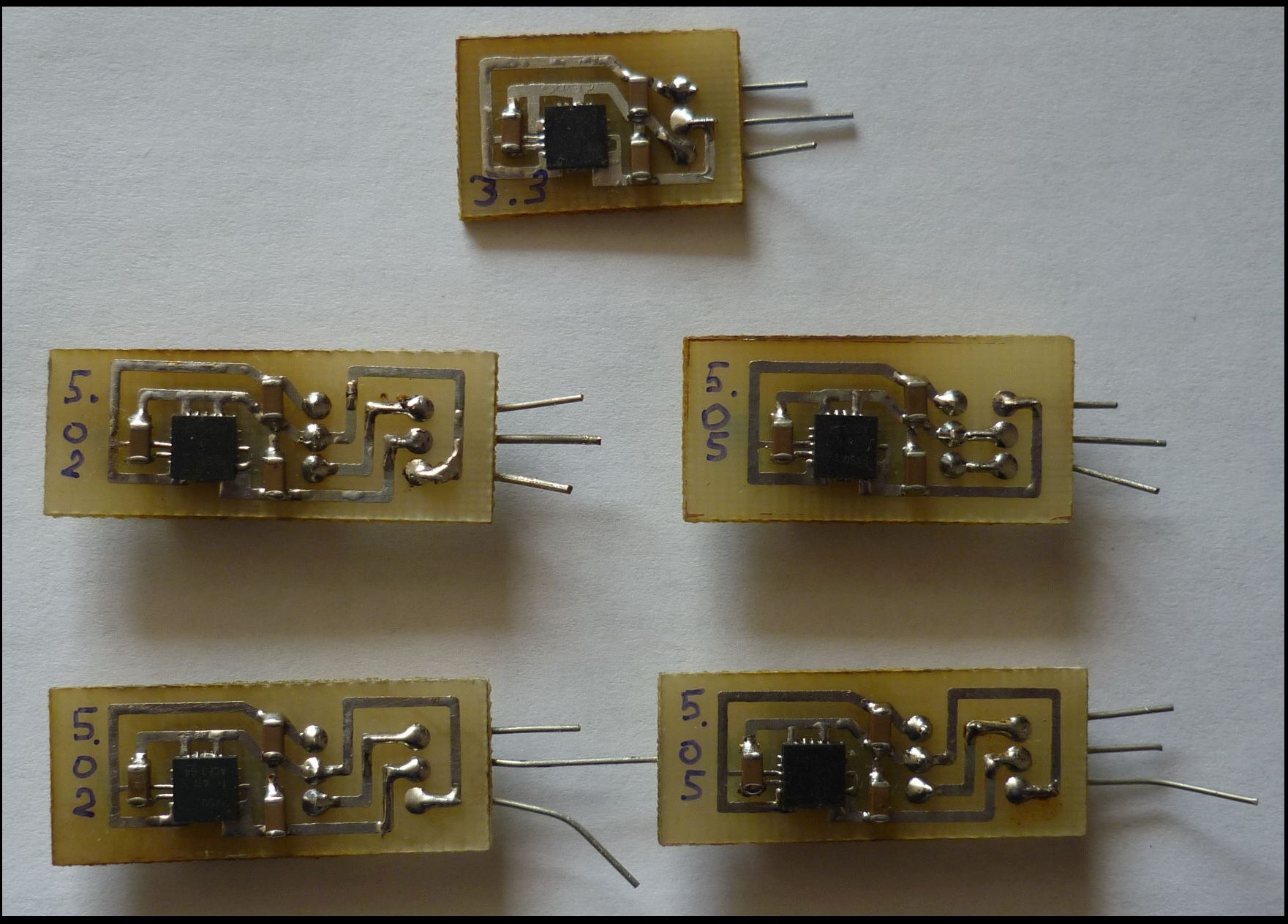

This design does not support heat sink on the TPS7A47 chip. The chip should be "soldered" via "vias" to the opposite (ground) side. After i receive the completed PCBs for this chip, I will share the design. It may be used as the replacement of 7805 too, but it's possible to connect error amplifiers of the TPS7A47 direct to load. The output voltage can be adjusted from 3 to 20V with 0.1 V steps.Don't they need heat sinks (Vin is quite high, as is current) ?
