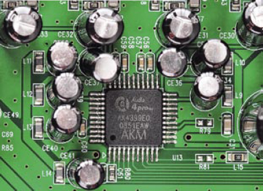

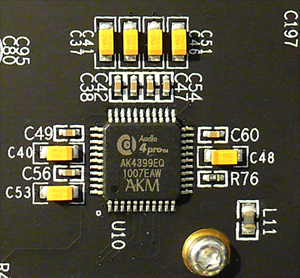

tiny SMD soldering

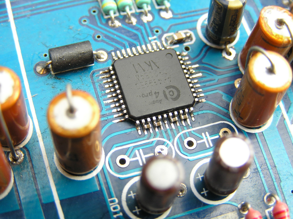

I managed to solder tiny 0402 (1.0x0.5mm) smd X7R caps right on the pins of the AK4399 chips, as suggested by paolo. I found this a good idea, because the position of the 100n film caps on my board was pretty far from the pins, and the film caps were also too large being that close to the dac. So I removed them and placed the smd caps instead.
I'm very happy with the result, the sound has become more refined and 3d picture has improved as well.
The hand soldering is not easy, but I have a few tips. First apply some extra solder to the pins on which an smd cap must be attached. Then apply plenty flux and delicately position the smd cap on the two pins, as close to the chip as possible, leaving still some part of the pad free. When positioned the cap well (I used a needle & patience), take the iron and quickly heat one pad, allowing the solder to melt and attach to the cap as well, followed by the other pad. Don't touch the smd cap itself, or it will stick to the iron. Use of a magnifying glass on stand is a must.

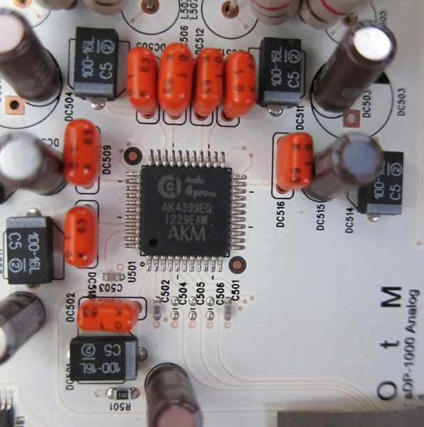

Regardless of nearby regulators, which is well done of course, I think it's worth the effort to place the 100n smd capacitors, because their main purpose is to decouple HF noise, generated by the dac itself, to ground.
By doing this, my dac's sound has become less sharp edged, so better highs, refinement. I'm pretty sure nearby placed low noise regs improve sound further, but I think the small caps are most effective for HF decoupling.

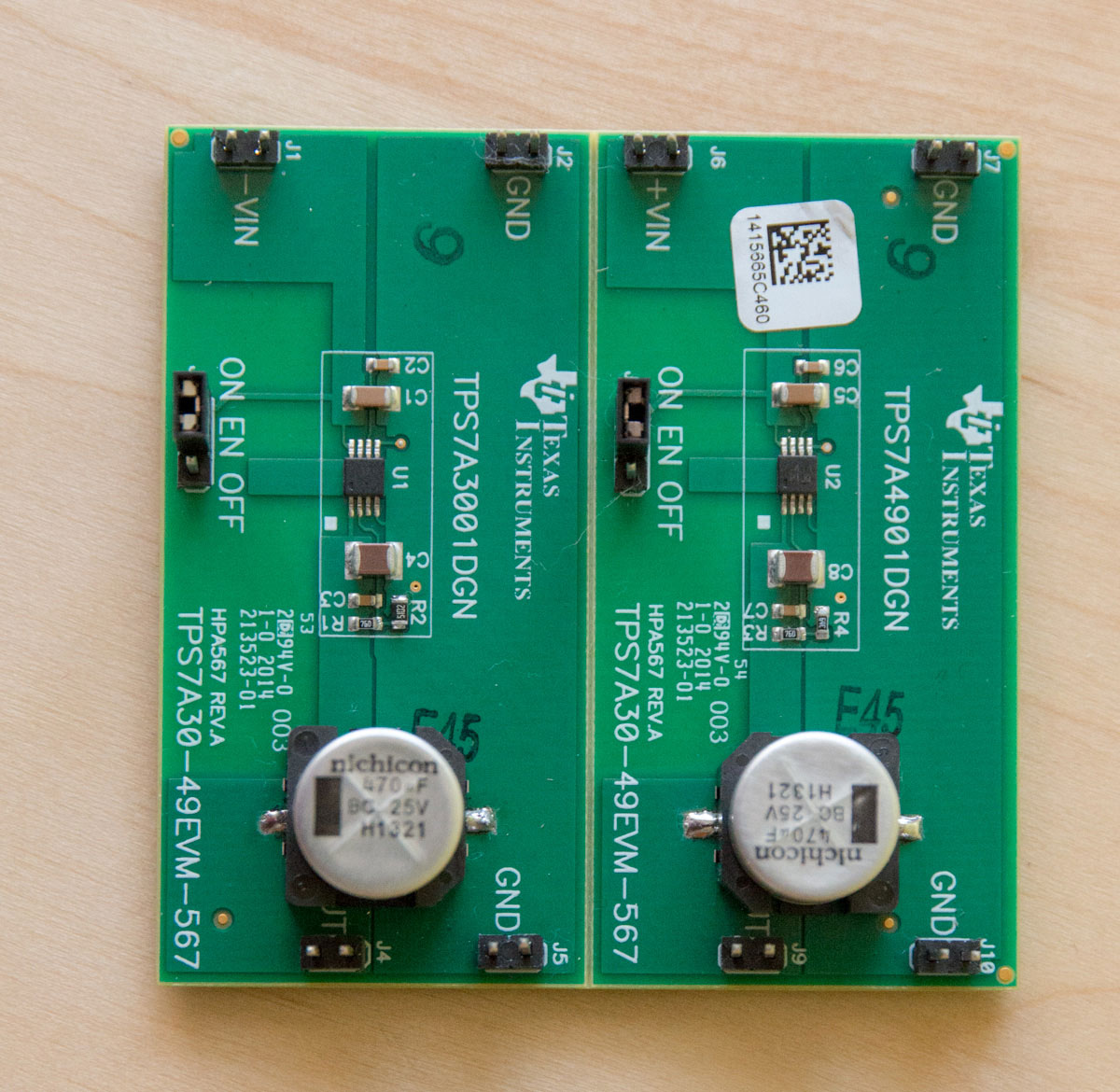

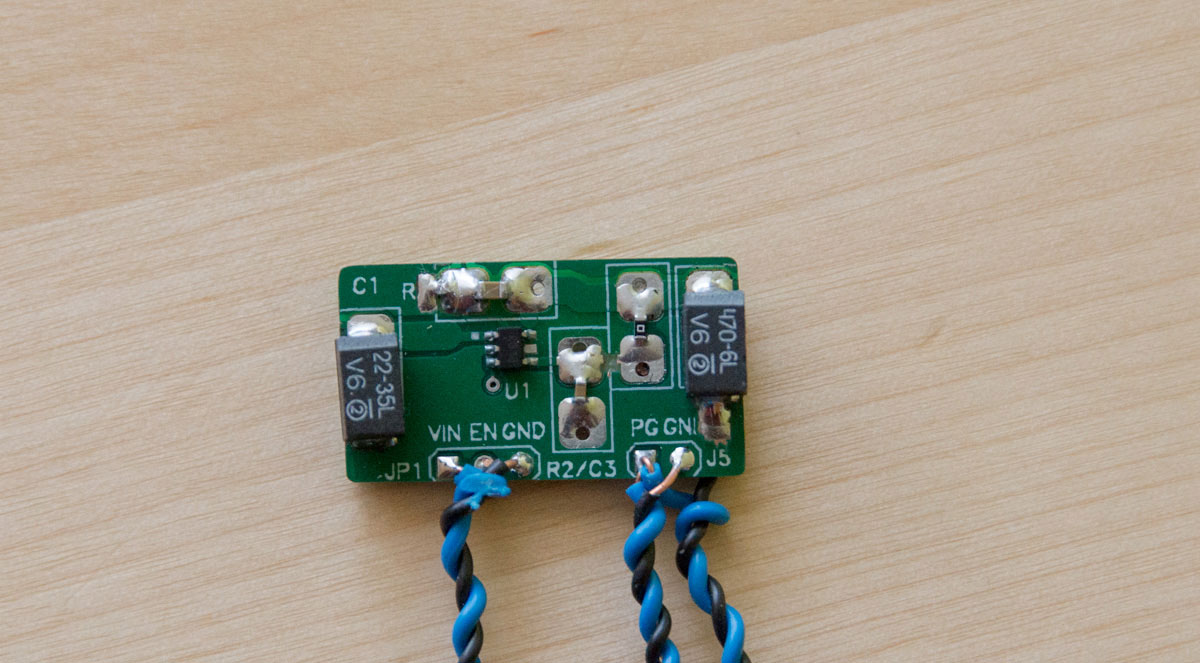

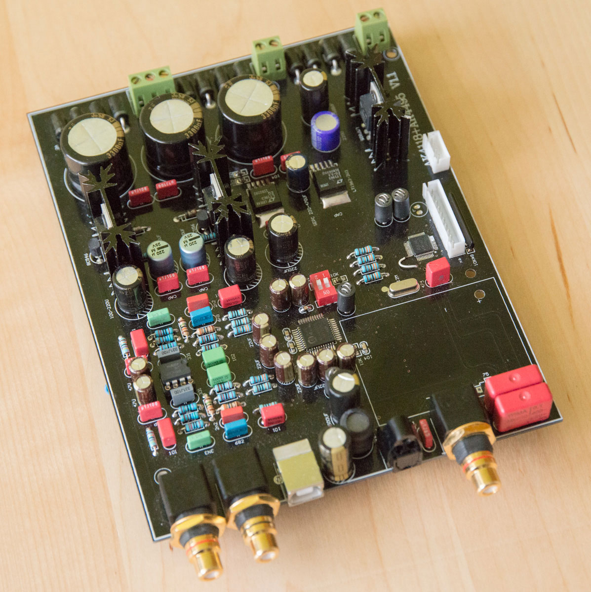

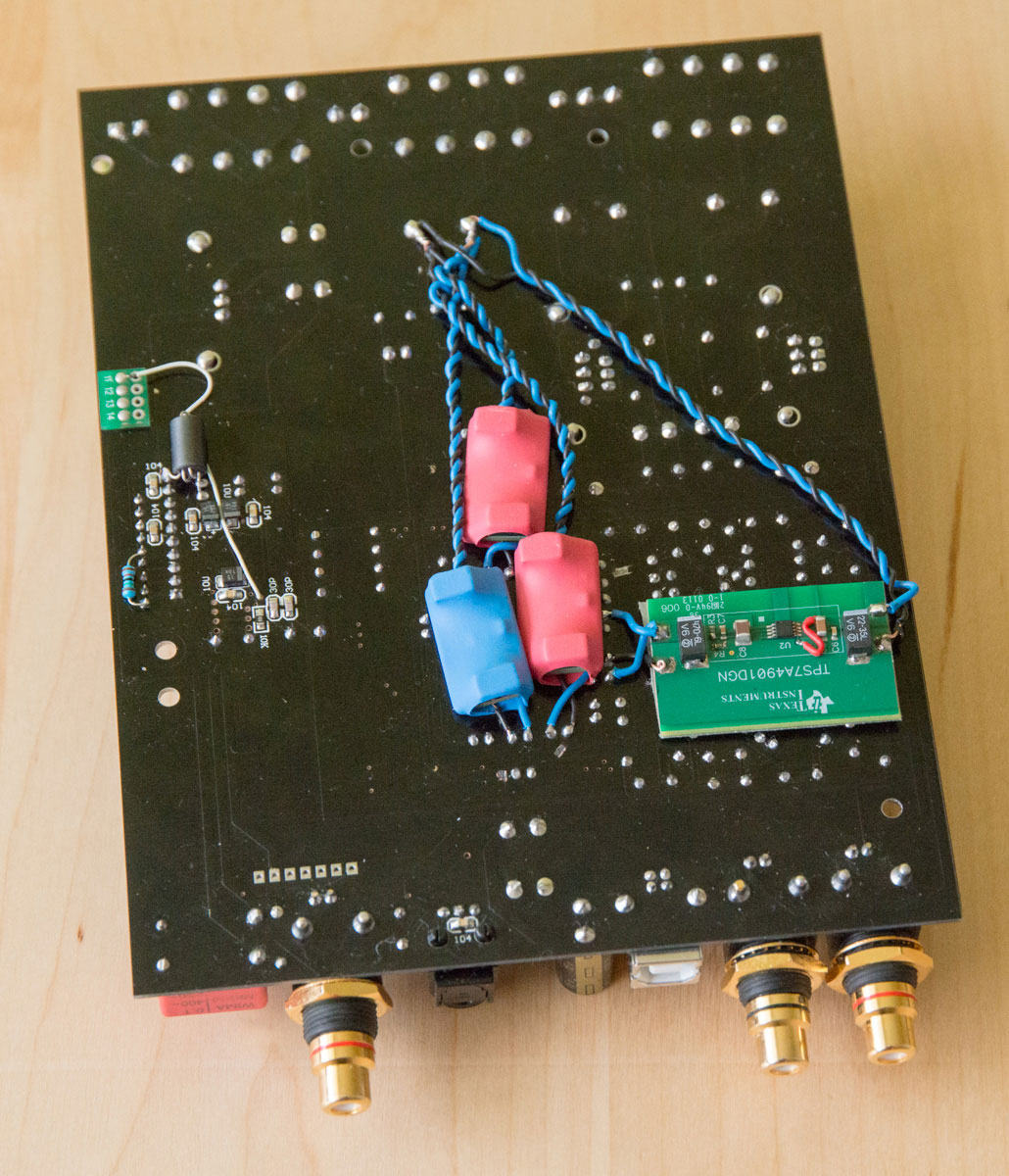

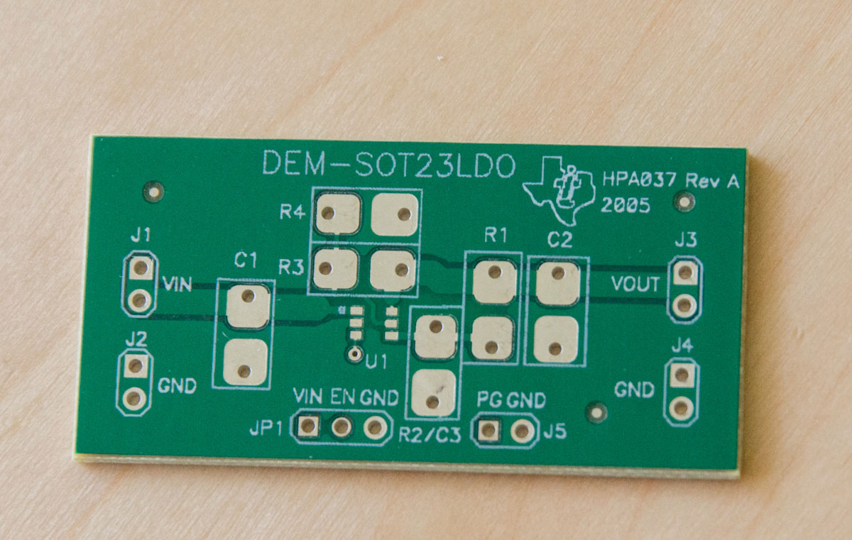

Hi, Nino
OK, some pictures.
On the third photo is an old (large) version of 5V regulator. The last photo displays the current (draft) state. I would like a little bit reduce the size of PCBs and replays the wires.
I've already installed a 4-pins connetor to the DAC PCB .
