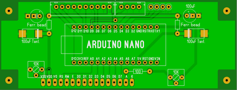

DAC Arduino PCB
I've received my PCBs and I would like to share the layout of PCB that I have already tested. At first, the Arduino MC PCB. The layout is in the SprintLayout 6.0 format. If it's needed, I can share the Gerber/Drill data files too.

pca01: Very nice! I wonder: I see a trace running from Anode pin of LCD, via 100R resistor, via 10 k potentiometer (good thing) to TX1 pin in the Nano. (?) Isn't that supposed to be running to +5V Vcc?
