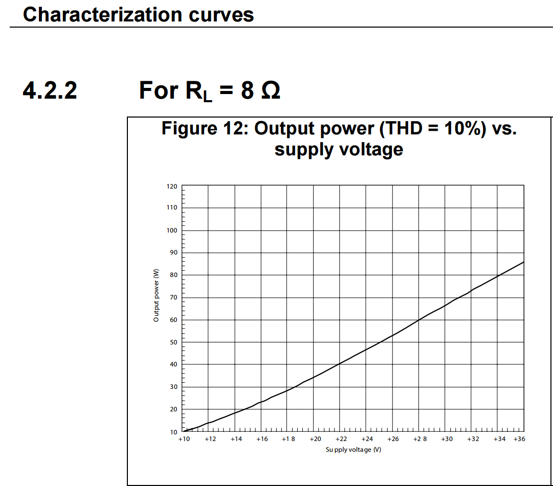

Will this work guys or are the amps too low? https://www.amazon.com/SMAKN®-110V-...8&sr=1-1-catcorr&keywords=36+volt++ac+adapter
One of the reasons to choose a TDA7498 is that it can deliver ~50W/channel before distortion starts creeping up. To do that, it needs a ~36V supply, which that is. But that 36v supply needs to be able to deliver >100W, which the one you linked to makes no claims of being able to do.
So, yeah, the amps are too low.

Hi easp these are the speakers: 8 ohmsRemind us about the speakers you plan to drive? Impedance?
