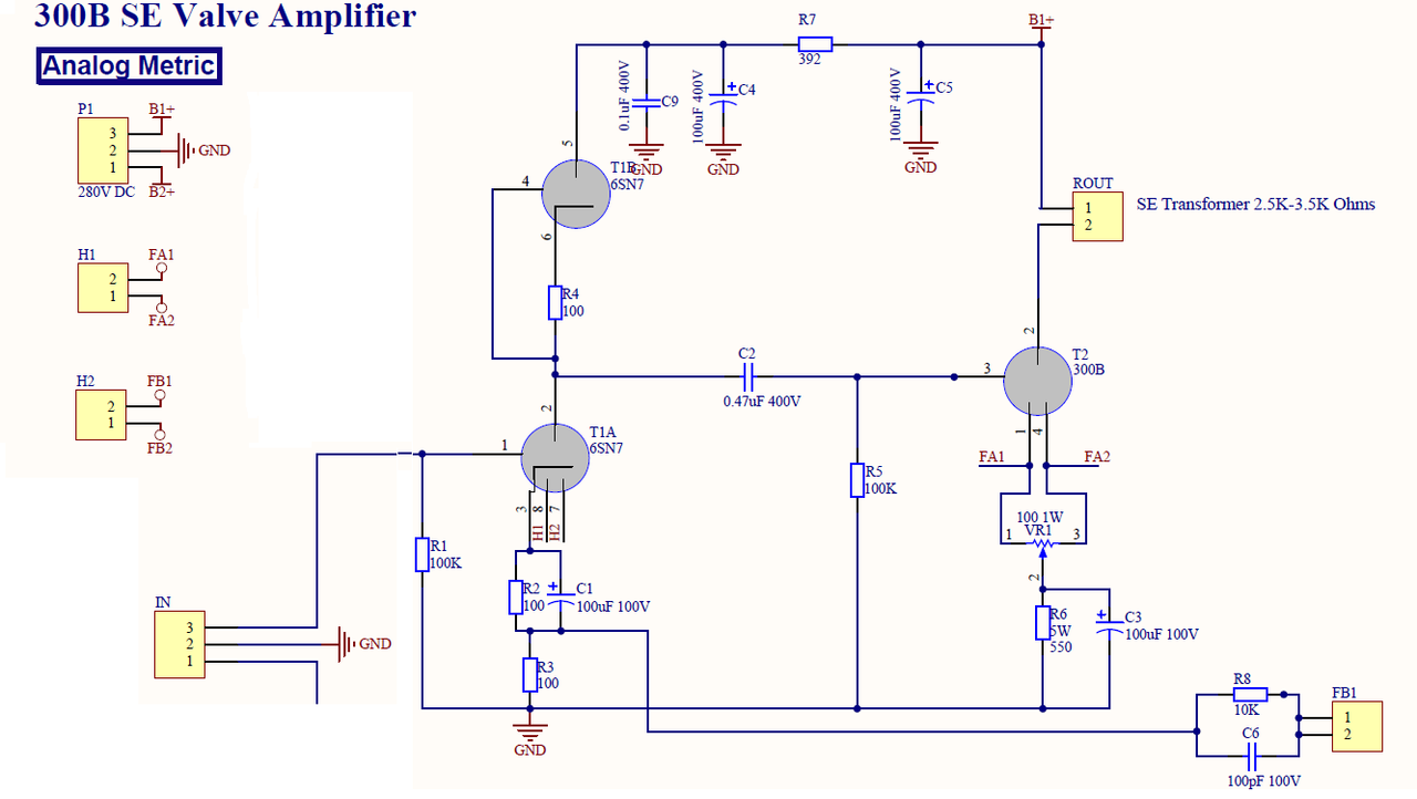

Well the kit finally arrived and I am tracing it out and making accurate documents for it before I start building.
The schematic recommended for mods by Alashikata in post 4 is the closest match to what I believe I have.
so you don't have to go back, here it is again: DIY 300B Single-Ended-Triode (SET) Hi-Fi Amplifier Project
Actually you can mod anything you want. Just hold on to the resistors around 6SN7 where you can change around for mod.
Check out this schematic of pin 2, 4, 6 on 6SN7, it may be the one that match the pcb.
For the schematic on Post # 56, there is only 550 Ohms for the 300B self bias resistor.
What is the B1+ voltage?
Be careful to not run so much current and so much B1+.
Current x Voltage = Plate dissipation.
Do not run the 300B too hot; and do not exceed the original 40 Watts maximum plate dissipation,
or more realistically 36 Watts (Western Electric later revised the 300B plate to 36 Watts maximum).
Happy building, happy adjusting, happy listening!

Good advice 6A3sUMMER.
I am thinking 320V for B+ with 70V for cathode bias for a Vak of 250V. Rather conservative, but it is based on transformers I have on hand. I will see if I can boost the B+.
Thanks Alashikata.
I believe that cathode bias resistor is 880R (R6) Plus P2/2 (100R/2) for a total of nearly 850R.. However I plan on over 1K for the cathode bias to keep the current conservative.
I plan to map out the schematic and post it.
I will then propose mods which I feel would benefit the design, and we can discuss.
I think I have a good schematic, but will wait until tomorrow to verify it before posting it.
At this point is appears to be a two stage 6SN7 common cathode gain stage direct coupled without any cathode bypass capacitors. This drives the 300B through a capacitor with bypassed cathode bias to the 300B.
I will have to calculate the gain of each stage without bypass to see if it has enough gain for my source.
Thanks all.

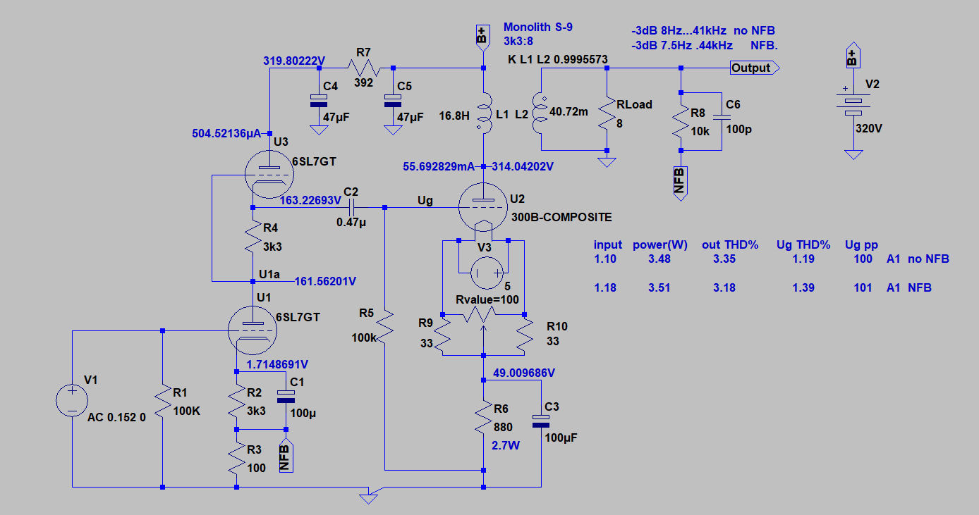

With a self bias resistor of 1k, and a bias voltage of 70V, that is 70mA of plate current.
49V self bias across 880 Ohms self bias resistor = 55.7mA plate current.
Do not forget the voltage drop of the plate current times the DCR of the output transformer primary.
Example:
DCR of 200 Ohms, and 50mA plate current = 10V drop from B+
Scroll down on this data sheet, and pick the operating points you want:
https://static1.squarespace.com/sta...45504889f6da688b7c8ecd/1598378059729/300B.pdf
Example:
300V plate to filament
-61V bias and 60mA = 1,017 Ohms self bias including the filalment balance pot Ohms/2
3400 Ohms output transformer primary.
5.6 Watts @
-30dB 2nd harmonic (3.16%)
-44dB 3rd harmonic (0.63%)
Plate dissipation 18 Watts
That would be 1.34% 2nd harmonic distortion at 1 Watt, and 0.11% 3rd harmonic distortion at 1 Watt.
That is a very good compromise of output power, distortion, and plate dissipation.
Just my opinions.
