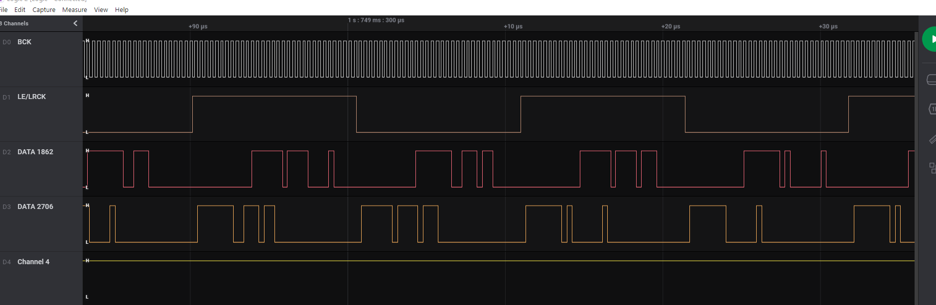

Good Morning Miro,
I have made a screenshot of what the analyzer sees, when playing music.
Doesn't look so bad I would say.
Ch0: BCK 3MHz
CH1: LE/LRCK 48 kHz
Ch2: Data 1862
Ch3: Data 2706
Ch6: GND
Does it help?
Have a nice day

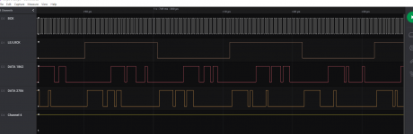

Good Morning Miro,
Ch0: BCK 3MHz
CH1: LE/LRCK 48 kHz
Ch2: Data 1862
Ch3: Data 2706
Ch6: GND
Does it help?
Have a nice day

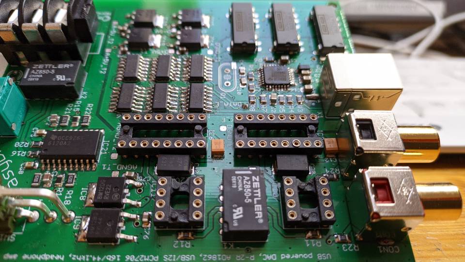

I built this amp in order to listen to music at work (even I am mostly in Homeoffice these times). For work I also got the closed back K371 which seems to be a nice match for me (with the mentioned passive inline filter). Have used it a lot for listening to the original AD1862 DAC via Whammy or ACP+. The latter's slightly euphonic and Whammy more neutral. This integrated one is very neutral as far as I can say up to now.
Now I just have to finish the case. Send some pics these days.
