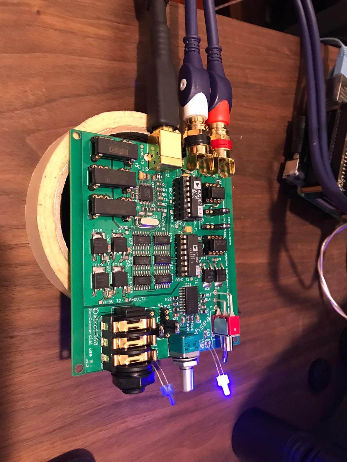

i started to collect the parts since the beginning of april, just finished yesterday, the sound is excellent, from the schematic diagram, you can modify the input signal to i2s direct in, and the better power source, better regulator, the original is dc to dc then 78xx 79xx, but when you power on, i think i dont need to modify the power source and 2706, everything is really ok, sorry, is better than really ok, the opamp i tried op627, muses03, op128, ti5534, jrc5534, S5534, all are ok, finally my ear like ti5534,
but one weakness is headphone amp, this is the first time i listen "tpa6120" amplifier, i tried 2 iem and 1 headphone, all of them no open and no nature, let me run more hundreds hours and will post the result if anyone have interest.
dont think ad1862 is old dac chip, give it a try, good job miro.

First time power
Sweaty moment, when I plugged in and found out that IC4 got hot. Going through all components in the digital chain I found out, the left row of shift registers was mounted in the wrong direction. Phuuu. So turned them around and now all voltages are ok, throughout to the dip sockets. So now I am waiting for 100R resistors before I move on. Have a good sunday 🙂
Good morning,
thanks for the encouragement.
Plugged the DAC in the evening again and my Computer said, the USB device can't be recognized :-(
Could the pcm2706 be destroyed by the initial failure?
I have another one, but desoldering might not be easy.
Seems ok now, as I have found out that C2 was flipped by 180 degrees. So turned it and voilá, the pc accepted it 🙂
So now only waiting for the teh R100 resistors to come.
