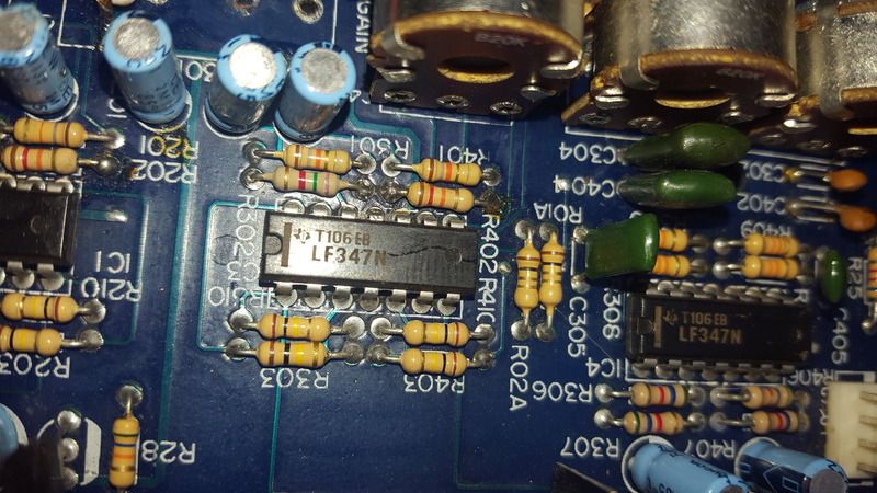

I hope I soldered these jumpers on correct! I was unable to get any sound out of amplifier though.. I have +17.5v on all 4 op amps and -12v.
current draw dropped to 6.5amp with board in sink, I didn't want to take any chances with the power supply so clamped them down...

op amps have -29v and +16v
no audio until I turn headunit up from 0 to about 4 or 5 then lots of popping and distortion.
That's too much voltage on the op-amps. Measure the DC voltage directly across the terminals of ZD1 and ZD2.

For many of the older autotek amps, the zeners are connected to secondary ground on one terminal and the other terminal is directly connected to the power supply pins of the op-amps. That doesn't seem to be the way this circuit works. What supplies voltage to the power supply pins of the op-amps?
I will have to remove board from sink to check that (times like this a schematic would be handy!). it's getting late here in UK now so will check tomorrow.
not quite sure where the ground comes from as it appears to go under the op amps and is a bit confusing without removing the op amps but the +V comes from the R218-R221 and then to the trnsistors to the left of them.
I thought that the rail voltage would go to the large resistors with the metal heatsinks, then to the zeners and from that node to the op-amp power supply pins. Is that wrong?
yes, you're correct, I wasn't following it that route! I have just fitted 6 new gain pots and also noticed lots of dry/bad soldering on the resistors around the op amps.. I will refresh these then refit
success!! one half of this amp is fixed and sounding very nice with a sense of lots of headroom! in the end I think it was a combination of those broken gain pots and really bad/dry solder as I re-soldered lots of bad looking solder. DC voltage is mv on outputs and everything checks out OK.
