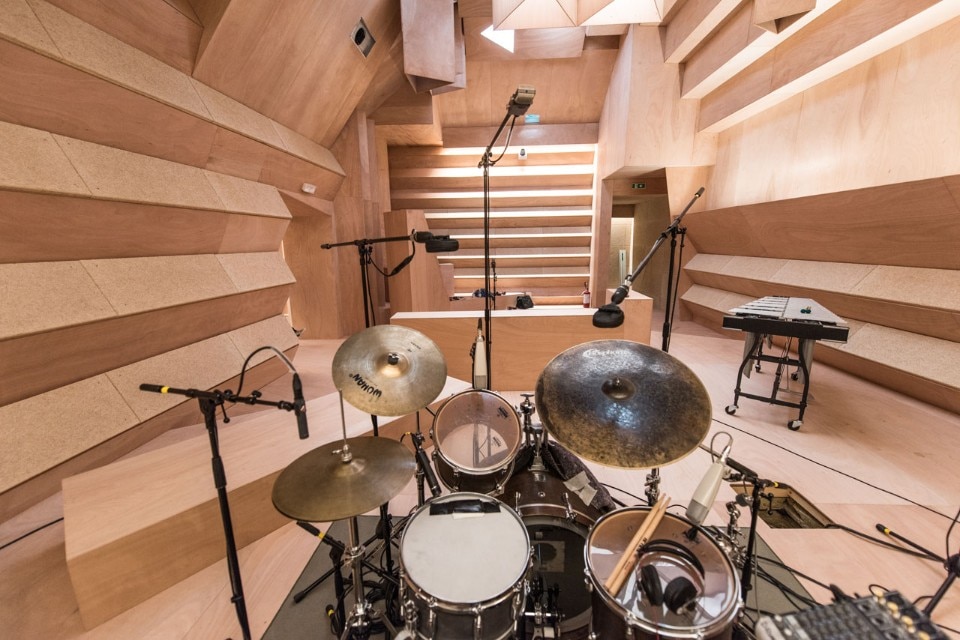

The most extreme architectural design using diffusors I saw is the French pavilion for the 2017 biennale in Venice.
sounds good: YouTube
Is this studio scattering early reflections while allowing higher dB late reflections to give "body" to the sound?
Nah, it can be very cheap and easy to build, if you go with step diffusors rather than trying to do the more complex well type diffusors (that don't really work any better, just easier to predict and design). See the nice designs by Perry (Sound Diffusers 101: Free Designs for DIY Diffuser Panels) or if you're really after easy and fast (and in USA near some big box hardware stores) my Depot Diffusors (Making easy DIY "Depot" sound Diffuser panels, step by step).
