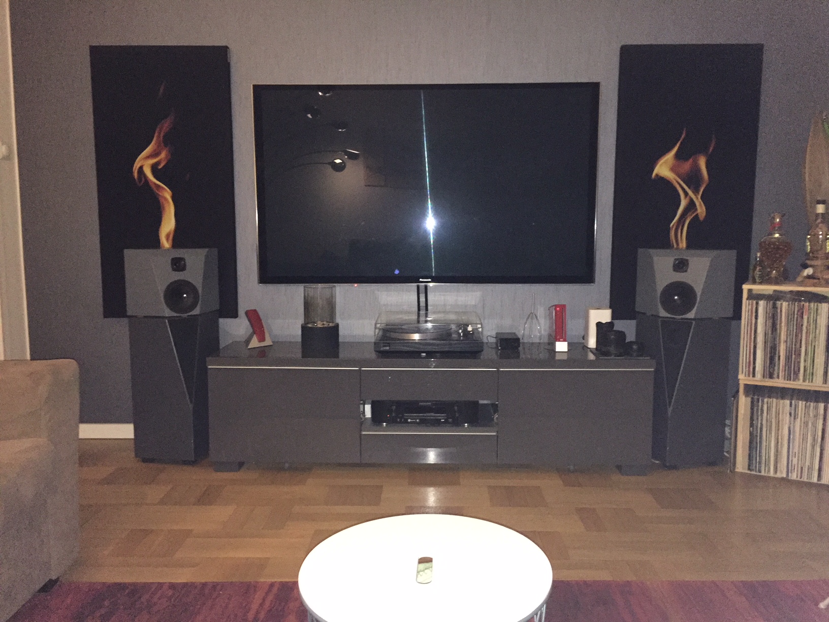

Chiming in here from my experience. I've looked previously into the research and from my own experience adding damping on the wall behind the speakers has always been beneficial in terms of more detail and less background noise. I have DIY speakers with wide dispersion designed to be close to the wall using it as bass reinforcement and heavily toed in. But WAF is a factor so now I just have some damping panels behind speakers.
I have got less impact on sound by treatment of the sidewalls so for now I keep them as is. Room is a small living room with carpet, fabric sofa, pillows, plants etc and stuff on the walls (paintings, decorations etc). I would like more damping bending speakers but it is always a compromise.
