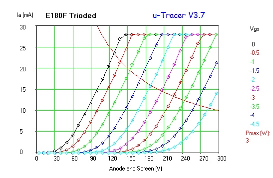

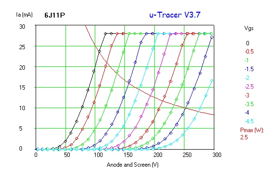

Utracer results for E180F and 6J11P in triode.
I consider the 6J11P closer to E180F than 6J9P, but harder to find these days.
Gary

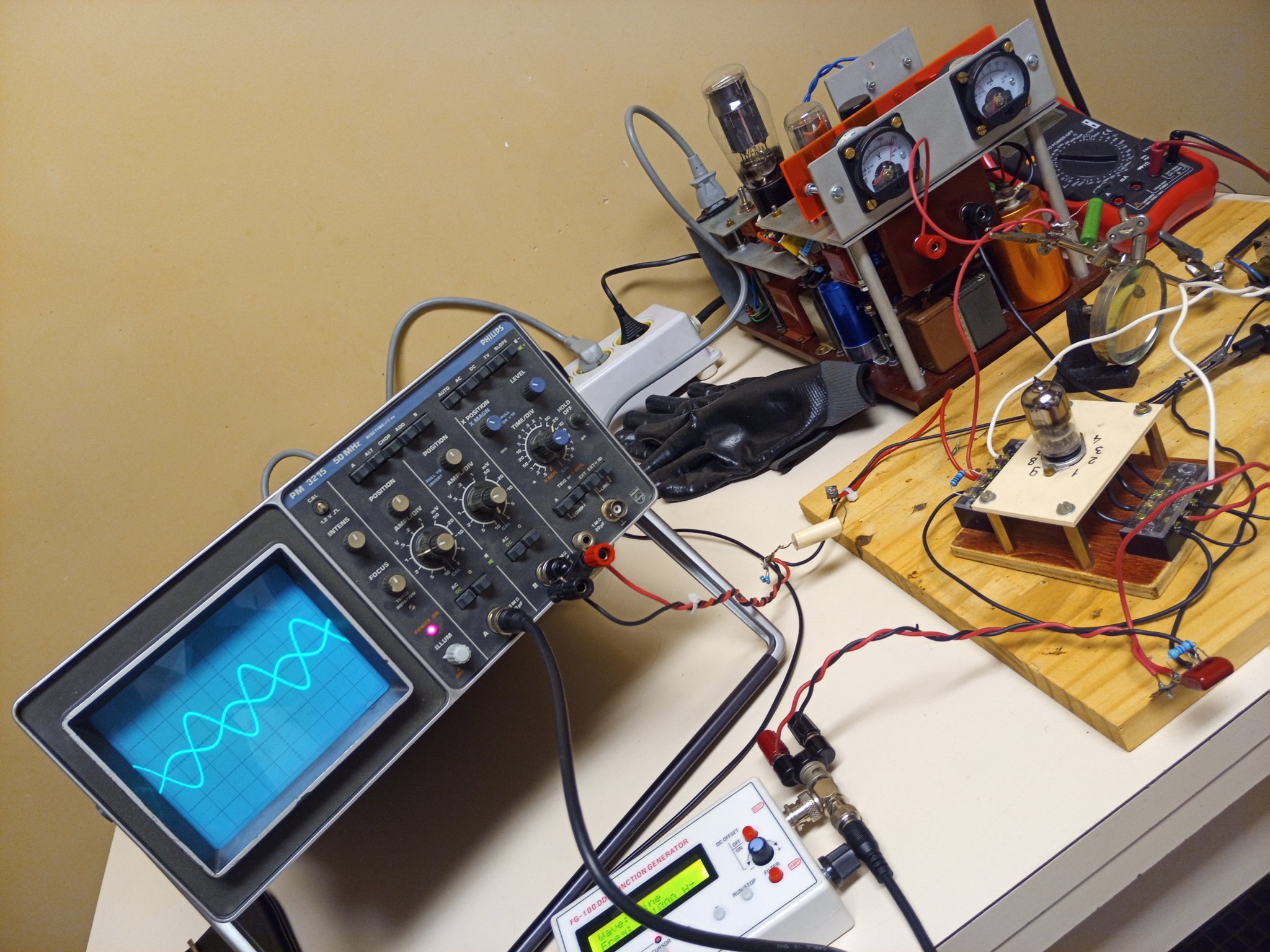

Hello,
3 6j9p on the bench,triode strapped
B+=285v
Ra =12k
Rk=100Ω,no capacitor .
100Ω screen resistor.
3rd grid to cathode.
Ia= around 12,5 ma
Gain = a little more than 30.
It will use for input stage like this,no ccs.
Cheers.
