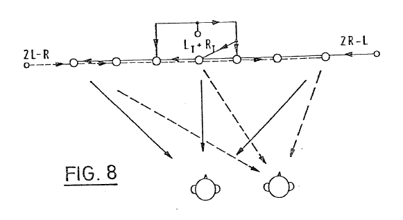

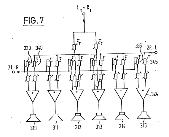

Found a patent for the system that I remember having read about (in German though):
Arrangement for the acoustic reproduction of signals, presented by means of a right and a left stereo-channel.
Jordan is also mentioned. I wonder how they achieved the delay in these days.
Nice find. However this patent is not Jordan's.
What is most interesting in this patent is Figures 7 and 8 !
Take a look !
It's a stereo matrix with x = 0.5 😀
Two decades later Miles arrived in same conclusion about matrix with x = 0.5:
