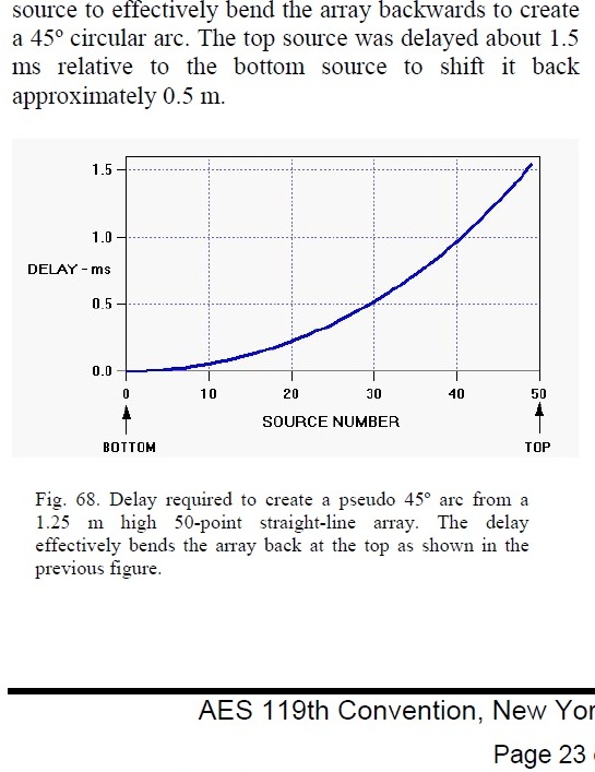

another point - how much of delay is really required?
in CBT paper we can read that in case of a ground-plane CBT array of 125 cm it takes 1.5 ms of total delay between the driver at the bottom and the driver ot the top to make it sound like 45º circular arc (see the attached picture)
furthermore - paradoxically - imperfections of passive delay line could perhaps result in a kind of shading of the array (progressive towards the highs) - which is another thing that helps to achieve constant beamwidth

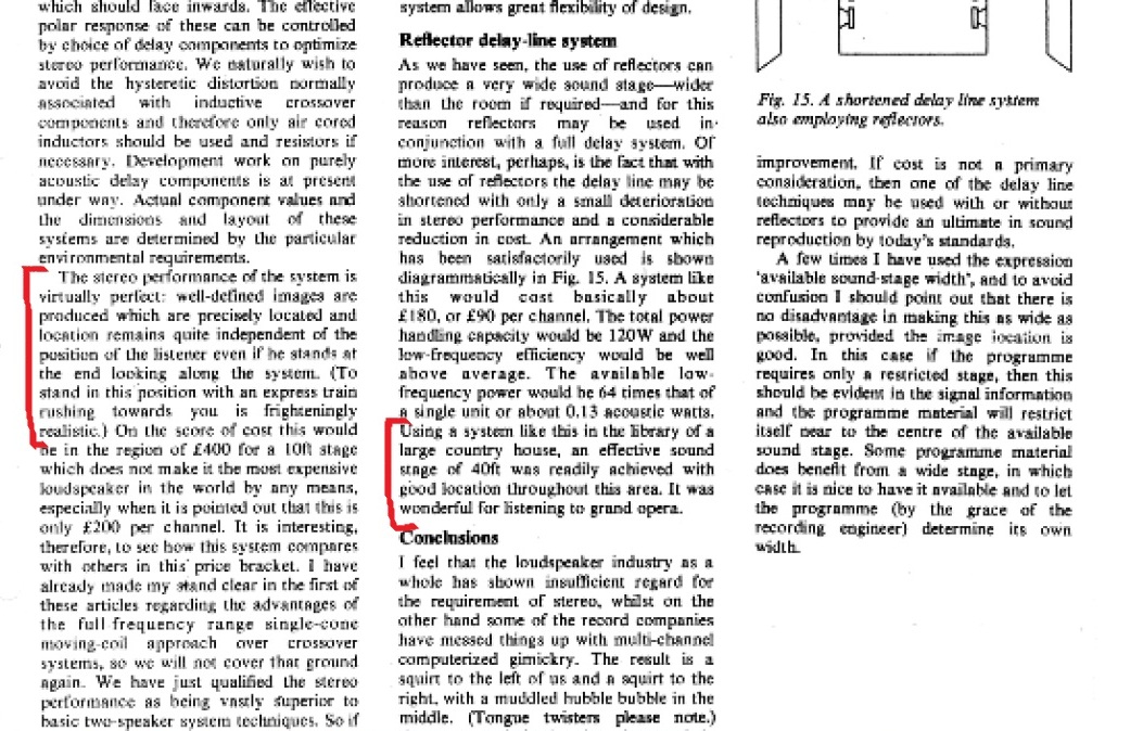

I also have this paper and about 20 years ago tried the reflector mentioned in it.
My attempt wasn't particularly sophisticated, using two fullrange drivers back-to-back and a couple of formica-topped panels as reflectors. It seemed to work OK. I was messing about with horn speakers at the time so didn't pursue it.
I haven't pursued the delay line but I did once ask Ted Jordan about it - he said that he thought his linear arrays (two vertical arrays of 4 units) had superseded the horizontal array.
I didn't ask any further details so don't know how it was achieved. Nowadays DSP would make it considerably easier.

and Your knowledge is based upon...?
because in the 1971 article it is expressly written that the discussed setups were built and tested, we can read ia. that:
- about the sound of an express train rushing towards the listener standind at the end of the prototype full delay line[it] is frighteningly realistic
and
- about performance of the shortened delay line with side reflectorsit was wonderful for listening to grand opera
There is certainly no claim (or understanding at the time) that it was constant beamwidth.
can we conclude anything from the mere fact that modern terminology was not used?
You implied that not only was it a miraculous solution but that it now had constant beamwidth attributes, a quality that Jordan never claimed.
My knowledge is based on 30 years of speaker design with a heavy concentration on network simulation. You can't string a bunch of drivers together with inductors in between and expect it to work as an effective delay line.
If you think you can, then show me measurements or a simulation (neither of which Jordan supplies).
Vaporware.

First, the diagram
should we really stick to this notional diagram (as You have rightly pointed out?)??
I don't know what Jordan built,
an honest answer, thank You
but it wouldn't be the unit as drawn unless he had a magic solution to those first two problems.
just for the sake of discussion - why magic? Jordan was manufacturing His own drivers since the beginning of His own business
He could make for example 64 Ohm VCs - combined 3.2 Ohm sound manageable? Even in 1971?
easily He could make dual VC drivers as well, why not?
good solutions?
Vaporware (vapourware?)
David S.
again - how can You? He expressly wrote that prototypes were up and running
And the fact that the line is shorted by the opposite amplifier?
Perhaps you should explain the theory of how it works since I've expressed the view that it can't.
David S.
David S.
