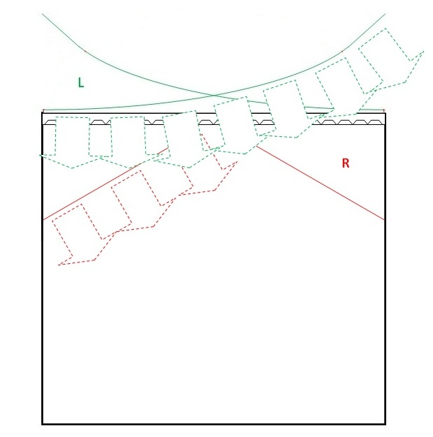

As to the principal of it simulating a pair of horizontal line souces each angled back by 30 degrees to give an illusion of stereo independat of listener location, even this doesn't work in practice. I tried it using a pair of BG ribbons, 6' long, layed horizontal and angled backwards.
I think this is not an adequate simulation - two different directivity patterns
on the scheme below green lines represent the horizontal delay line effect and red lines represent horizontal long ribbon, I mean narrow line source (I know I know B-G is not real ribbon)
I think you would have had to have sat in the middle just about inbetween the X'd ribbons, since you would have had to cross them to get the full effect
exactly! furthermore - and to angle them into a bow-like shape
The problem may have been related to being too far back... or not.
perhaps rather to obviously not being across the (near) full width of the room and not being crossed and angled

Hmmm... So Andrew J agrees that inductor linked drivers will not constitute a delay line: "Doing it with discrete moving coil drivers with series inductors most certainly does not model a sequential delay line with flat frequency response and frequency independant delay." (clever fellow!) (emphasis gleefully added by me.)
He also found the performance with crossed line arrays was unimpressive. Note that the poor performance of a too short line array that Andrew experienced would be shared by the Jordan array (assuming it worked as advertised). Without proper tapering a short line section will have highly variable frequency along its length. In addition a line based on multiple full range drivers suffers from alliasing effects which create numerous response lobes. This would be especially bad if the line were a series of, say, 8" drivers. See my paper on the subject or the excellent One Limited paper you referenced above.
