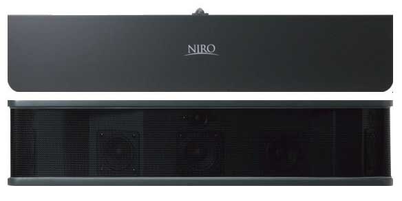

I suppose that it was a kind of 1971 soundbar 😀
a bit like Niro Nakamichi's "1000" Surround bar:
Niro Nakamichi 1000 Surround Bar First Look — Reviews and News from Audioholics
only deeper, with at least 2x2 speakers side-firing, and turned on it's back, then mounted on wall

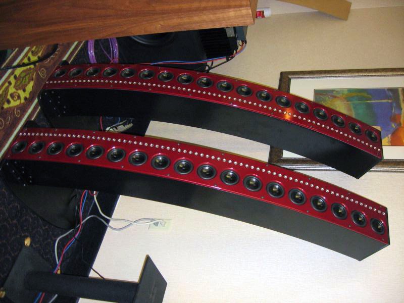

45 degrees curvature to the back? sounds familiar... yes - now it's more clear, it sounds just like CBT of Don Keele!
now read this:
But neither is actually "constant directivity". CBT is only constant beam height, the horizontal is not constant but falls just like any piston source. IMO they should be placed on their sides, or better yet just make a constant beam width in both directions! Now there is an idea!
wow! doesn't it look familiar? 😀
the curvature and power tapering in CBT array are just instead of a proper delay line
looks like old uncle Ted outsmarted the gurus of today as early as in 1971 😀
outsmarted because He showed how to make such horizontal array for stereo not just for center channel speaker

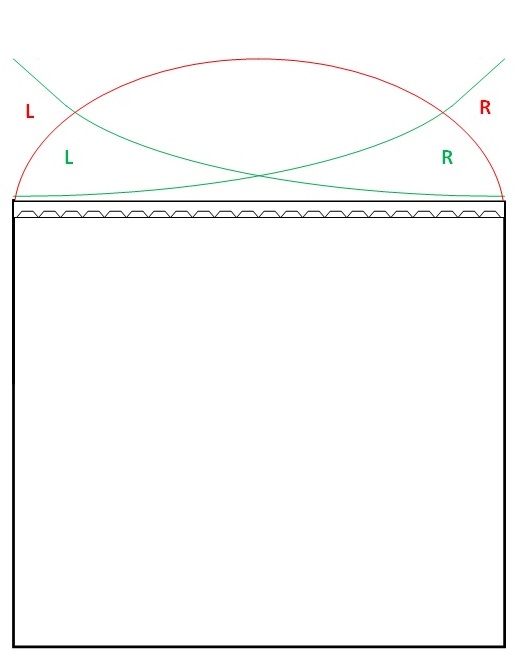

Graf,
you picture is the REVERSE of the curve from the delay line fed array, where the L signal enters from the Left and the Right signal enters from the RIGHT... the sound emanates FIRST from the ends, then is later heard sequentially from driver elements heading to the other end...
_-_-bear
_-_-bear

Graf,
concave? I believe that for stereo it would look even more complicated, more like two horizontal convex CBTs arrays both stretching across the whole width of the room and crossing in the middle
I will post a scheme later

Graaf, yes the reverse of the two examples you show.
The second example you show is intended to keep the HF energy constant back
at the listening position IN THE CASE where the array does NOT go floor to ceiling AND the array is not sufficiently high & the listener is "too far back" to be in the zone where there is "equal energy" (sufficient HF dispersion...).
If the delay lines are set so that they are equal to the speed of sound then the wave looks like a 45 degree (of course it has discrete steps in reality - ha ha) wall coming at you from either side, sweeping from the front of the room and pushing past you to the back - the last energy reaching you from the far opposite side. Not curved.
Of course one could curve it... but that is another story.
The curve would always be concave looking AT it from the listening position... looking INTO a bowl in effect.
The all pass filter that presumably would be used, on paper and in theory, ought to be free of HF rolloff, but in practice, especially at speaker level probably does have rolloffs - I have never tried to build such and don't have the practical experience to know for sure.

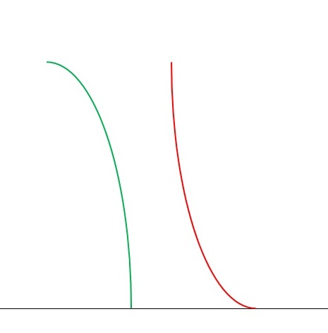

yes, I have read the CBT paper
so it will look/sound like the red curve - not the green on the scheme below?
the why Keele's CBTs are convex not concave?
