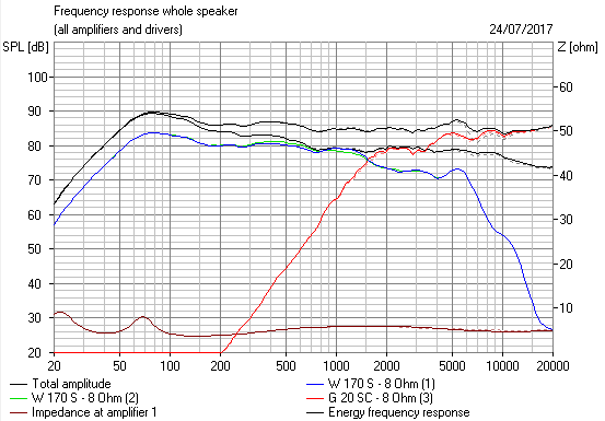

It looks to me like the 27uF is not a critical component based on a huge amount of coil guessing! A 33uF in the LCR made little difference.

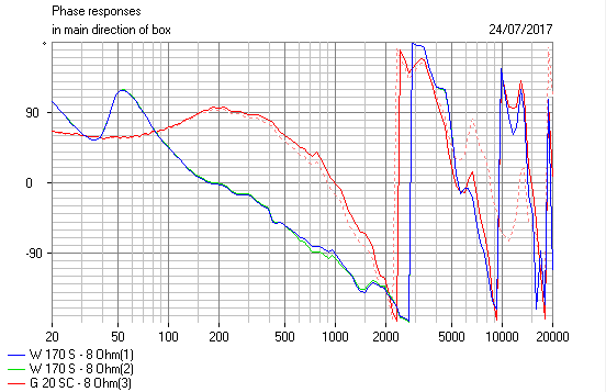

It is a 6dB/octave filter. The actual Dynaudio basses are wildly more rolled off than the ones I used, but the electrical sim and impedance can still be trusted IMO. Amazing big voicecoil on the bass! And we know the tweeter has huge 3mm xMax to cope with low frequencies, if you like that sort of thing.
The dotted line in the impedance response shows the LCR impedance correction is actually almost unnecessary. It's quite well-behaved anyway.

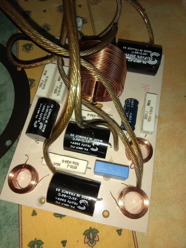

I finally upgrade the solens to clarity cap CSA (dynaudio audience 52 SE)and only in one speaker.
The result: The sound is exactly the same🙁 . I put the speakers together and change the balance with the pc. No differences can be heard.

Well, I did tell you I thought upgrading caps from Solen MKP to Clarity Cap MKP was a waste of time! I don't know why people say the difference is night and day. My own theory is they just unplug and then replug everything, so get a better fresh metal connection. Which is good on all audio connectors. 😀

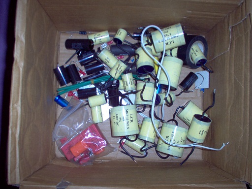

I have a box of capacitors including 50V NP Electrolytics, MKT and 250V Solen and 630V Mains rated MKP. TBH, the yellow high voltage ones are a pain. Being huge! The smaller black ones are 250V Solens. I can never hear the difference beyond NP being a slightly different animal to use, because you allow for the 0.5-1R ESR. There are ways of making low inductance capacitors, involving them being 4X the size IIRC. But inductance is usually negligable with capacitors and wirewound resistors.

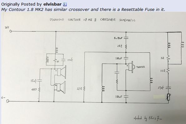

626520d1500468419-dynaudio-focus-110-140-crossover-comparison-details-dynaudio-contour-1-8-mk-ii-jpg
I can explain what the above tweeter lattice network does. It's not impedance shaping, which is done by the network on the right. It's a delay line. We used to call them group delay equalisers. In a loudspeaker, they effectively recess the tweeter, here about 30mm. They were useful in analog telecoms precisely because they didn't wreck impedance. A LC network is to some extent a lumped parameter version of a long delaying cable with a certain impedance. The impedance is Root (L/C), so should be near 6 ohms with a slight complexity in having two of them.
Applying a lattice, which includes a polarity flip, ends up in much the same place as a 30mm tweeter recess, done with a stepped baffle or a sloped one. It time-aligns the flat baffle tweeter in effect. I show the lattice network effect as dotted, versus the solid time alignment (and polarity flip) without it of 30mm recess below.

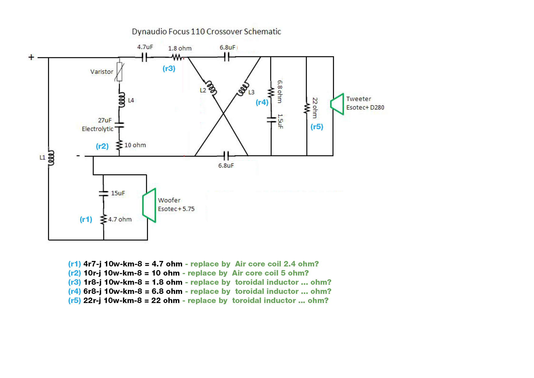

As I don't yet have the F260 schematic worked out yet, I'll refer to the F110/F140 schematic that's posted earlier in this thread as a rough analogue.
1) I understand that I should remove the low-pass inductor L1 or equivalent. Then measure and replace with a suitable air conductor inductor with half the series resistance of the original.
Questions: What are the recommended ways to do the measurement? Would a decent quality LCR meter suffice?
2) I understand that I should remove the all-pass inductors L2 and L3 or equivalents. Then measure and replace with suitable reduced series resistance inductors.
Questions: How do I determine the ideal series resistance? Is there a static measurement approach like with step 1? If not, do you have a sense of what % reduction would be a good starting point from your experience with F220s?
Thanks very much!

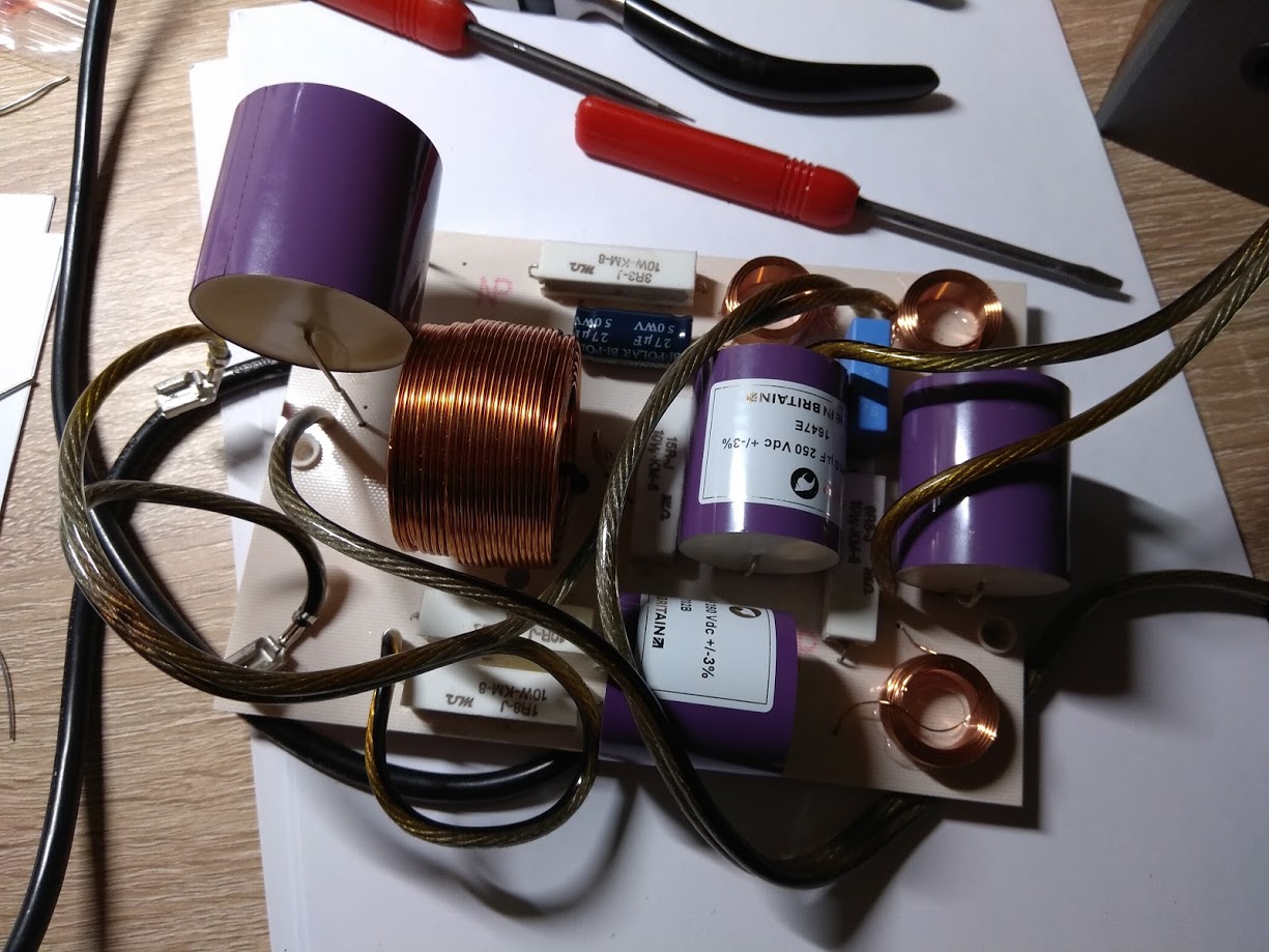

@johnmath or others. I would like to receive some help with my Dynaudio Focus 110. I have been irritated by the coloration of these speakers for a long time. The tweeters are good, but the woofer colors enormously in the middle and upper area. The loudspeaker is certainly not "focus" and transparent as claimed.
My skills are limited, however, I can solder well and can read the electro diagrams a little bit.
My dealer is not a fan of Dynaudio and says that there is too much resistance in the XO. This would be correct with John's adjustments. I would also like to his mods on this speakers before I give up the hope. But I do not know if i'm applying the mods right. I have enclosed the diagram. Perhaps John or someone else can advise with this. I would like to bring back the coloring and make the speaker more neutral and transparent. If possible🙁

Sorry Arnold, did not see this post until now. Midrange colouration will be in the bass driver. The cause will be series resistance in L1, the bass driver low pass inductor, and the 15uF electrolytic capacitor in the Zobel network across the bass driver.
Replace L1 with an air core inductor of the lowest series resistance you can physically fit and afford, or a P-core which will be much smaller, cheaper and a good compromise.
Replace the electrolytic with a 15uF film capacitor. It doesn't have to be super expensive, an entry level Dayton, Solen or Crosscap will be perfect.

The bass inductor should be replaced with an air-core 1.5mH with series resistance less than 0.2 ohms. The series resistance is always specified with good quality components and can be measured with a good quality LCR meter in the R range. The meter and clip leads will need to be calibrated before measuring; many digital LCR meters have a self-calibration mode.
I no longer change the all pass inductors as their series resistance is not an issue sonically. Instead, to bring up the tweeter output I change the attenuator resistors. I'll have to check what I've done and post back. It's also worth to change the 27uf electrolytic in the bass driver Zobel network with an audio grade film capacitor.

Stephen, I popped open the Focus 110s today to see what I had done. I generally can’t fault Dynaudio crossover designs so all I did was the standard upgrades I do to Dynaudio loudspeakers of the Audience, DM and Focus series. For the Excite series I do change the crossover configuration back to traditional Dynaudio first order topology for its superior time domain response and in-room power response.
The bass driver low pass inductor was replaced with one that has a DCR of <1/20 of the DCR of the bass driver, which in this case is 3 ohms, so the target for the inductor is less than 0.15 ohms. The original is 0.41 ohms. I usually would use an air-cored inductor, but I doubt if the ones I used for my Focus 220s would fit through the opening of the F110 bass driver. I used a Jantzen P-core part number 000-5144 1.2mH / 0.14 ohms inductor.
Electrolytic capacitors should be replaced with audio grade film capacitors. It’s a misnomer to think capacitors in bypass locations don’t need to be audio grade; after all it is audio they are bypassing and if they fail to do that well it will be audible! I can’t remember if I replaced the capacitor in the bass driver Zobel network (R1 and the 15uF capacitor) but it has a Solen metalised polypropylene in there, the same as other capacitors Dynaudio have used.
I didn’t change the 27uF electrolytic because when I did these years ago. I mistakenly thought it was an out of band equalisation network to make the load impedance seen by an amplifier benign above 20kHz. It isn’t; it’s a frequency shaping network so it needs to be changed and I have ordered Dayton DMPC polypropylene capacitors for that (they’re a little smaller and it’s a tight fit).
The tweeter rear chamber is resonant at ~2kHz and needs damping, so I plugged the dimple and covered the rear with a stick-on constrained damping material, like that used in cars behind speakers. Leave the tiny vent hole in the back uncovered so the tweeter diaphragm can adjust to changes in barometric pressure.
I don’t change the other small inductors in the tweeter circuit as their series resistance is already factored into the crossover tuning and to change them would upset it.
In the larger cabinets it is beneficial to add damping to any resonant areas of the cabinet, but there’s not much untreated cabinet wall surface left to damp in these little boxes, so I didn’t add any.
Nor did I upgrade the internal wiring as it is quite substantial anyway. For the F220s I replaced the internal wiring with Canare 4S11 (for input) and 4S8 (for drivers) star-quad speaker cable wired for inductance cancelling, as this prevents the leads becoming loosely coupled transformers with each other or anything else, and significantly reduces any microphonic contribution from the cables.
Now that I think about it, when the capacitors arrive, I will replace the woofer and tweeter leads with Canare 4S8.
