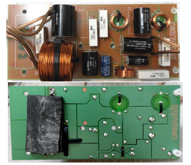

Could you make a sharp snapshot of the circuitboard from
the side where traces are? I know I have seen these fuses
in series with tweeter.

Lojzek,
Attached the layout. The PCB layout is inverted for easy comparison.
The cable tie that hold the L4 only has the direct link with the resettable fuse. There is no continuity between L4 and R3.
Attached is also the latest data of the possible tweeter used. I know about the old website of all the DIY version of the dynaudio and driver. But this is clearer. See the resonance peak?
I will share later of the graph on the 5kHz to 7kHz peak.

A resettable fuse makes some sense, assuming the schematic is correct. It will cutoff the impedance correction, increasing the impedance of the speaker, reducing current, lowering movement of the tweeter.
It will act as a compressor/limiter.
If the schematic is correct, and I doubt it is, it does not
make a difference to tweeter dissipation whether fuse
trips or not, because it does nothing to tweeter output.
Tweeter receives the same voltage and the resistance in
series with tweeter doesn't change.
It is now clear to me that the fuse is in series with RLC.
Assuming this is a resettable fuse, what it does, it does
not protect the tweeter at all. At certain voltage, it protects
the amplifier by decreasing current flowing through the
fuse+RLC branch. The voltage and current flowing through
the tweeter does not change, no matter what fuse is doing,
according to your schematic.
Your right.
