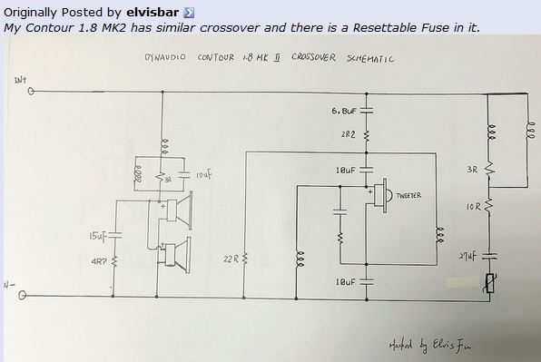

My Contour 1.8 MK2 has similar crossover and there is a Resettable Fuse in it.

You mean parallel 22uF and 4.7uF for 27uF total, of course.
I'm getting a headache just looking at that one. It's the old delaying lattice again, isn't it? It is a shallow 6dB filter electrically AFAIK. The Dyanaudio tweeters seem to have an extraordinary Xmax around 3mm (long tinsel leads?) so they seem to survive this.

Reading back over the thread and there seems to be question mark over whether the circuit is even drawn correctly.
If it is as drawn, and assuming the whole network is fed from a voltage source (i.e. low output impedance amp) then the network does nothing beyond adding an extra load to the amp.
Am I missing something ?

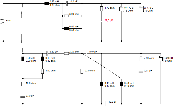

I don't know if you'd hear it either, but the 27uF is part of an LCR impedance correction circuit. A 33uF would give you a different Q and centre frequency. So I'd guess you'll have a little ripple in the impedance.
Since the NP electrolytic is in series with 10R, it's hardly stressed and ESR shouldn't play much part. But in general resonant circuits are most demanding of tolerances and quality.
Sorry, I'm too lazy to sim this one. But you should. 🙂

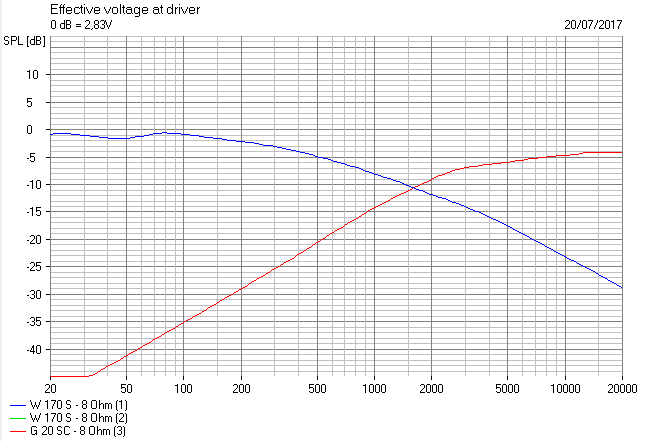

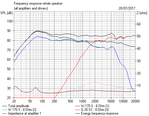

It looks to me like the 27uF is not a critical component based on a huge amount of coil guessing! A 33uF in the LCR made little difference.

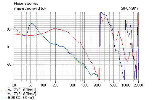

It is a 6dB/octave filter. The actual Dynaudio basses are wildly more rolled off than the ones I used, but the electrical sim and impedance can still be trusted IMO. Amazing big voicecoil on the bass! And we know the tweeter has huge 3mm xMax to cope with low frequencies, if you like that sort of thing.
The dotted line in the impedance response shows the LCR impedance correction is actually almost unnecessary. It's quite well-behaved anyway.
I don't know why you are changing the caps at all, TBH. 🙂
I would be examining fitting a higher order tweeter filter. Which is really going to change things. No pussyfooting about! 😀
