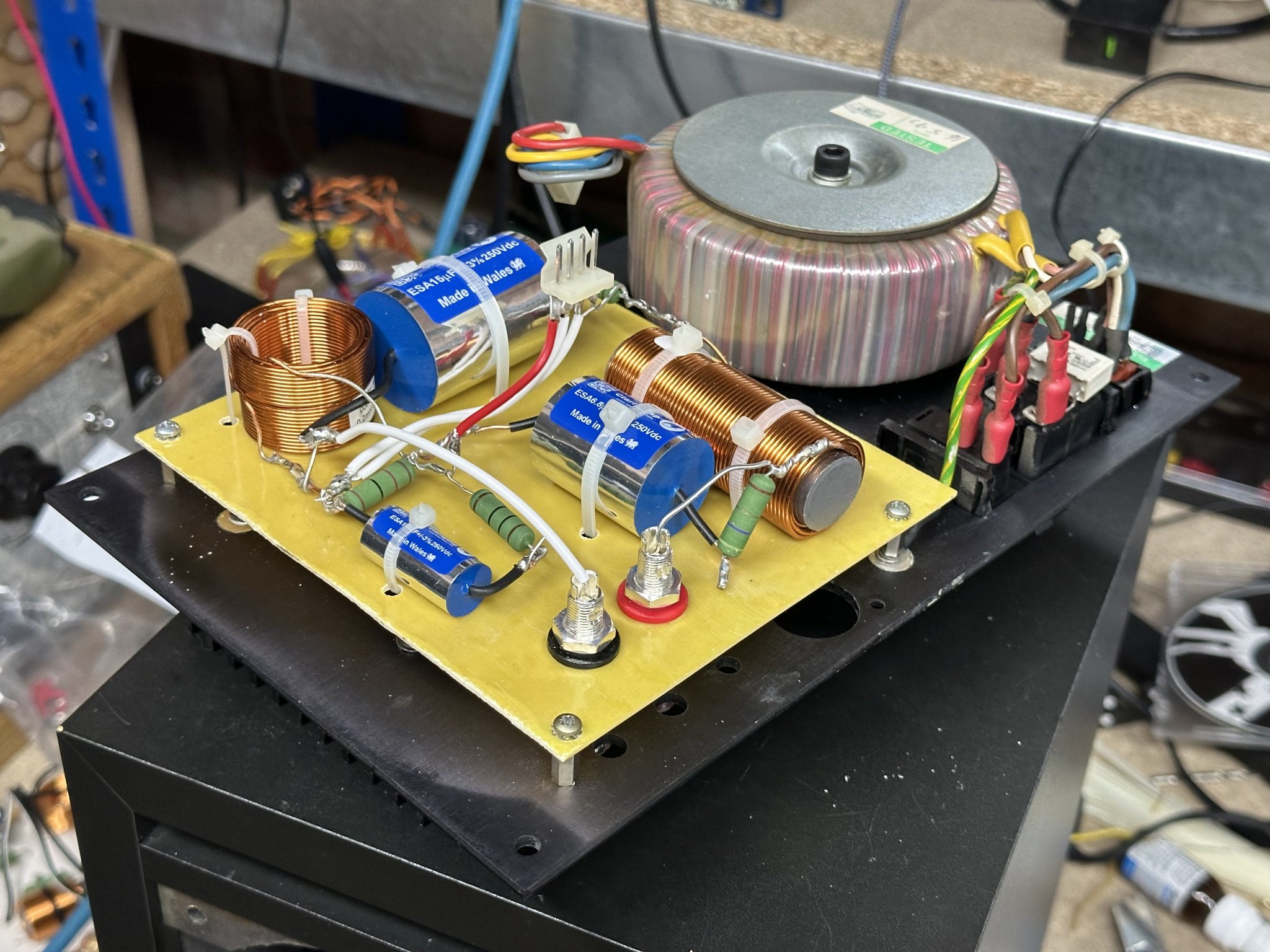

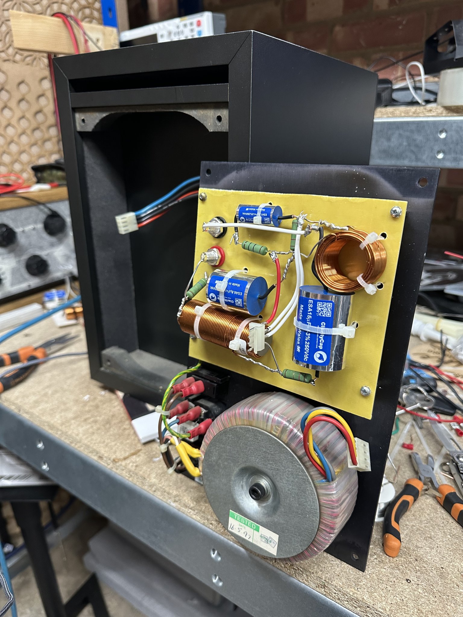

I hope this is helpful to anyone else attempting to convert a BM6A to a BM6P. As I read through this thread the suggested crossover schematic was never tried by the user who started the thread. I tried it and it worked flawlessly. The sound is truly sublime. I’m a huge fan of Dyns as I currently have their BM5 mk1, BM15A, and Audience 70 and have been using them for 10 years. These modified BM6A-s sound very much as they should. Anyway, here’s my findings on the crossovers.
I found close matching inductors from Hificollective and have more or less the desired resistance:
000-1357: 0.2mH Jantzen Air Core Wire Coil AWG18, 1mm diameter wire
000-2097: 1mH Jantzen Iron Core Coil AWG17, 1.2mm diameter wire
All together both crossovers came up to 130£ in parts. I used Claritycap ESA capacitors and Jantzen Superes resistors. I also used silver plated: copper wire, banana plugs, and solder.

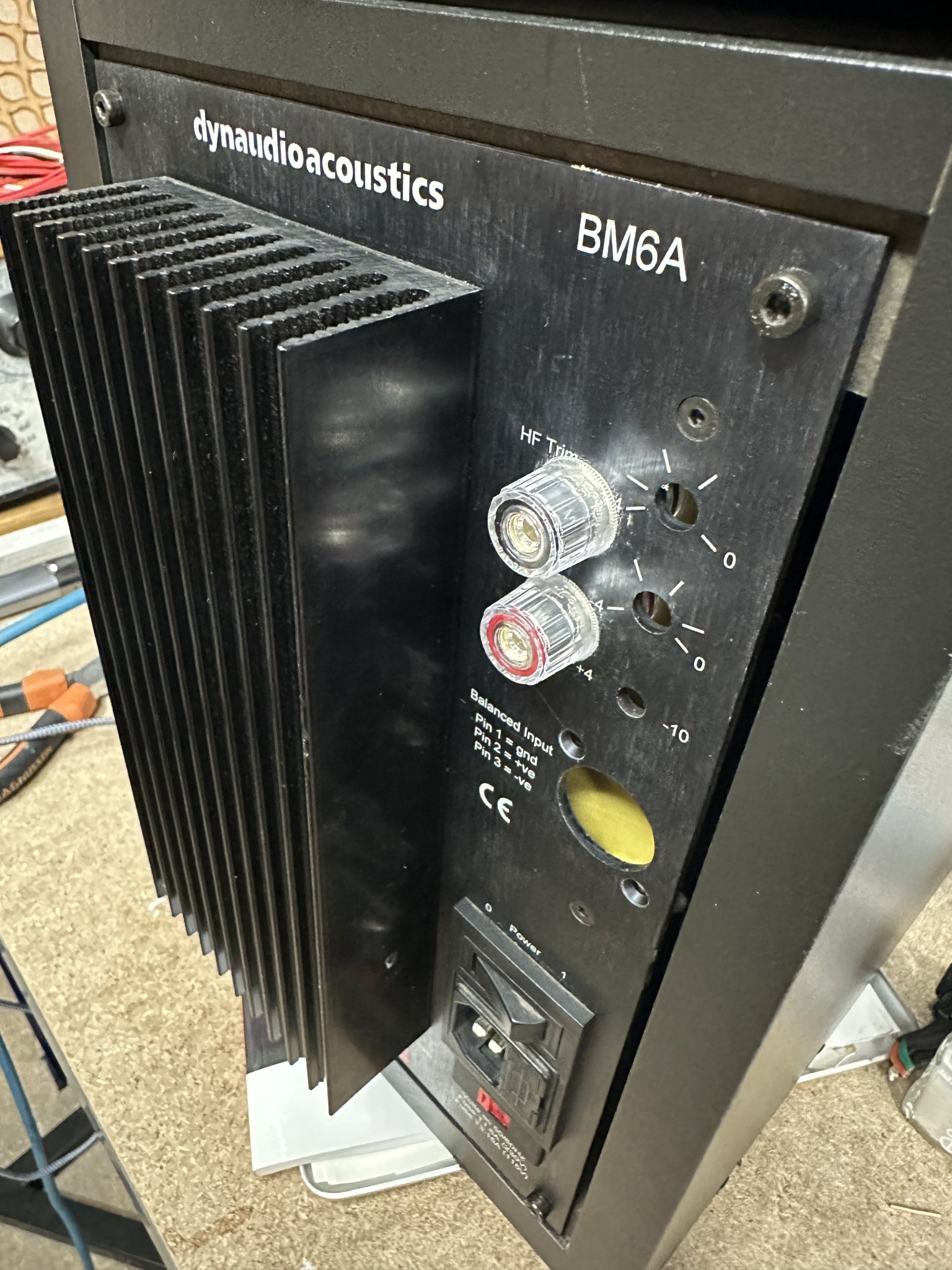

In my tests I figured out that one has to keep the back plate of the old BM6A amps with the transformers and heat sinks. Without them being physically mounted to the speaker cabinets a lot of the low-end disappears and starts to sound a loose. I guess the extra weight and screws add rigidity and some sort of dampening to the cabinets.
Here are some pictures of the finished crossovers
