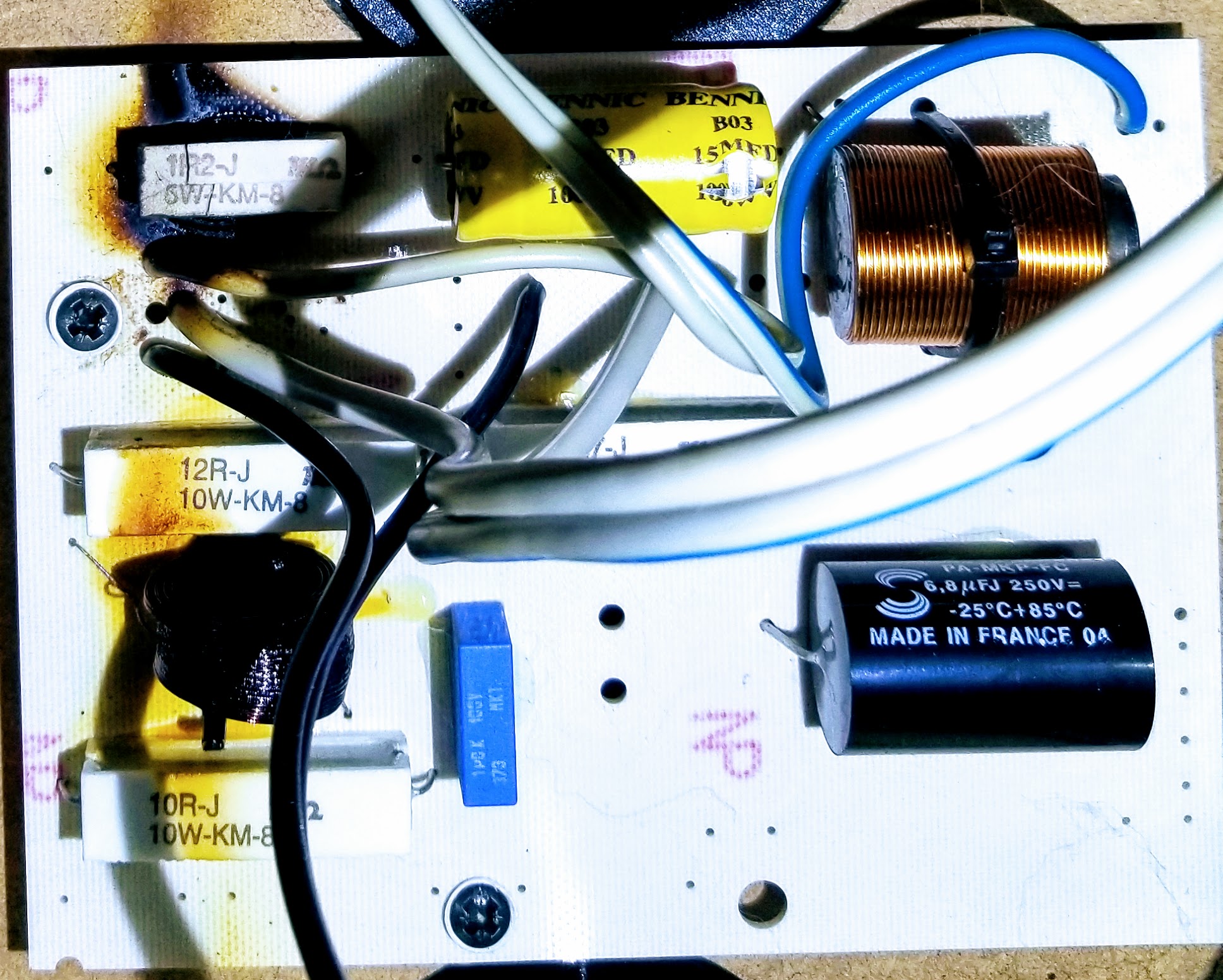

I've copied the crossover board image over to this thread for ease of reference.

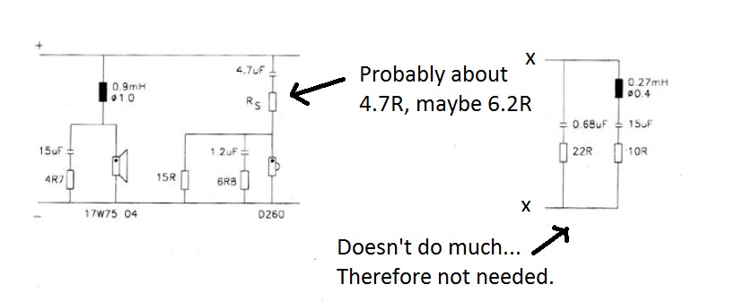

That one caught fire didn't it? Overdriven. :D
992286d1634941792-dynaudio-bm6-monitors-crossover-bm6-crossover-jpeg
4 ohm woofer it seems. Loads of ways to do it.
Lojzek came up with this;
This filter should do reasonably well for the 17W75xl-4 and D28/2.
woofer 2nd order electrical lp filter: 1mH; 15uF
tweeter 3rd order electrical with padding before x/o: 4R7; 6.8uF; 0.22mH; 10uF
Modify padding resistor to better suit your taste.
https://www.diyaudio.com/forums/multi-way/368990-dynaudio-17w75-xl-d28-2-crossover-bass-reflex-help-2.html#post6640112

That's a first order tweeter with a small 6.8R/1.2uF zobel thrown in. I would guess Rs is 4.7R. Won't be hard to build on a piece of timber. Use hot glue or zip ties and solder the joints. Might as well buy aircoils for the inductors.
The two circuits on the right won't be needed. They are for valve amps I reckon. But I'd trust Lojzek. He's good. He builds this stuff.
Use 10W resistor on the bass. 5W will probably do for the tweeter circuit. Parts Express or Madisound.

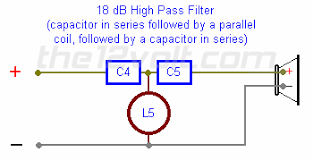

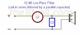

Here's a reminder of the suggested crossover as attributed to Lojzek:
Woofer 2nd order low pass filter: 1mH; 15uF
Tweeter 3rd order filter: 6.8uF; 0.22mH; 10uF (An attenuating resistor is required in front of the tweeter crossover components - suggested value 4.7 ohm)
Schematics attached.

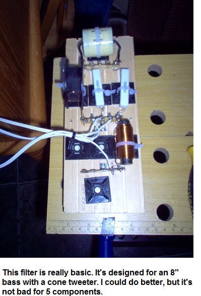

Many interesting skills were acquired in building it. Soldering, wiring and all that. Here's that Dynaudio circuit I looked at pictured below.

Below is one of my similar experiments. But really you might fit one of those larger 4 terminal biwire speaker sockets. There's more room on them for bigger circuits.
Speaker Cup, Gold Plated Bi Wire Terminals | HIFICollective
