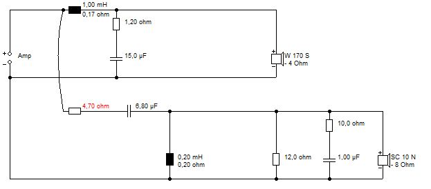

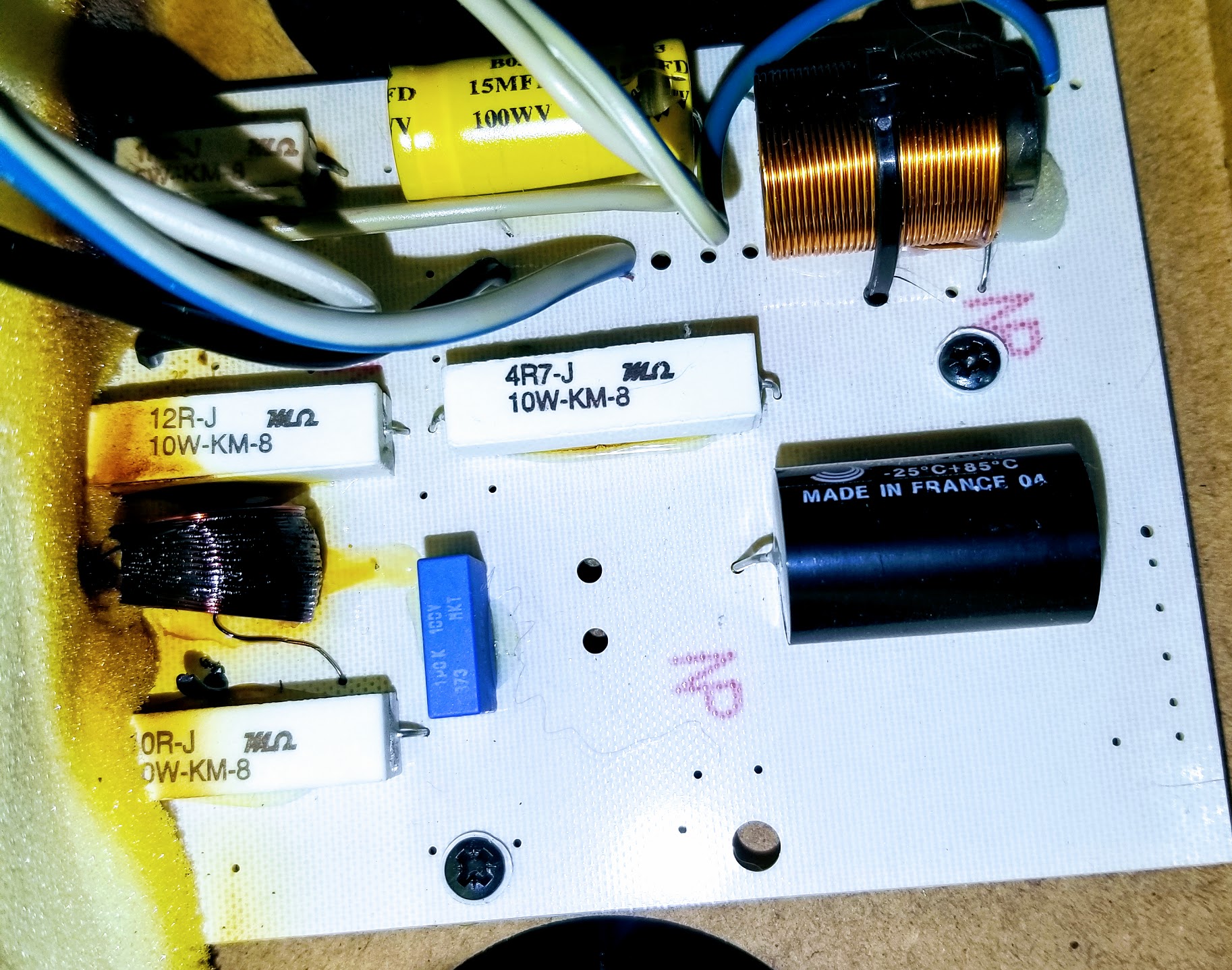

The crossover on the woofer is three components, it may result in a first order slope but it definitely isn't one component. It is closest to the one shown in #16, I've used that topology a few times. Inductor value should be in the 1-1.25mH range, you can read the rest of the values off Galu's image.
The rest of the components are for the tweeter, it doesn't look too complex. The 6.8 uF is the amplifier end, the 10 and 12 ohm are the L-pad. Which one goes where is determined by experimentation (usually the lower value is shunt). I would use a few values from 0.1 to 0.3mH for the little inductor. The 1uF cap is the 'air' cap. Usually placed in parallel with the series resistor in the L-pad.
The crossover is quite clearly a second order electrical type. The only way to get first order slopes out of that is by a very flat out-of-band (or rising) driver response.

Only that as you said, you came up with different component values and options. What would be closest to the original BM6 (passive) crossover?
I you give me a diagram and component values that would be the best fit, then I can build this easily 😉
But if the suggested design isn't close enough to true BM6 (passive), then maybe I should just go for a passive pair of monitors...

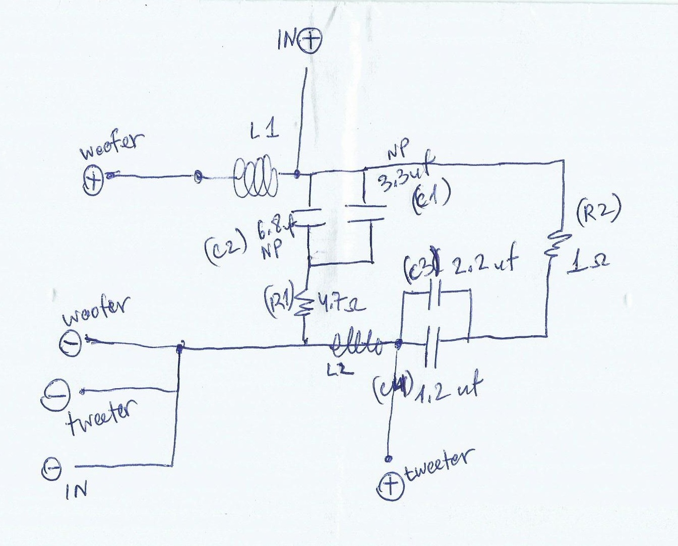

Arrange these components into a plausable Dynaudio crossover for the 17XL-4ohm bass and esowhatsit tweeter... 😕

I get something different from Sangram. 4 ohm impedance at bottom end, but looks safe enough on very rough sim.
Thanks a lot, so this last diagram should match the boards on the pictures, correct? seems easy to build!

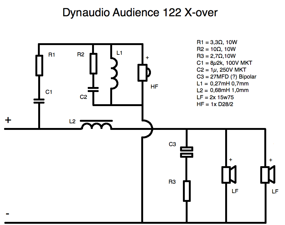

I'm not sure. The crossover looks quite different, likely designed to cross higher than a studio model. While you can get some sound out of it, it will probably not give you anything resembling a decent result.

This is the schematic of the Dynaudio Audience 122, an MMT I believe:
Here's my idea for you:
