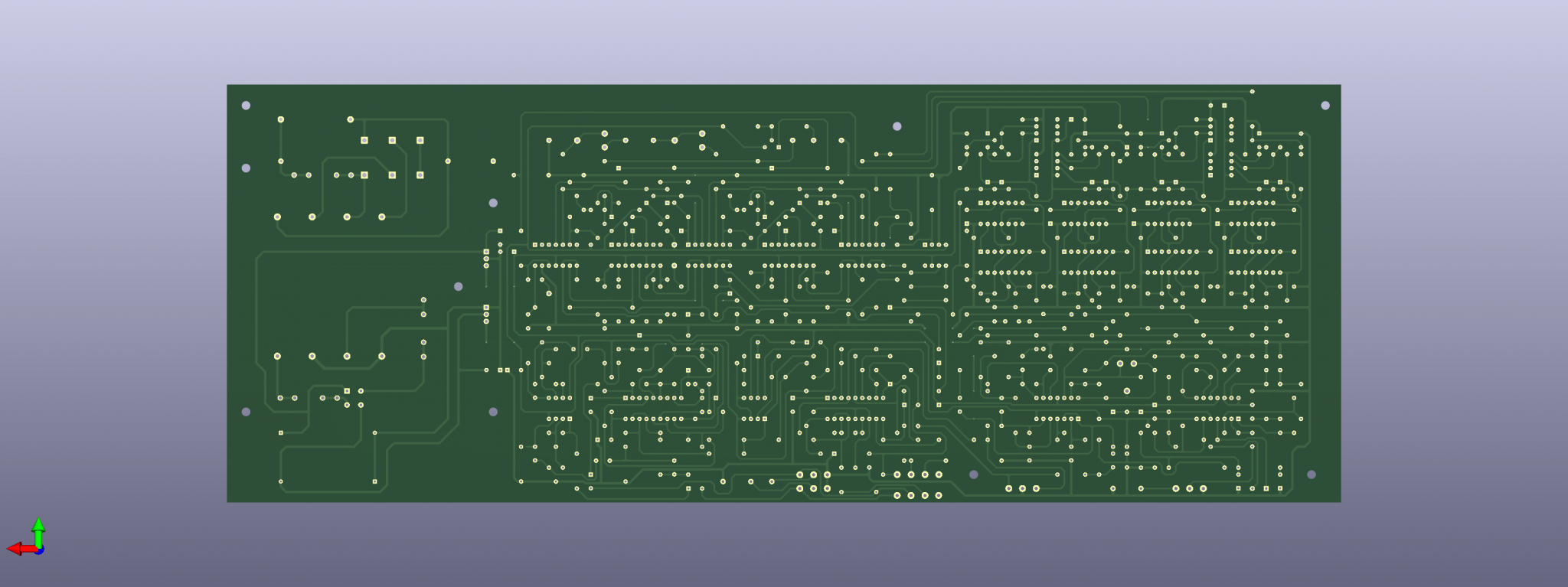

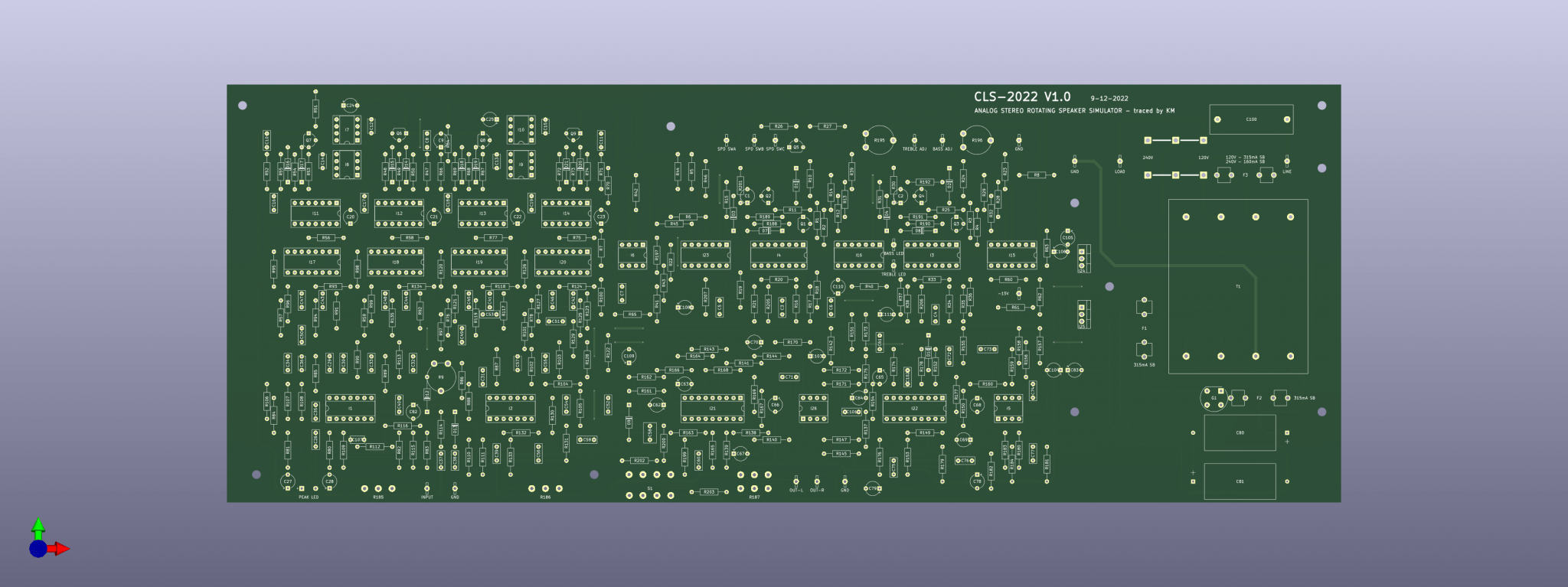

I'm going to do a replica of the CLS-22 as my base-line since it's more barebones (no relays & additional rectified supply). This is more possible thanks to the detailed photos provided on the web and also the kind fellow with an original unit who had offered to assist. Once the proto is verified I can begin working in alternatives and work on my own layout with choice of modern parts. If all goes well I'll offer PCBs for both versions.

Thank you! And yup. It's pretty close to being 1:1 against the original. Electronically it's all the same. Biggest differences are the use of modern parts where possible - all film caps have 5mm lead spacing, new power transformer, wire jumpers are now traces (it's a 2-layer board) and also smoothed out the traces avoiding 90° angles (more of a personal preference). I've also included a ground tab for proper grounding from the AC receptacle. Everything else is per the original.I'm very impressed, too ! Did you design the PCB using the original chips?

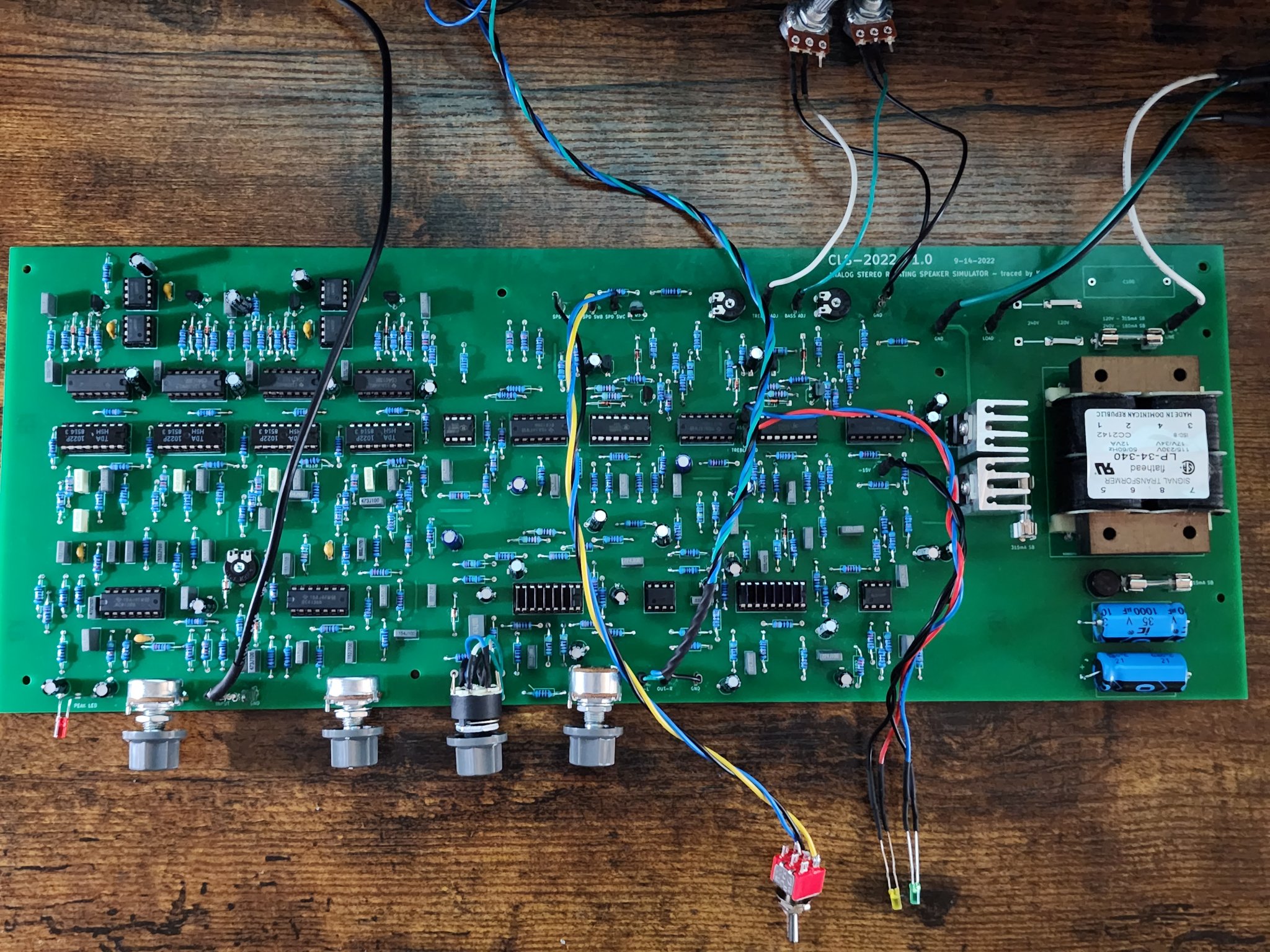

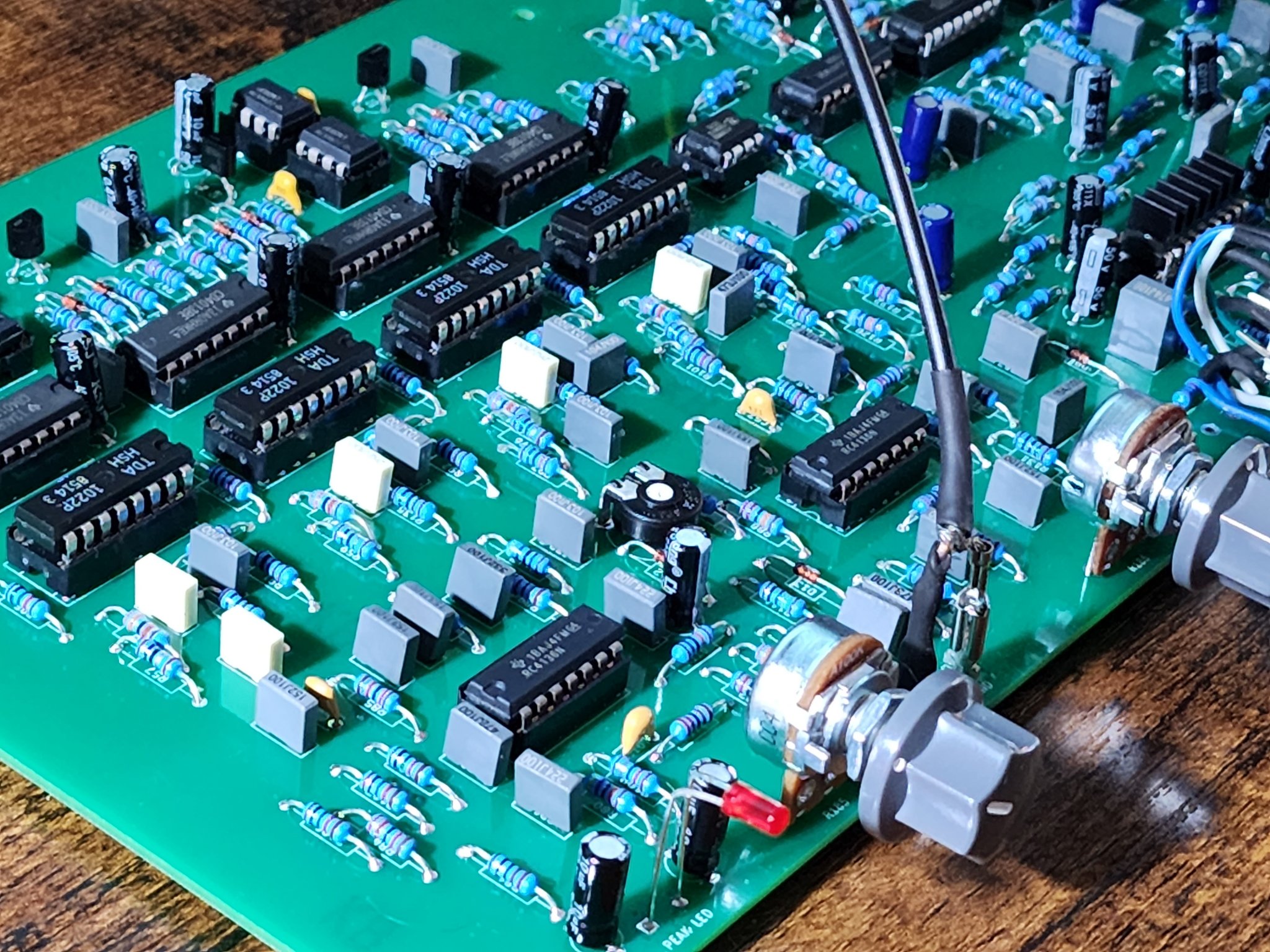

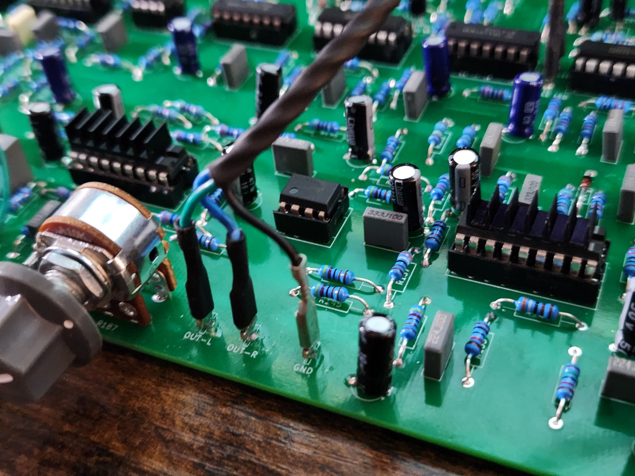

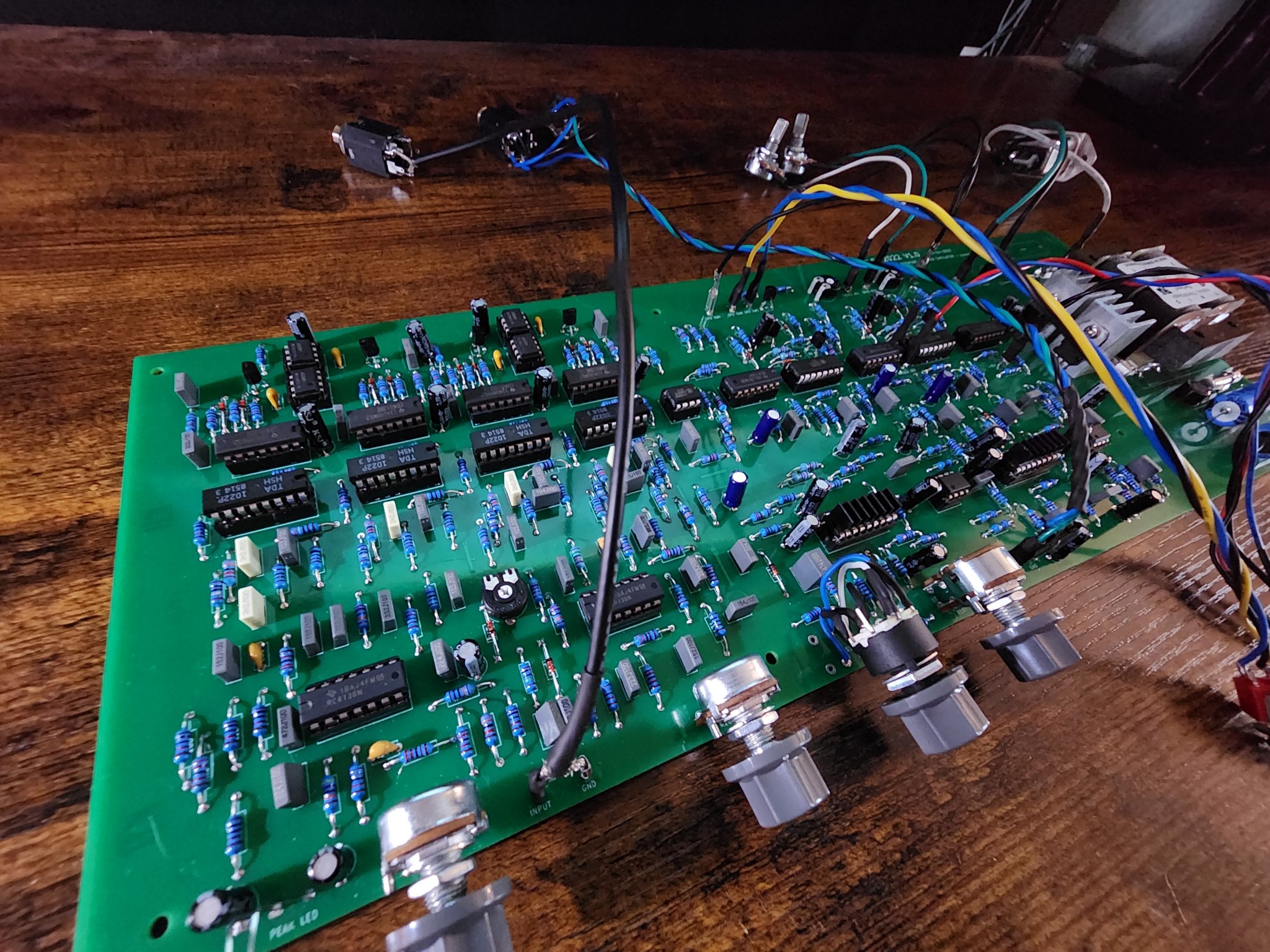

With over 350 components it sure will be a fun one to assemble. I've got an interactive build guide ready to go which will be very helpful.I must say, populating that board looks like it would be a lot of fun
PCBs and final parts were ordered yesterday. Looking like I'll have the first one tested by next weekend. Fingers crossed!
