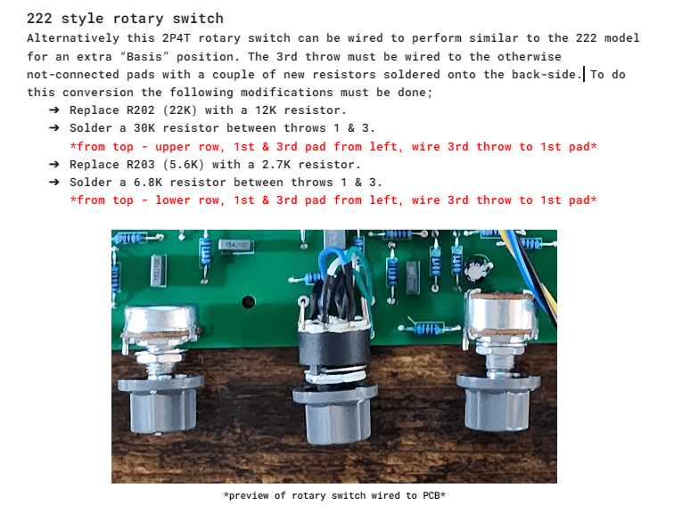

- Modifying the 22 to use a 4-throw Basis rotary switch. Since the mini rotaries I have are 4-throw I've decided to sort out the necessary mods to have it function similar to the CLS-222 with an extra Stereo option before "Super Stereo".

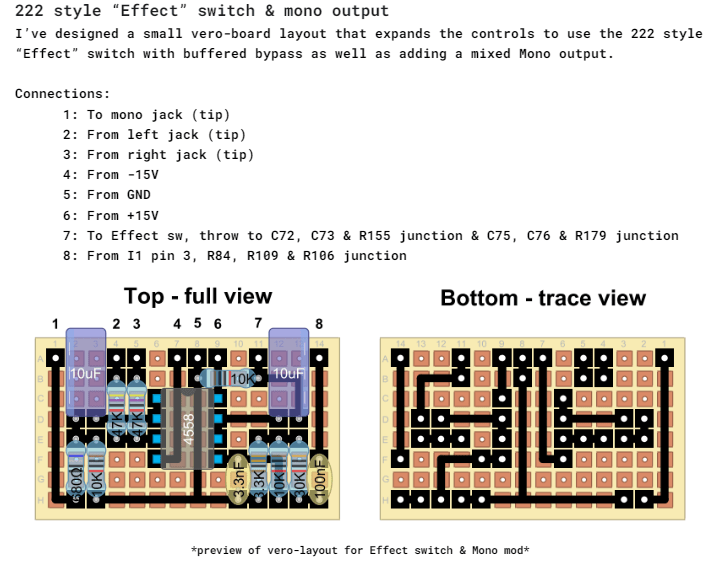

- Effect switch for buffer bypass - again like the 222. I wanted to simply snub in a true-bypass switch but isn't possible with the stereo split. So instead of working out my own buffer circuits I've simply borrowed from the 222 circuit. Right now it's on vero-board but will be included in the next revision of the PCB. This circuit uses the other half of the opamp as a buffer for mixed channels so I'll also have a mono output!

Had an afterthought to share the "mods" that I had described for the Effect switch and mixed Mono output.
Also, here's one for the rotary. I understand some folks have units with bad rotaries so a 4-throw mini can be wired and used like I had done though you'd have to widen the front-panel hole due to the wider bushing. Here's some notes on the mod to make it like the 222. While the photo was pre-mod, I wired the 3rd throw to the open pads and soldered the extra resistors on the underside.
This will all be in my final document which is more-or-less a journal of my progress. Figured I'd share these bits to help folks with original CLS-22 units.
