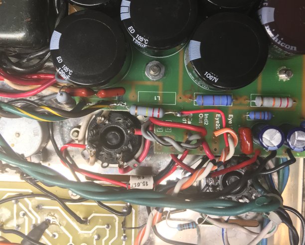

I've had the manual, The SDS board, renders it almost useless, for lead dress
with the SDS Cap board.
To change lead dress, I'd have to rotate the board 360* so all the wire connections
would come up from the bottom of board.
Leads are twisted where possible, that's supposed to cancel out noise, hum, etc, yes?

No. Twisted pair is nice but your lead dress probably not working. Lengthen the leads as necessary to get them further away from the left 7199 input stage. Use 600 v rated wire for the high voltage wires, anything for the heater wires. this may not work, but it is inexpensive.

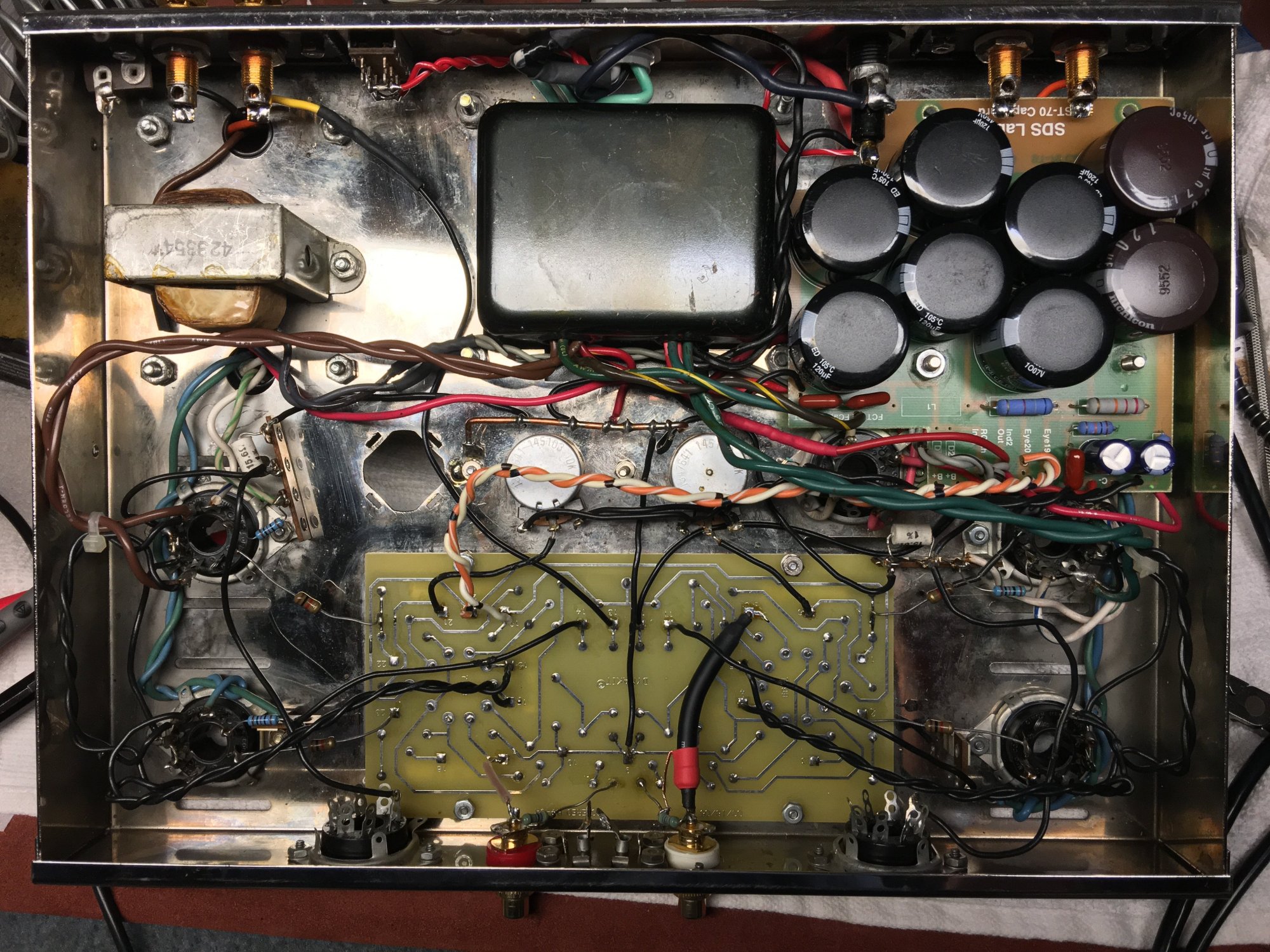

Thinking here, so bear with me please.
In Post 17 pic, I made a shorter B+ wire from
pin7 to the SDS board right where you see
two red wires form an x, almost out of pic.
Red-wht it is. You can just read RCa and Ind1 is partially covered up.There is only one ground on the
board, that is where the 47K ohm resistor and
you can just see a solid gray wire, goes to the
ground buss. I'm not sure I could twist them.

The two longest runs in the amp are the choke to SDS board
(Gry, Gry-blk) and the pink(org)-wht and wht to eyelet 20, eyelet19.
Board is post #16 graphic. It takes a bit to figure it out.
No, red wire by the choke is the positive feed for the Transformer.
one on the right channel by the choke, and the left channel goes
under the board.
Now if your talking about the two wires going to the board, pink and
white, yes I have mil spec teflon silver wire...I can make a run that would go
under the mess of wires and run it under those by the power transformer,
pass the far bias pot and run them down the eyelets 19, & 20.

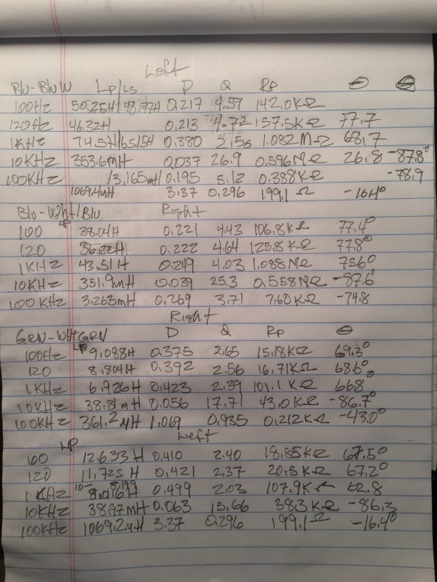

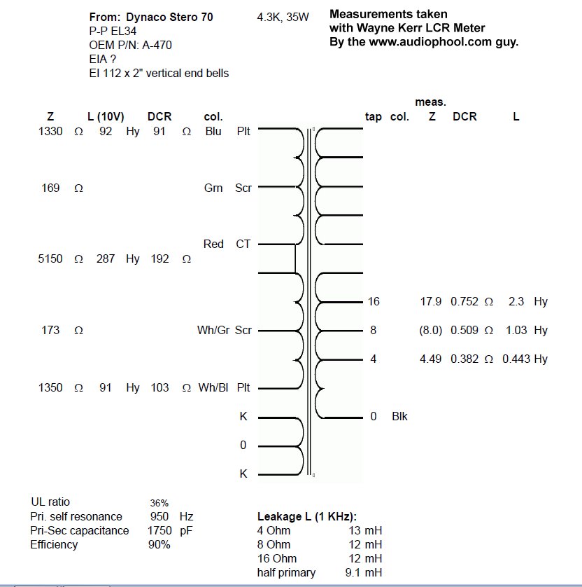

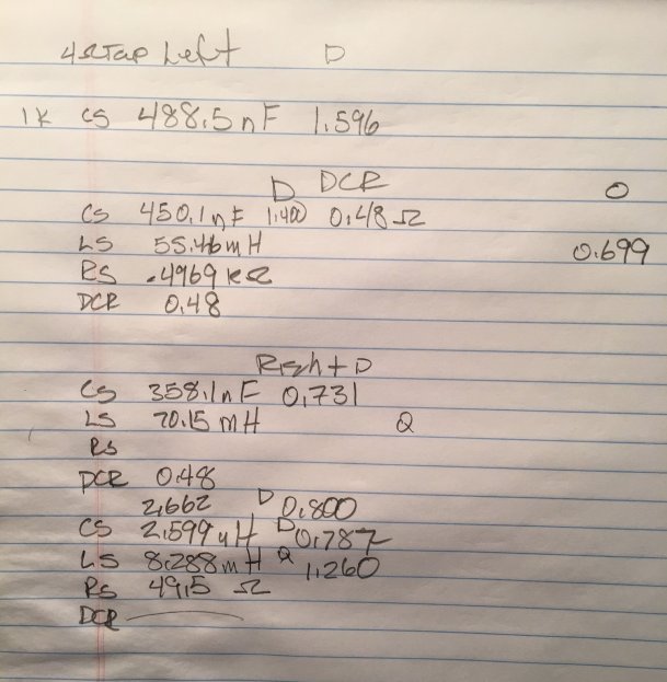

I did find this seeking out solutions, it's a good measurement
of the output Xfrmr. Then I'll post a pic of my own measurements
taken with the DER5000 LCR Meter. Not quite in the same league
as the Wayne Kerr LCR. I think the bottom two sections were the
most consistent. I didn't short the outputs. Measurements were on
the empty tube sockets.
Here, we don't need to scroll around, I think I got all the relavant
pics attached.

Hum that is 60Hz . . .
If you double the first filter capacitor in g1's negative grid bias circuit, and then the hum goes UP, instead of going down . . .
that means the hum is from the ground loop of the bias circuit.
Return the first bias filter capacitor's positive lead Directly to the Center Tap of the Power transformer's B+ secondary.
I hope that makes sense.

What I did to replace the can cap B+ was screw a cinch solder terminal strip under the can hole. Same device as you used for the negative bias diode. Then I put one 33 uf and three 22 uf 450 v electrolytic axial lead capacitors above the deck. Negative leads were out, plus leads were in center away from the steel deck. Dropping resistors were on the terminal strip under the deck. If you did this you could take out the SDS board and put the wiring back to original locations, which works hum free.
Distance of wiring carrying 60 hz currents away from driver board pin 7 (input) is your friend when suppressing hum. Wires carrying 60 hz currents should be 90 degrees from high impedance signal wires like input jack to circuit board pin 7. If power & high impedance wires must cross, such cross should be at 90 deg and only at one point. Dynaco followed these rules.

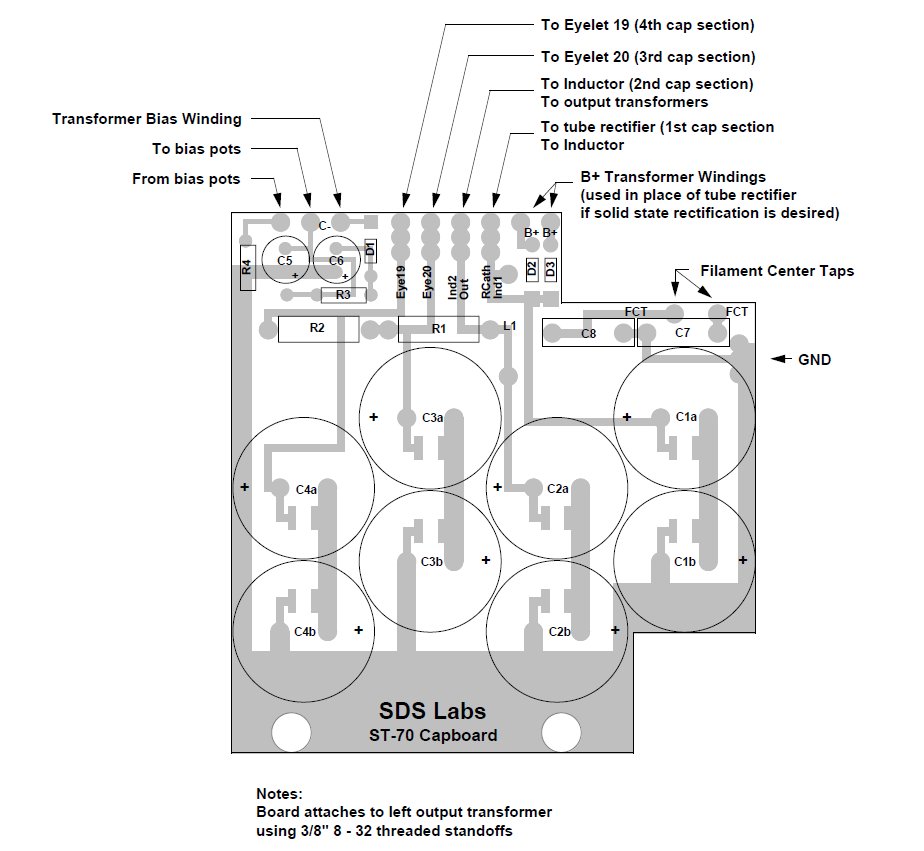

6A3 - Double up the first bias cap?
So when I look as the SDS Capboard layout,
the first Bias cap is there at C6. Currently 100UF,
so I'll change that to 200uf and if the hum goes up,
it's the ground loop in the bias circuit.
I understand what you are saying there.
To do that properly, I just cut the trace on the board,
between POS of C6, C5, then add a wire going to
the B+ Center Tap Secondary.
I almost said it doesn't have one, As I'm looking at the
output transformer diagram above. If I recall that is the
Red-Yel wire on my ground bus. Run the new wire there.
only if hum level increases.
indianojo - I was confused at first, but I think the 480uf load you mentioned
is incorrect, for the following reason, the capacitors are in series. The void between
the pads are for load sharing/droping resistors they are 330K SMDs each,
Max for a good 5AR4 is supposed to be around 58uf? In this case
the two 120uf cap are in series so 120uf/2 = 60uf.

Tony - Unsure of doing the twist the ground and B+ together.
IF I did, I'd have to route the B+ behind the socket and bring
the ground wire over to it, twisting them where I can, then
running the ground to the tube socket, then letting the ground run free
and solder it to the ground buss.

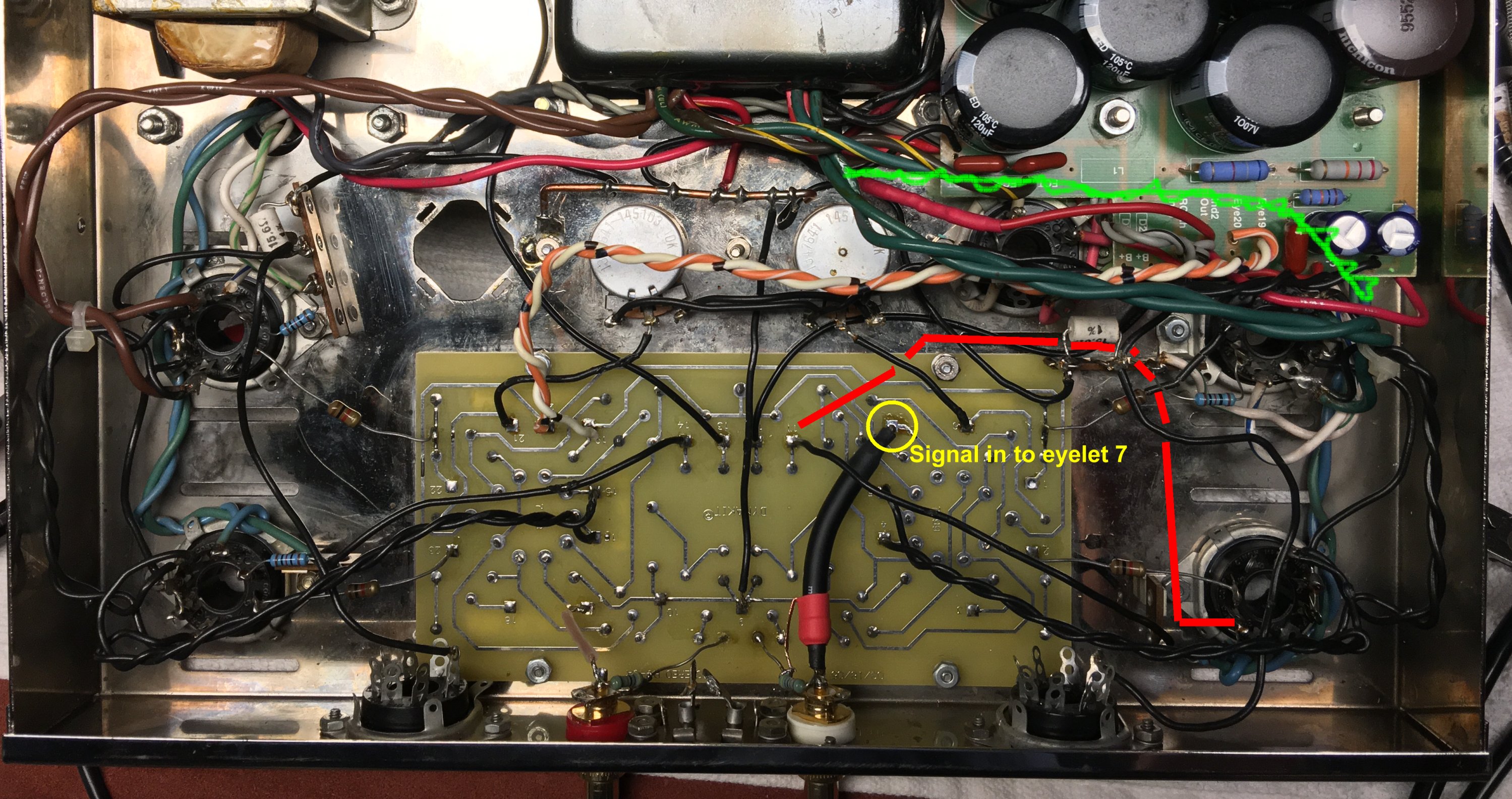

Let me post a clarifying pic of it.
In the pic, signal is to eyelet 7.
The wire from tube socket pin 4 crosses at 90*.
The dress in the manual for that wire is shown in red.
Then the top green wires drawn on the pic are how maybe
I could route those wires under the board.
Parallel to the black wire across the this signal wire are two heater wires.
In the Dynaco manual they run along the bottom of the board until the
power take off socket then gently curve up to eyelets 4 and 5.
Then for each of the el-34 pin 4 socket to the board, are installed
100 ohm resistors. To lift?
Looking at the black wire that goes back to the tube socket in the
lower right, it actually connects to the tag board, then a 100 ohm resistor
to tube socket pin 4. Circled in light blue.
Look at the other sockets, I've circled them in light blue also.
So is this lifting the circuits to try and prevent ground hum?
Which might have started when whomever did the mods and
installed the SDS board?

Are you output transformer common taps grounded? I don't see that in the picture. Did you determine the 2 transformers have different measurements? That got lost in the shuffle.
The extra 100 ohm resistors on the power tube screens are for screen stability I expect. A reasonable mod. What I'm uncertain of is if the screen feedback wires should connect to the tube side or transformer side of that resistor. I suspect tube side, or doesn't matter.
I would be tempted to "divide and conquer" at this point, at least as a first step determine if the problem is in the output stage/transformer versus the driver by somehow feeding the output tubes 0 AC signal.
480 uf load on a 5AR4 seriously exceeds the maximum capacitance rating. Eventually it will arc across & burn. 5AR4 are $18 plus $12 freight last time I bought one. People that keep the 5AR4 but want 480 uf capacitance back up the diode action of the 5AR4 with silicon diodes. Thus the 5AR4 provides slow turn on to not hammer the signal tubes with B+ when cold. The silicon diodes do the rectification.
Silver wire versus copper wire doesn't matter at audio frequencies. What matters to 450 v currents is that the label on the wire reel says it is rated for 600 v.
It appears that the original ground point of the Stereo 70 was directly to the right of the multisection aluminum can electrolytic capacitor that was removed. If the can cap is bad, take it apart and avoid breaking the lugs on the can and the lugs on the phenolic. Then clean the aluminum can down to the bare shell, digging out everything. (Avoid getting the electrolyte paste on you..) Then wire (using insulating tubing) new capacitors inside the can, restore the positive (and negarive) connections on the phenolic as marked, reassemble and reinstall. This also makes the amp look original...and the ground point is preserved... New 40 or 80 uF 450 volt caps are a LOT smaller than those of 60 years ago. There should even be room to connect 100k 1 w equalizing resistors across the HV caps in series... Two 80 uF 450 v caps in series will give 40 uF with plenty of voltage headroom... Arrange the parts judiciously to fit in the can, preassemble, insulate all leads, and cover the assembly with heat shrink or other suitable insulation before placement in the can and reinstalling the phenolic.

For B+ and Bias, they have one common element, the first filter capacitors (B+ cap negative lead; Bias cap positive lead) they need to connect directly to the power transformer's secondary Center Tap. That forms a Local Ground Loop. The transient 120Hz and transient 60Hz currents (respectively) are contained locally.
Then, after containing the local loop, connect to those first B+ and bias caps (-, plus respectively) to the next capacitors in those filters; before you connect that to a central ground point.
The idea is that the transient currents are Largest there in that local loop, and have the most harmonic content of any place in the amplifier, but that by isolating those currents into a local loop, before connecting to the rest of the circuit will reduce hum and hum harmonics to the rest of the circuit.
Putting those currents onto a 'Bus' wire will inject the really small voltage drop across the Bus wire, and inject them into the most sensitive parts of the amplifier . . . the high gain input pentode for example. The negative feedback does not know if that hum and upper harmonics is the desired signal, or whether it is actually un-desired hum and upper harmonics.
They are connected to eyelets 12 & 13
per Dynaco wiring diagram. But now I'm wondering if I did it correctly.
Common is the black at output pin 4 on each side. They both connect
to the ground buss, that is where the original ground lug was.
From what I could surmize, I thought they were pretty close. However, I didn't short the speaker
terminals...common and 8 ohm taps.
Either way 100 ohm isn't much
screen protection. I forget what might be better, I want to say
1500 Ohms off the top of my head.
What would I look for, feeding the output tubes zero AC signal?
Once I remove the 7199s, there isn't any more hum. Maybe it's
a combination of lead dress, ground loop, that eyelet 11 to EL34 (V3) Socket pin 4 lead dress?
How best to device and conquer?
1. Verify grounds for both speaker pin 4 black to center ground buss.
2. verifie Red-yel B+ CT does connect to ground buss.
3. verify New gray SDS ground does connect next to Red-yel B+ CT, confirmed in pics.
4. check doubling 1st bias diode cap and see if hum increases or decreases?
5. While board it up, slide the two green heater wires to right beside the
power transformer next to the SDS board edge, around the 5AR4 socket.
6. Then if those don't work solder in a new longer wire to eyelet 11 and route it around the boards edge to EL34 (V3) socket though 100 ohm to pin 4.
7. I could always shorten the ground buss wire, not sure that would have any effect though.
Okay, any thoughts to plan?
The connections to eyelets 12 & 13 should be the feedback line from the 16 ohm outputs. Then you need a connection to the ground bus from the common taps. I'm not sure what you're referring to by "output pin 4". Have you confirmed the transformer grounding with a meter?
I got the screen resistor info here:
Techniques To Maximize Power Tube Life
and 100 ohm is recommended.
That sounds like the simplest way (removing 7199) so I'd say that indicates the hum is being picked up in the driver circuit. Although if the output transformer is ungrounded, that's still suspect. Next I would want to test that there isn't some issue with the fat input cable. Only thing I can think of is replace it with a plain wire or a twisted pair, grounded at one end.
I'm thinking the power supply board and bias can be considered good until evidence shows otherwise, this has been a popular board for many years, we would have heard of problems if there were any, and problems there would probably affect both channels.
I'd want to confirm the transformer grounding, look at the fat input cable, then consider lead dress issues. You could also try lifting the 2 feedback lines in the problem channel as a simplification of the circuit and see if the hum stays or goes.
Tony - your ground buss is insulated from the chassis? How does that work?
Is that just a lifted circuit ground? What about the other grounds?\
it is, but one side can connect to chassis metal, i also use plastic casings....
this ground buss is where all wires that needed to be zero volts are connected...
i thought i answered you earlier, it seemed i forgot to click post...
A couple more ideas: It's hard to tell from the picture, but are the heater twisted pairs pulled up and away from the board? Maybe try moving them around a little. Also have you checked the soldering on the 7199 pins? Pin 7 (input grid) on the left channel looks a little funny.
JGF - The eyelet #7 is indeed soldered well on the board.
I used shielded mic cable to see if it would help the hum,
being fully shielded and grounded at the input Jack.
Some of heater twisted pair are up some from the board.
There isn't much room for movement.
I'd have to lengthen them to move them.
Eyelets 12, 13, to the7199 board just lift them and go?
No danger to power tubes?
I thinkg I got most of what I need to do now.
Let me digest it all. I put the important stuff in
a word document so I can read it while working
on the amp.
I'll get to some later this morning
and of course putting up Christmas Stuff outside the house too, while it still
warm, not hot nor cold.
Some good stuff here....
