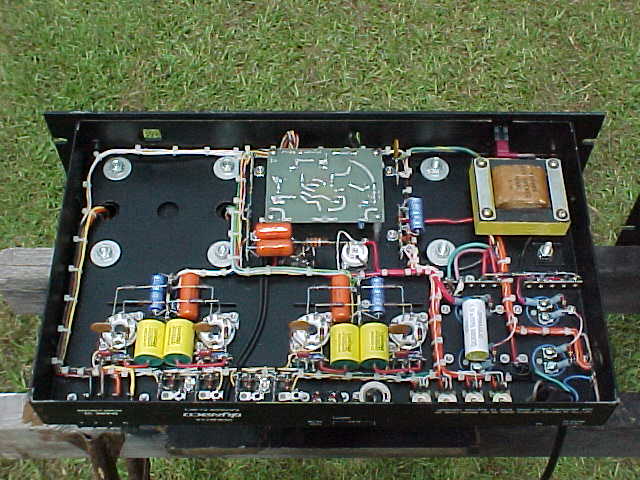

In my opinion this restoration is superior. Carver seems to have eschewed separate bias controls by keeping the original one-for-two scheme. And whether penthode operation over ultra linear sounds, or is, better is very, very debatable. Also, I have those Dynaco 451 output transformers and can tell you that they aren't that great. I have swept them at low power and their bandpass drops like a stone after 25KHz. :no:

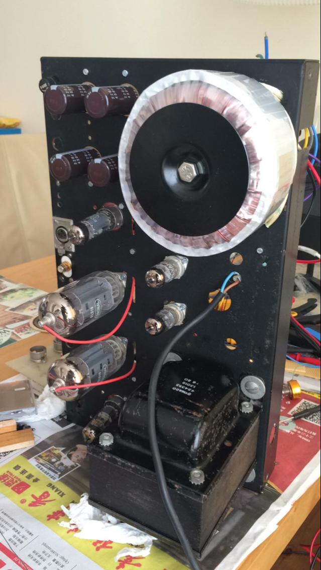

You could add a mosfet follower to drive the 6550. This will give you more swing as the 7199 now sees an easy load. In my case i used some beefy output tubes (in triode mode to match the transformer impedance) and a cathode follower driver (also output tubes) to drive the output tubes hard. Input is balanced cascode with current source. So the amp has a symmetrical input if so required. Local feedback loops only to keep the dc balance of the output tubes under full load.
Dynaco VI revisited
Some forty years ago I purchased three second hand Mark VI in a bad state.
I dismantled them, throw away the blown 8417 tubes (melted glass!) and redesigned a whole amp. New components apart from transformers.
I used 4 x 6550A (GE) with G1 resistors 270 K! Driver+input E88CC and 5687cascade as LTPairs(CCS: 2SK369V) and output tubes with cathode feedback from O/P transformer secondary. Bias 33 mA per tube. No global feedback! All supply voltages regulated apart from HV to output tubes.
These amps have given me great pleasure without any failure or problems. A couple of years ago I had to put new output tubes while the old GE ones couldn't any more. I put in one amp 4 chinese made 6550's and in another amp Russian 6550WE's without modifying anything in the circuits and just readjust the bias to all the output tubes. The amps have continued to work exactly as before with the GE tubes ( forty years ago I was able to purchase GE's - these are long gone now). I dug in my files and found the results of measurements :
124W output max (350V screen V) and superb frequency figures: 15Hz(-3dB)
from 25HZ to 50 kHz linear , 60 kHz -1dB and 80 kHz -3dB.
