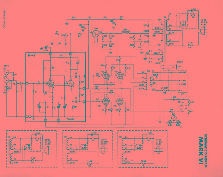

For anyone that has these amps and is interested in modifying them I have a schematic given to me by Bob Carver himself. If anyone is interested post a request here. I'll have to contact Bob to make sure its alright to share the schematic but I don't think he'll mind.
Because my friend, who owns two such amplifiers has already bought a set of 6550WE tubes. I need to make a meaningful conversion. Thanks for showing interest. I thought no one would answer anymore.

Is the dynaco 7199 stage not able to swing the voltage needed ?

There is a problem if you replace either 8417 or KT88 tubes; with 6550 tubes:
Fixed Bias (like this amp is?). Right?
KT88 maximum g1 resistor 220k for < 35Watt plate + screen dissipation,
100k for >/= 35 Watt plate + screen dissipation.
(fixed bias).
8417 maximum g1 resistor 100k (fixed bias).
6550 maximum g1 resistor 50k (fixed bias).
50k 6550 loads the 7199 circuit; more than 8417 100k, and more than KT88 220k / 100k.

You could add a mosfet follower to drive the 6550. This will give you more swing as the 7199 now sees an easy load. In my case i used some beefy output tubes (in triode mode to match the transformer impedance) and a cathode follower driver (also output tubes) to drive the output tubes hard. Input is balanced cascode with current source. So the amp has a symmetrical input if so required. Local feedback loops only to keep the dc balance of the output tubes under full load.

I used 4 x 6550A (GE) with G1 resistors 270 K! Driver+input E88CC and 5687cascade as LTPairs(CCS: 2SK369V) and output tubes with cathode feedback from O/P transformer secondary. Bias 33 mA per tube. No global feedback! All supply voltages regulated apart from HV to output tubes.
These amps have given me great pleasure without any failure or problems. A couple of years ago I had to put new output tubes while the old GE ones couldn't any more. I put in one amp 4 chinese made 6550's and in another amp Russian 6550WE's without modifying anything in the circuits and just readjust the bias to all the output tubes. The amps have continued to work exactly as before with the GE tubes ( forty years ago I was able to purchase GE's - these are long gone now). I dug in my files and found the results of measurements :
124W output max (350V screen V) and superb frequency figures: 15Hz(-3dB)
from 25HZ to 50 kHz linear , 60 kHz -1dB and 80 kHz -3dB.
