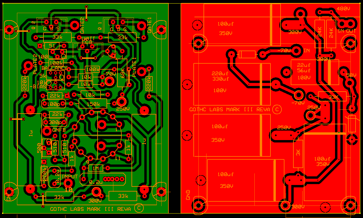

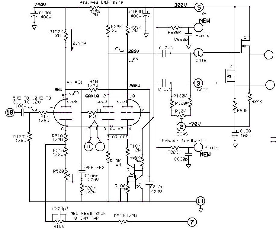

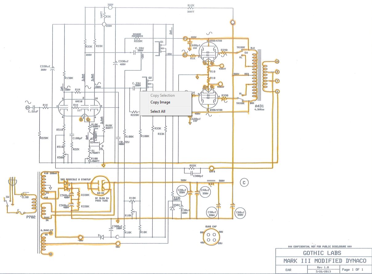

Compactron MrkIII PCB Design
I did the following design concept for someone per their expressed request and then they did not want it. Compactron tripple triode for a gain stage and then LTP with CCS and MosFet followers for screen drivers. I've used this topology on other amps with great success. I used all the design features that I've tried including plate-grid feedback aka Schade for the output tubes.
This PCB design has a power supply bypass PCB with bias voltages that piggybacks the main PCB to simplify the chassis wiring. Designed around parts available from Newark. 6AC10 or 6AK10 would be the best driver tubes.
