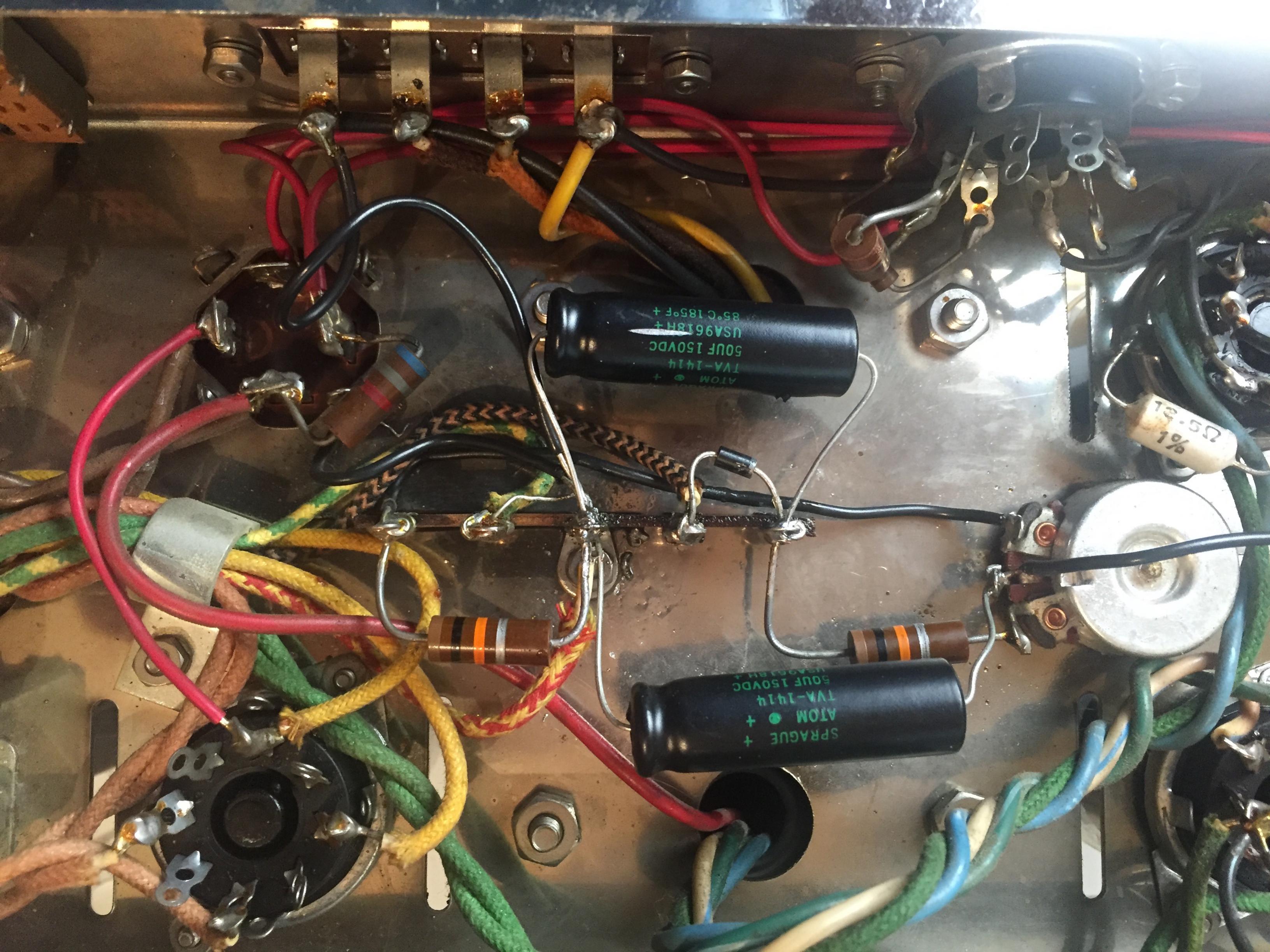

Here is a picture of how I wired the two capacitors and the diode.
Did I make a mistake on the diode polarity?

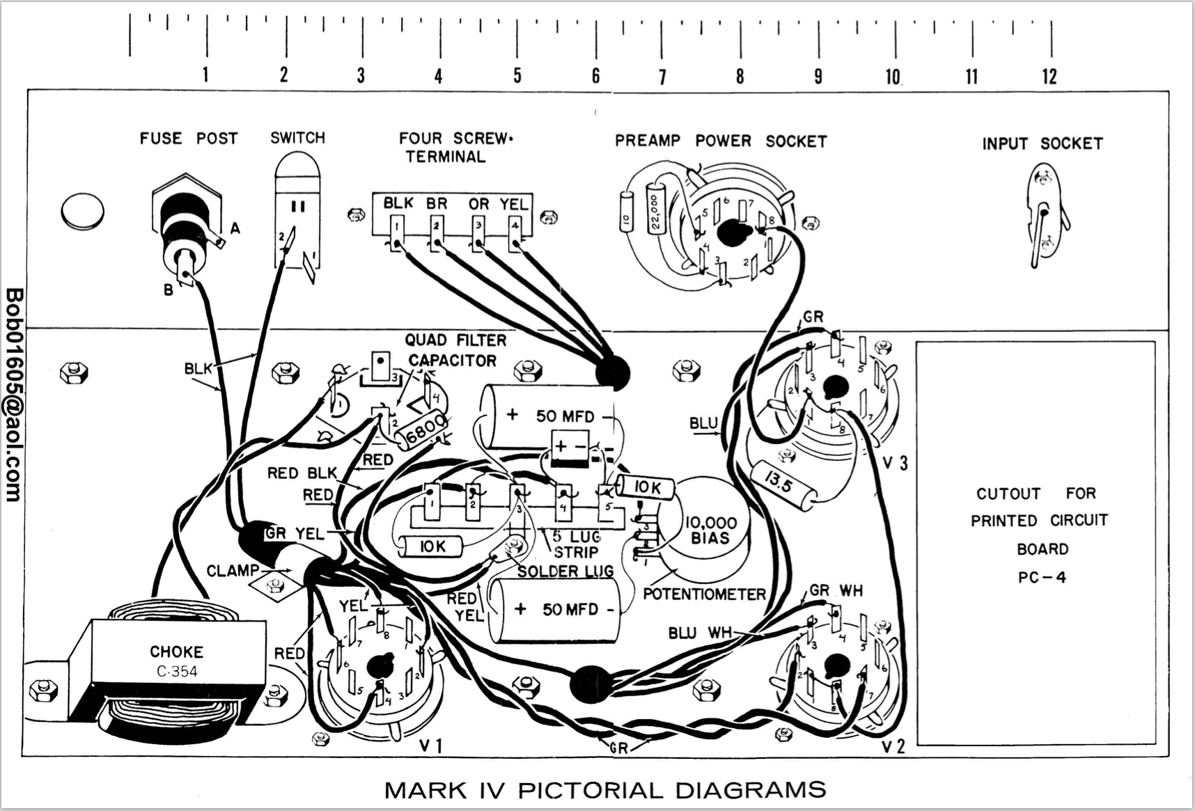

Attached is a diagram from the Dynaco manual. For that square box in the middle (selenium rectifier), negative polarity is toward the bias potentiometer.
So I did place the part with the gray line of the diode (is it negative, right?) toward the bias potentiometer.
Sounds like the diode was wired backwards. Make sure that the banded end of the diode
connects to the red/black transformer lead. Definitely replace both bias capacitors now also.
It's best not to think of the diode terminals as +/- but instead remember that current will flow
through the diode only if the banded end is at a more negative voltage than the unbanded end.
As a rule of thumb, if you want a positive DC voltage, take current from the banded diode end.
If you want a negative DC voltage, take current from the unbanded diode end, which is what
we want for the negative grid bias supply here.

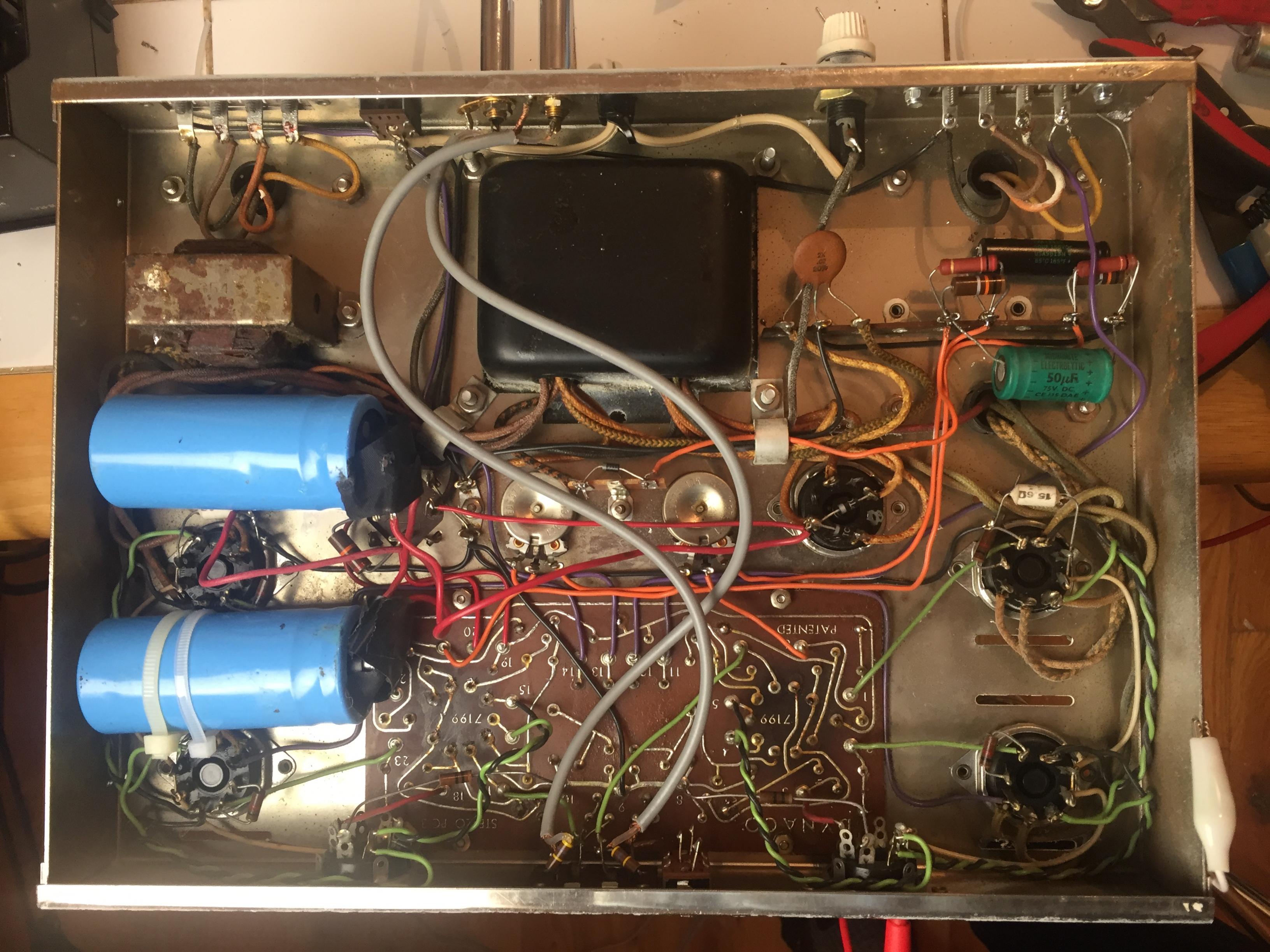

I am attaching a picture of the Stereo 70 with the replaced rectifier. I will also replace the two bias filter cap, which currently are 50uf, with some 100uf, which I will buy.
As last question, I found this Stereo 70 with two extra 100uf capacitors, which the previous owner connected somehow to the multi cap filter.
What is this practice for? What was he trying to achieve?

Don't allow such high bias readings, since these reflect way too much current in the output tubes.
First try only a 10k in parallel with the resistor connected to the diode, and remove the other extra
resistor across the other 10k. Then you have: diode, 5k, and 10k to ground. This will give you more
negative voltage, to reduce the output current. Give that a try. We may have to readjust again
somewhat, but this should work.
Be careful not to turn up the Variac above 120V. Some Variacs can boost the mains
by 15%, up to 138V. That would probably do damage.
When replacing the bias caps, use at least 50uF each, but make sure that the voltage
rating is at least 100V.
The extra 100uF caps on the main filter supply do help filtering, but will strain the
rectifier tube. I'd remove the one connected directly to the rectifier tube, before
the choke. The one after the choke can stay.

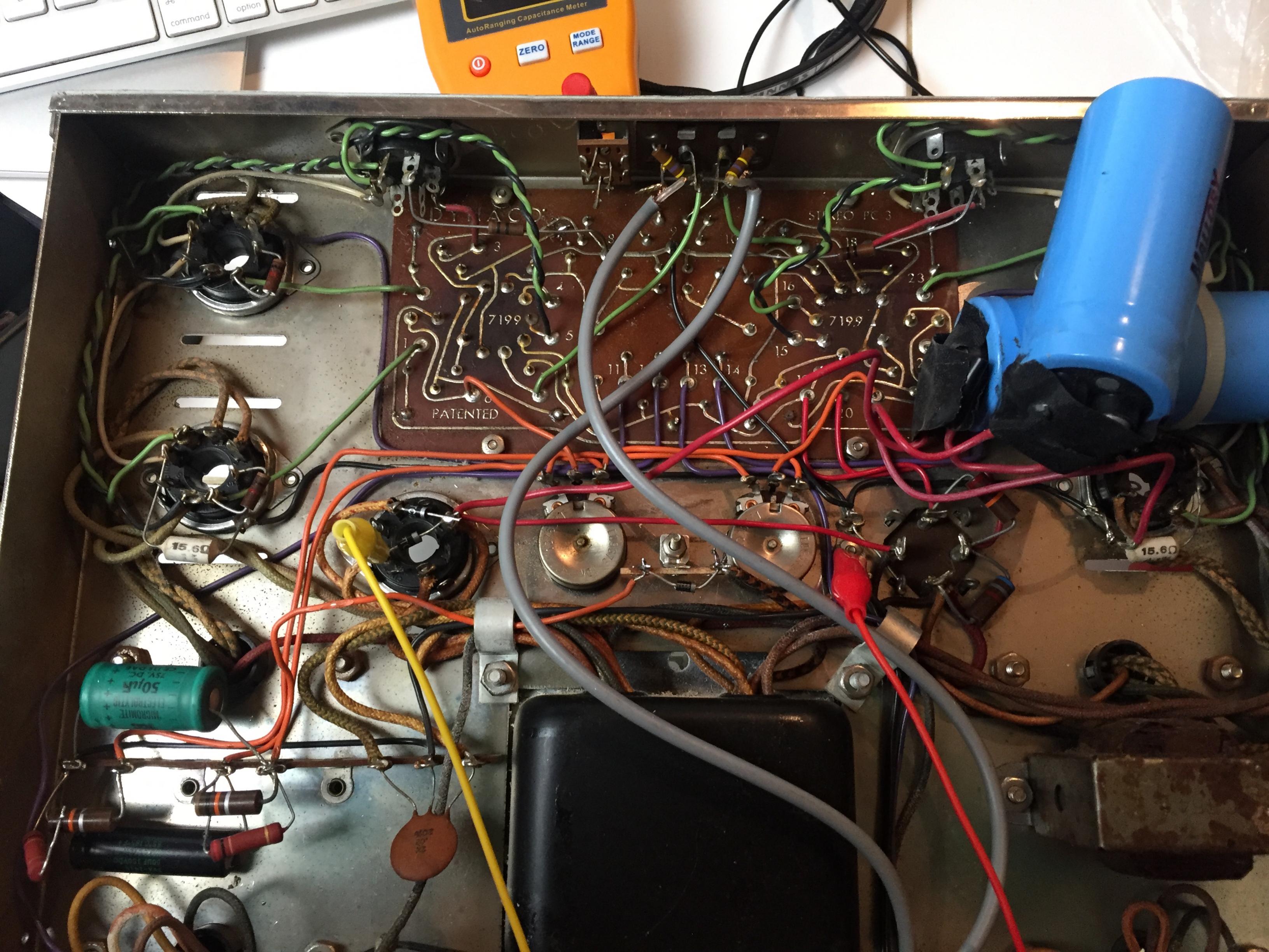

Here is a close up photo of the extra capacitors and something looking like two diodes I found on the base of the rectifier tube. Not sure why the previous owner did add those (together with the extra two blue capacitors).
Looks like the 2 added silicon diodes are in parallel with the tube rectifier sections,
so the B+ will be significantly higher than it should be. Try removing those 2 diodes
(just cut them off). Then the bias current will be less for a given negative grid bias.
This may not be all of your problem, though.
If one of the added B+ capacitors is in parallel with the first can capacitor section
(the one that is connected to the rectifier tube), you'll need to remove that capacitor,
because more than about 50uF there can stress the tube rectifier. In other words,
just go back to the stock Dyna circuit power supply.
