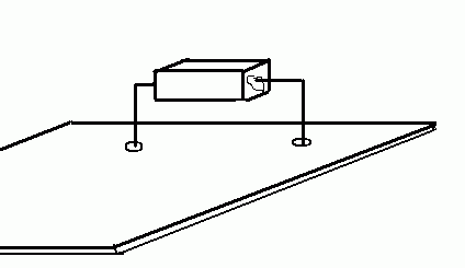

10K resistance, the one marked 2 watts....good idea to increase to 3 watts, or to replace by two 22K units, 2watts each one, installed in parallel.
Nico found it very hot.....hummmm... maybe he has too much sensitive fingers.
There's 1.7 watts there..... well.... bigger will work cool.
Of course, one single unit is prefered not to make mess...but do whatever you want...the sound will remain very good.

lol firstyou say my finger is sensitive, then when I back up the temperature with a graph from a resistor datasheet...
Ahahah.... relax man...too much worries will make you older than i am
I am kidding, having fun.... this is not important.... i feel as funny someone worrying with such a small detail.
The resistance is not into the audio chain, it is very auxiliary...so...hot, not hot, noisy, well calculated or not..will not disturb our main focus.... sound quality.
Fine!...you finger is good... resistant is hot...so folks, use bigger ones.

I am not concerned by the audiability of the heat... only long term reliability of the amp... the temperature under my finger told me the 2W resistor was not going to have a long happy life... The datasheet just confirmed it.
So there you have it, use 3 to 5W and don't burn your houses down. 😀

R16 the 10k one should be no less than 3W, I am in fact going to change mine to 5 or 8W, putting the resistor under the board.
You guys have the disspation amounts and the tables to see the temperatures, now it is up to you to decide what level of temperature on a component you feel happy with.
