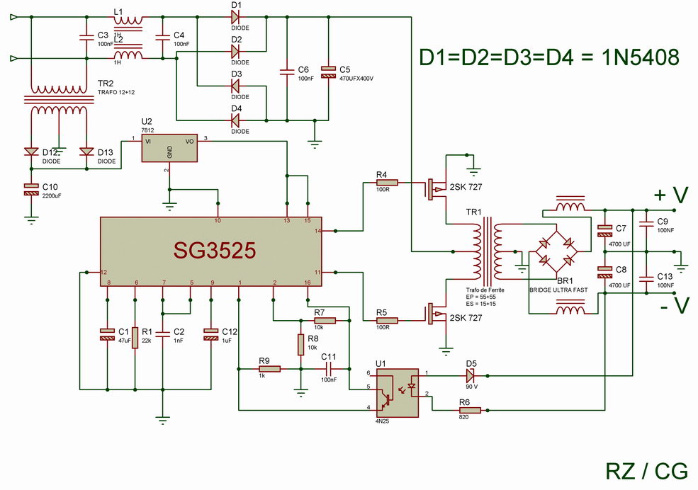

Hi Carlos,
Some comments on that SMPS (switchmode power supply).
First, 78XX regulators always need 100nF disc ceramic capacitor between input and ground. Then 1uF...100uF (I prefer 10uF) electrolityc (tantalum is better) is needed between the regulators output and ground.
Same for the PWM-IC (pulse width modulator IC): between supply (pin 13, 15) and ground bypass capacitor is needed. I found that 1uF-50V polyester capacitor is the best here. Without these capacitors the regulator circuit would oscillating.
Supply bypassing is very, I say very important in switch-mode power supplies!
Anyway nice simple circuit, I like it. On the margin I'd choose some better MOS-FET driving circuit, and some overcurrent/short-circuit sensing circuit would be a good idea. Don't forget to use a serial mains fuse!
Maybe you will need some snubber circuit over the transformer, it clears up after posting some o'scope measurement pictures.

Good advises, thank you... will follow your instructions
All them make a lot of sense to me.
Will be done the way you told.
Thank you very much..... circuit not mine, a friend have provided and said it is very simple....ahahahaha.... maybe because needing some more components.
