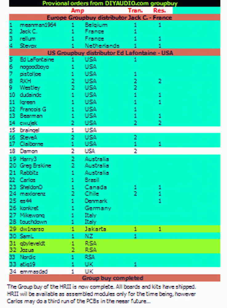

Sorry folks... post 922 is a mistake
The list you can see there was for the HRII.
regards,
Carlos
