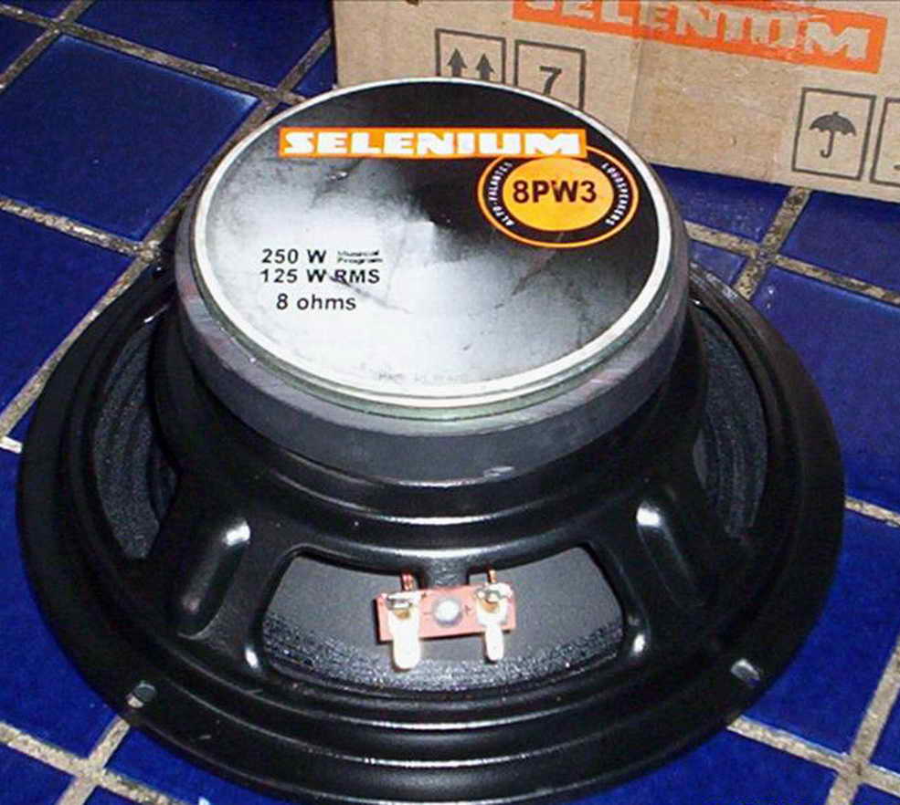

Picture is a very popular speaker, used into automobiles, to powerholic folks, Selenium is the brand, and those ones cost to me was only 40 dollares by two.... they bougth wrong...they bougth 8 ohms when powerholics wants 4 ohms... this have happened into my automobile repair place... a bargain to me. (half the price)
Carlos

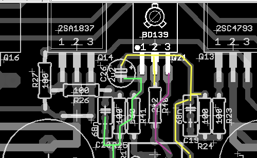

Hi Billabong,
If I understand you correctly, I think the 2 lines you're seeing on the blue PCB photo must just be an artifact of viewing the photograph from that angle at that resolution -- unless you're actually looking at a real PCB when you say that. I suspect a better view of the PCB will show it all drawn correctly.
Nico, is R40 (and surrounding resistors) drawn correctly on the final silkscreen?
..Todd

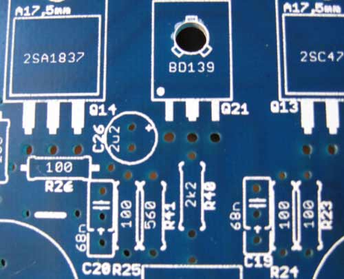

I see what confused you guys...
Without the component values you just see the outline of the resistors without the endcaps... the values had to go inside the body which would clear the placement thing up for you...
Maybe now you undertand why I was so insistent on them fixing the boards to avoid any confusion...

Thanks for the close-up Nordic - all clear now.
