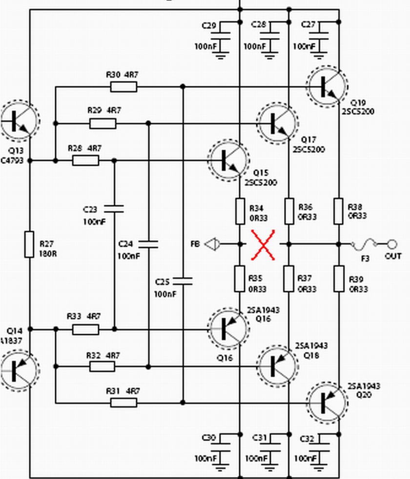

I had the need to try to remove the speaker output from the NFB line
Yes.... i could have better trebles...but the cost was too much big, the amplifier turn unstable and i almost killed some fairchild transistors that i love so much (better gain, better heat transference to heatsinks).
The idea is dead and buried to me.
regards,
Carlos

I have tried to cut here...using switch...micro one into the board.
I have made the test into the HRII...not into the Precision, but i think no good to one will be problem to the other too, as the output is almost the same...the input has differences..but VAS and output is not too much different.
I think result unaceptable.... sounded better, i have used the "same method"... same music, same speaker, same volume, same amplifier, same supply....so switched into the NFB and out from the NFB.... without signal started to oscilate... turn stable having signal.
To me is enougth..... i feel very afraid of those things...if was to myself i could even accept those risks to the better quality and could tweak to make it stable...but i do not want to have something unstable "forced" to stability, as this will go to forum folks....not a good idea to give that possible problem to you folks.
regards,
Carlos

You know that everything i do is to listen and evaluate ideas
And to sniff problems too.
I am really not too much curious about the reason why i had that unstability.... in the reality, to me is one more thing i have learned.
Not a good idea to make this modification... others will be needed...so, seems we create the problem to fix them latter...so..better not to create!
It is enougth to me.
regards,
Carlos

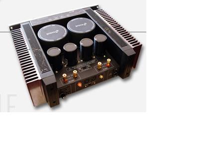

Hi all,
I'd like your thoughts on the merits, or otherwise, on a power supply arrangement I am considering for my P1. My big Perreaux PMF 2150B stereo amp uses a similar arrangement, except that I would use a Toroidal transformer.
I would use a single Toroidal T/F (1000VA).
The caps will be two 47000uf 80 Volt Mundorf M-Lytic High current caps, supplying both channels. I would probably mount them on the back cover, as Perreaux did, which would allow me to use a smaller enclosure.
I could not see evidence of inductors, bleeder resistors ot bypass caps on the two Perreaux P/S caps, although they could have been hidden under the main circuit boards.
I'm thinking of omitting the inductors, but including the bleeder resistors and bypasses.
The P/S caps would be connected directly to the circuit boards with thick and quite short cables.
billabong.

So you have shown that a single transformer and capacitor bank (yours were paralled) worked well. I noticed you used 30000uf on each P/S (2x4.7k and 2x10k uf), which gave you 60000uf paralled.
I did consider getting two 33000uf 80V caps, but thought I might as well extend myself to 47k uf. This is my swan song amp, remember.

Had a closer look at the Perreaux. The two P/S caps are specially built, 75 (D) x 110 (L) mm 18,000uf 100volt units. The amps are very transparent with clean detailed highs, probably helped by the lowish capacity. Dynamics are still very good though.
So it seems two 22000uf 100volt Mundorfs would be sufficient. They are only AU$10 cheaper than the 33000uf caps and the same size.
I'll probably get the 33000uf caps, but wonder if the smaller ones would sound better?
It appears that Perreauxt take the speaker return directly from the 0 volt connection on the P/S batteries, with what looked like a smaller wire from the speaker output on the PCB to the P/S 0 volt connection.
billabong.
