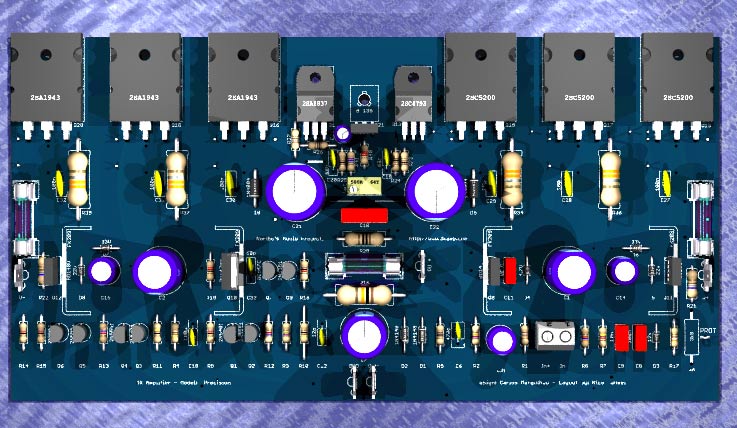

About the trimpot.. it is hard to see, but I added holes to accommodate the ones you requested too.

Nice layout!
Nico,
Compliments with the parts layout on the component side (Post #722) - looks very nice. Well done!
I still want to install the transistors directly on the heatsink, with the board on spacers parallel with the heatsink surface. Can you think of any problem if I drill the transistor holes larger - of course missing the traces - to get a screw driver to the transistors through the holes in the board.
This is only for removal if necessary - I will install the transistors first, with bent up leads and then solder them to the board after it was installed.

Hi Francois, I'm being naughty, reading thread from back to front...
see those 3 traces running in the heatsink tab area... You can cut them off (just watch the one by the middle transistor), the nyou sould be able to use vertical mount transistors (was kind of my way of slipping the posibility in there...) You will then need to replace the cut off traces with 3 pieces of wire... but totaly doable I think...
I see what you are aiming at... do not think it is impossible...
If I interpret the picture correctly I think I can even do it without cutting any traces, but will wait for an inspection of the real board.
