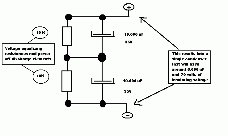

This is a very old trick i have used into the seventies while i was building
Electron tubes Radio Frequency Power Amplifiers..... Linear amplifiers to Radio Amateurs...and for CBers too (Citizen Band Radio).
I had not 300 volts condensers, but i had 150 volts units.... this way i have assembled this way (nothing new...i have not discovered that..this is very, very old) to work with my 315 Volts DC voltage to plate.
The resistances helps to discharge the units, to avoid humans to be killed by accident and also helps to equalize voltage, in such way both will have half voltage over it's extremes.
You loose capacitance,but you can double your insulating voltage..i have tested real life...more than double voltage, and i have made several times..works safely.
regards,
Carlos

There are application notes with formulas for calculating the right equalisation resistors on almost every electrolytic capacitor manufacturers websites....
e.g.: Chapter 4 from EVOX RIFA paper
http://www.evoxrifa.com/electrolytic_cat/electrolytic_appguide.pdf
cheers
P.S.: instead of buying Mundorf Cap's I would suggest to take a look at EPCOS Sikorel.... They are more accepted in the industry than those (good, but too expensive) Mundorf caps.
