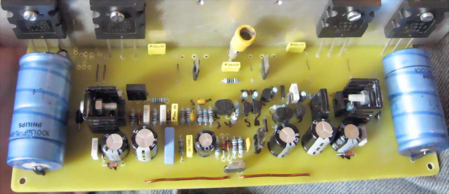

Could you please Nordic post a image of bare (unpopulated) Precision PCB. My guess is that there´s a hole for screw head under transistors body.
Thanks in advance

Here is:

In this exact moment dear nephew Nordic is powering up the Precision 1 prototype
with real designed boards.... say...testing layout to order boards from factory.
I am into the MSN with him to help adjust and debug possible problems.
nanabrother@hotmail.com
He will soon be here to say something about.
We are busy, step now is to test board.... soon the parts list, BOM and all stuff.
Also new exclusive features will be provide into Nordic boards..something exclusive to group buy, to Nordic boards made to group buy..some led indications and some interesting features into the boards.
Soon....this same channel.....
