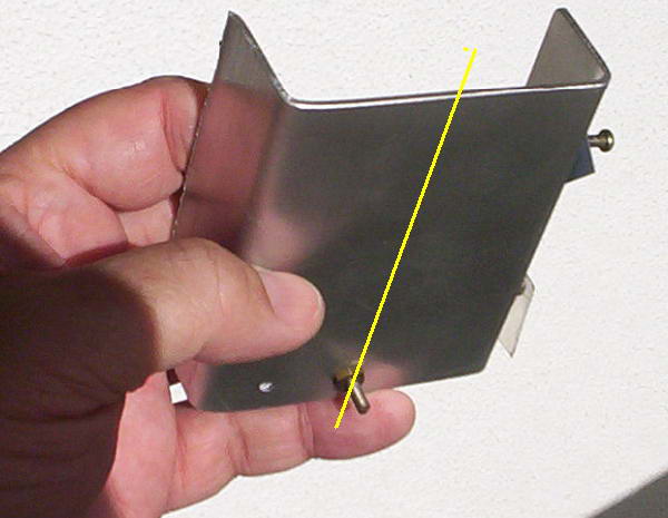

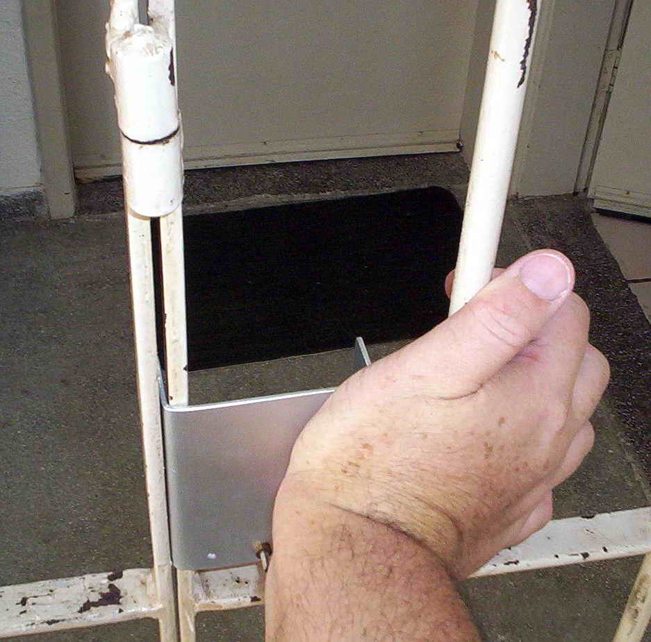

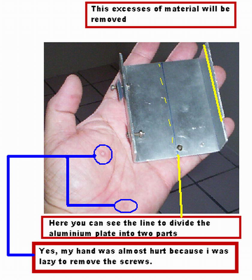

No problems dear Todd..... i will show how to transform a single
"L" shape plate into two smaller "L" shape plates.
Very easy and very DIY.
I have found a neighboor gate that has small gap..something strong to hold the aluminium into place, and then applying force you bend.
Observe images...they show clearly.
I had one "L" shape.... now i have an "U" shape that splitted will be two smaller "L" shapes once again.

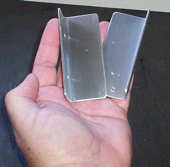

Here, now splitted in two parts.... of course
not big enougth.... very small, will not transfer very good the heat to the heatsink..because the "L" long leg has not too much area of contact...the transistor is using all it's contact area..but would be better to be into the center of the aluminium...and this impeaches to use the "L" shape that is very, very, elegant.
But for moderated, reasonable, normal auditioning volumes, using an amplifier alike the Dx Standard, with maximum 50 watts and normal audition into 10 watts RMS..then you will not have problems with the size.

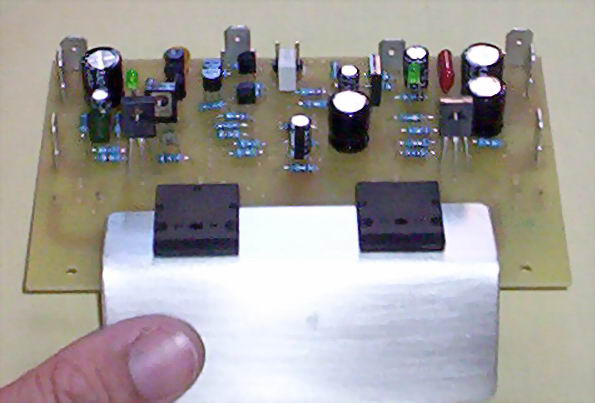

Here is a Super amplifier, a demonstration board, a prototype that will never return
to the sender..... no way!.... absolutelly no way to sent it back.
This top secret amplifier, wonderfull prototype that was not even aproved by the Master of the Designers, sounds wonderfull and now a days it is MINE!
You see, the blade is not big enougth, but can be used if you maintain the power into low levels.
The man, the one that made this board, even prototype without silk screen is the King of elegance.
