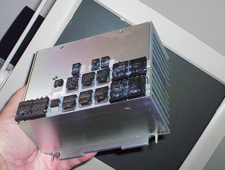

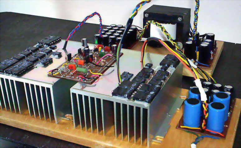

Why adhesive?
Avoid you to open holes to screws into the heatsink while you are not decided if will use this one or not...if it will be too much big or not.
Parts not decided, maybe will need to increase, maybe to decrease the output pairs...so...you will have room to change you mind without have those holes opened to screws.
Transistor may burn when subjected to killer load (1.6 ohms EMF generator) so, you may need to increase the number of transistors or to modify the output connections... so..better not to finish things you are starting..... not to make things to last when you are not sure if those parts will be there or not.
You can even change your mind to use "L" shape, or to assemble different because of the enclosure you have...so...it is something to test, that allow you to remove latter.
Without the permanent hole we make into the heatsink that turns awfull after years of work on it.
regards,
Carlos

Between my transistors and heatsink there are thermal compound
The glue is over the transistor and heatsink, a layer that hold the unit in place.
Heat transference is the best possible, nothing can be better than transistors mounted directly into heatsink, without insulators and using thermal compound.
Also my transistors are sanded using grain 500 waterproof sandpaper.... this is made using a piece of glass (flat) under the sandpaper, then, transistor goes over and is twisted there till have a flat surface to best possible heat transference.
UK friends do not need to send me thermal glue.... sittuation is under control...thanks,

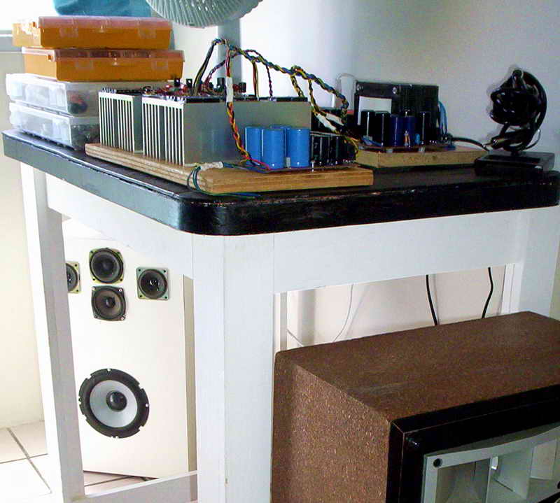

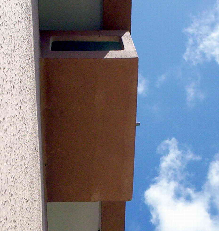

The neigthboor...the damn fat guy, the victim!
I was very lazy to test Precision II..... because this means test once again.... felt not motivated....but the motivation moved INTO the appartment above mine...the guy is living into the flat had a very nice woman living there before him, young and pretty and very friendly to me...now a fat guy there, and i hate fat guys!..they remember, when i watch them, that i am fat too!
ahahahahah!
He installed an air conditioned machine.....no problems, but 2 nigths before i was waken up with that noise of watter drops falling down into my own air conditioned box.... we have box fixed, made of concrete (cement and iron) to hold the equipment.
But into the equipment back side, theres a tube to colect watter that is created into the equipment..condenser watter have to go out from this tube.... and the tube has a piece of rubber, a longer tube to force watter to fall down distant from the other equipments.
The guy did not have installed that...ahahahahahha.... a pitty...in the reality not only for me... a pitty for him too.
I was there and asked him, kindly, to install the tube, and i have offered my help, my arms to help him to move the heavy thing.
Well... see the picture.
regards,
Carlos

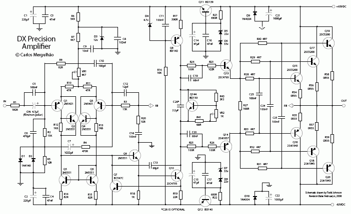

Boys!... i am happy to post here the final schematic made by Todd Johnson, our TAJ
He use to make a very good job, he is professional and kindly help us with schematics.
This one has the numbers on it...the same part numbers you will see printed into the boards,
regards,
Carlos

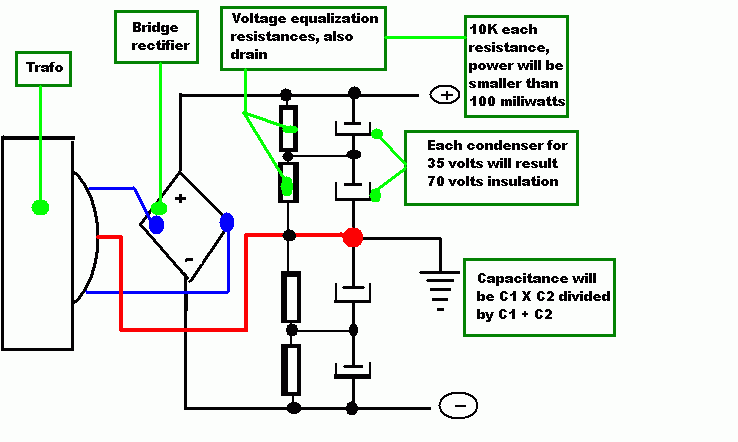

Also complainer said i made things that turns their lives hard
Not really.
You see that i gave up related the two voltages supply, and this was made to allow people to assemble two Dx Standard, or Dx HRII transformers in series to build ONE supply able to give them 70 plus 70 volts DC.
So.... things were made thinking on that need.
Also people do not need to buy condensers...big voltage condensers are expensive....so.... assemble them in series, the 35 volts units you have (or bigger than 35 volts insulation you have) and them you will have 70 volts filtering.
Of course will loose capacitance..but nothing is perfect in this world..the old "compromise".
Here is the supply(image attached), using lower voltage condensers..... i am showing a transformer with the needed voltage.... but you can build two Dx transformers in series...i have already published the sketch for that but i can do it once again if needed.
regards,
Carlos
