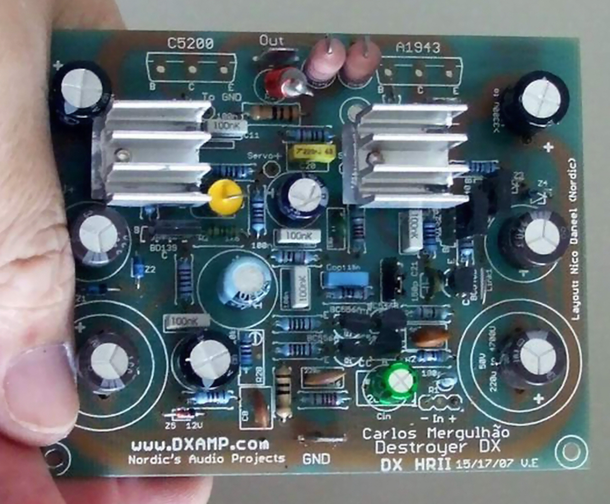

My amp has "played" but something is amiss. At first it is mostly distorted. Then, I turn up the input level and it comes to life. At this point it plays, though perhaps a bit veiled. Then a few crackles, pops and goes back to distortion again. It is similar in both channels. I can bring things 'back' but again, increasing the input level.
Measurements:
Vbe on both output devices is 0.6 volts and very stable.
Emitter to Emitter voltage on the output device pair starts out at a stable 35 mV, but then fluctuates wildly. Up to twice that level, without touching the bias servo potentiometer.
I haven't been able to safely reach the Vbe pins on the other stages as it's a bit of tight squeeze from the top side of the pcb. I will have to disassemble from the chassis to measure those.
These measurements are made with a) the input grounded b) the rail fuses in place (no protection resistors) and c) no load connected to the amp
Does any body have any hints?

Not a virtue, seems an error still remains
Increase the bias, you can do that till 300mA for test purposes without any problems....but despite the bias increase may help, seems to me you have errors as bias itself will not fix.... will just show you where to find....
Not a good idea to put boards inside the chassis while they are not tested first...now hard work to remove them, as you must test all transistors VBE that may help you to find where is the problem.
Continue to search, because this amplifier plays lovely and have no strange behaviors.

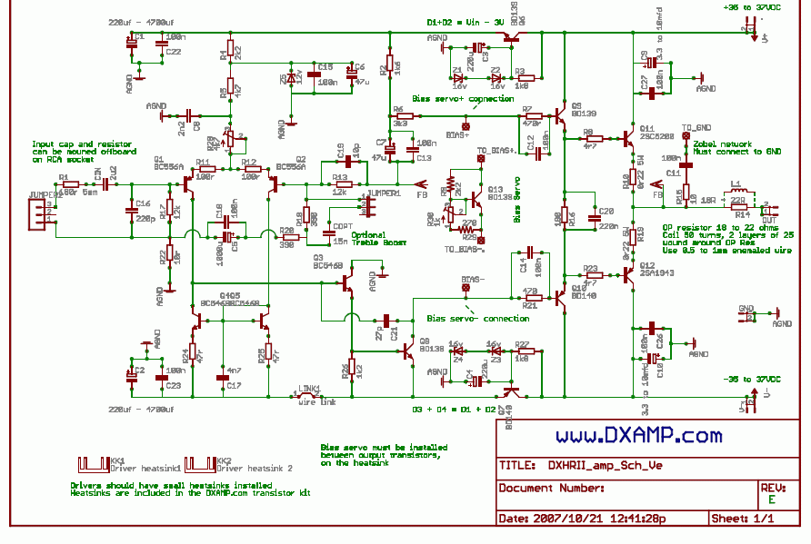

To new forum folks...here you have the schematic
Schematic attached.

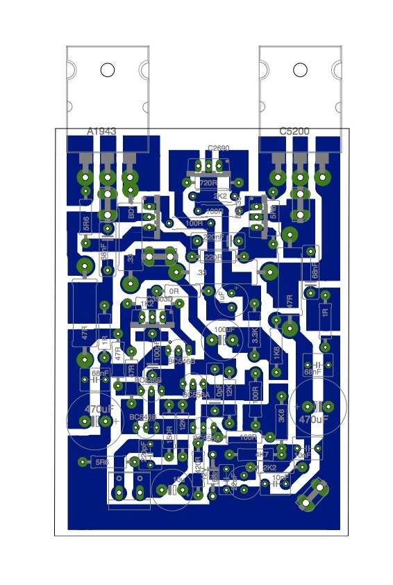

Some files about the HRII.... you have this stuff in Greg home pages
Here:
http://users.tpg.com.au/users/gerskine/dxamp/
The schematic attached was the one used as reference (part numbers) to produce the layout

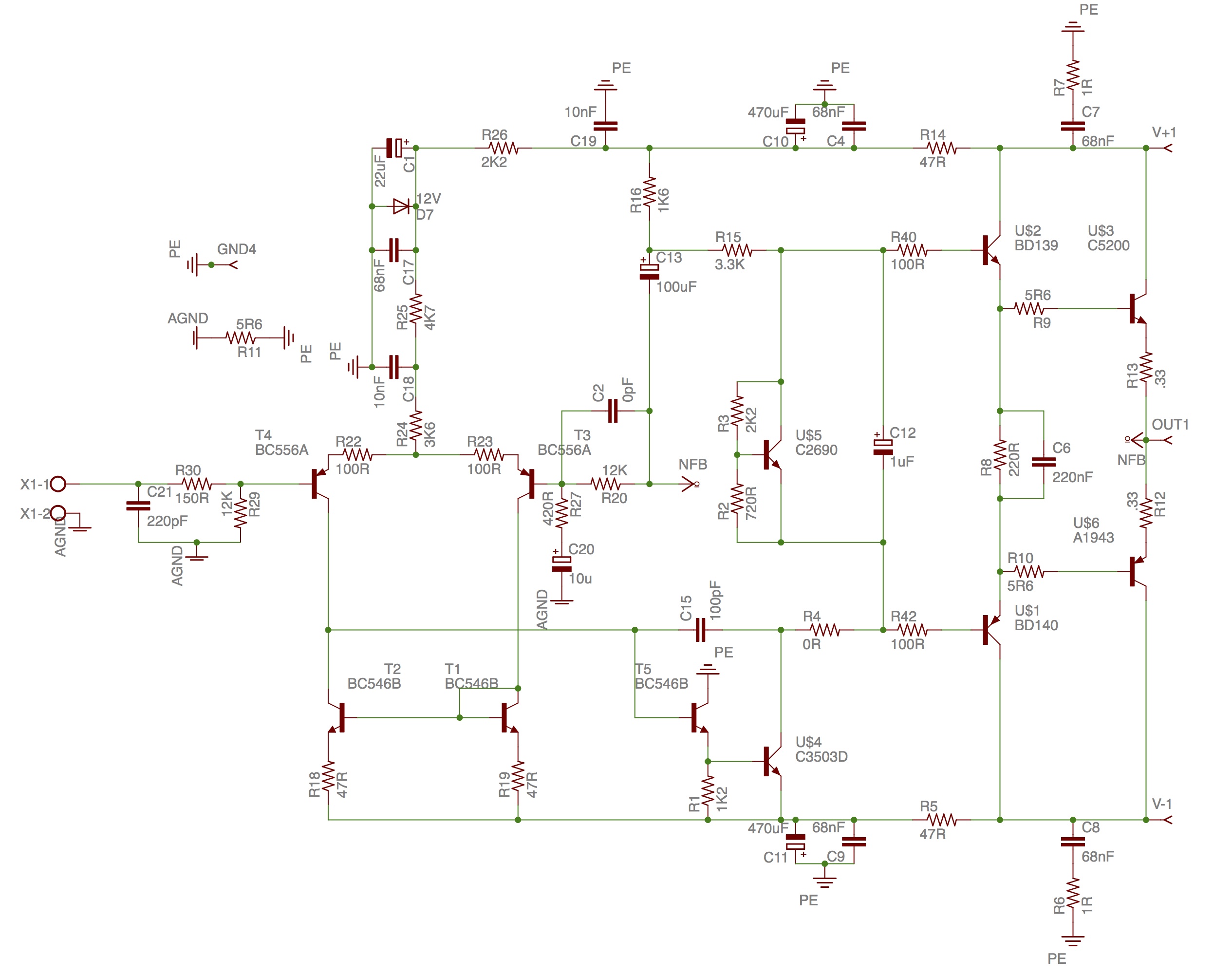

I built the DX HRII and it is oscillating at 20MHz (my comp cap is 100pF) does the type of BD139 matter 10 vs 16 different hfe's I'm using the 16 which has higher hfe could that be why its oscillating, also I used 100uF for bootstrap capacitor is that OK. I got it to oscillate less by removing the 10pF on the nfb resistor. To get all the oscillating to go away i put 39pf caps from the base's of the driver transistors to there rails. now the speaker is making all these weird clicks and pop noises and the music is all distorted. and with no signal the flat wave on the scope jumps around randomly and there is 200mv of DC offset.
Capacitors from base to colector...is this you call rails?
Maybe is what you want to say.... because in our situation is to connect from base to rails.... reduce them to 10pf...increase the compensation to 150 or 180 picofarads (Miller)... remove the one at the feedback line.
You know, the idea is to connect from base to colector, having colector resistance to rail or not.
The off set is adjustable.... try resistances (start with 10K) in parallel with the first transistor..... it has a current sink below..and the current sink have resistors..values goes from 47 to 100 ohms and i do not remember the HRII values... select the left hand one and install a 10K trimpot in parallel and try to reduce the off set.... first adjust the trimpot to read 10K....then install and go reducing the resistance and see if you off set reduces...... is it not reducing?... then install small trimpot (50 ohms) in series with that resistor and goes increasing the resistance.... when the off set is zeroed... then measure the trimpot resistance and substitute by a fixed resistor with the nearest values you have measured... you can install a second resistor in series or substitute for a single one that add both resistances (fixed plus the adjusted resistance adjusted in the trimpot and readed in your ohmeter)
If you have off set...or you have mismatched transistors (differential is the main ones) or you have errors in resistor values somewhere.
Interesting...first report about oscilations...and an interesting frequency.

Could the high hfe of the transistors make it oscillate Im about to replace the vas with a KSC3503D which has less hfe
I do not know...usually do not oscilate even with high gain transistors
I have used 220 of gain without troubles...i do not know the reason why...check your circuit searching for mistakes first... check if your capacitor is really that value you imagine it is (capacitance meter).
I have no reports about troubles in this amplifier....so, i understand that a mistake while building is a possibility.... the board itself, component values or something missed.
Reduce gain of transistors and make modifications into the original design is something we do when we have reports saying the amplifier is oscilating...and several guys assembled and no report arrived saying this...so...i believe in a mistake.
In my mind what should be done is to search for errors and not to try to fix an unstable design, because no reports about unstabilities.

I soldered the new transistor in place (KSC3503D) and all signs of oscillation are gone, just a small amount of noise at 5mv. It sounds great!! There is 14mv of DC offset is that normal? Also when I was putting together the 2 channel I plugged the V- and V+ wires in backwards and the floating emitter resistor on the drivers caught fire. I replaced that resistor and the emitter degeneration resistors and it seems to be fine. I been listening to it for some time now, do I have anything to worry about, or should it be fine. I uploaded the PCB and circuit that I am using I just wanted to know if there was anything obviously wrong with them. Thanks.
I am glad you are now satisfied
Yes... 14 milivolts off set is very good...anything to worry about.
