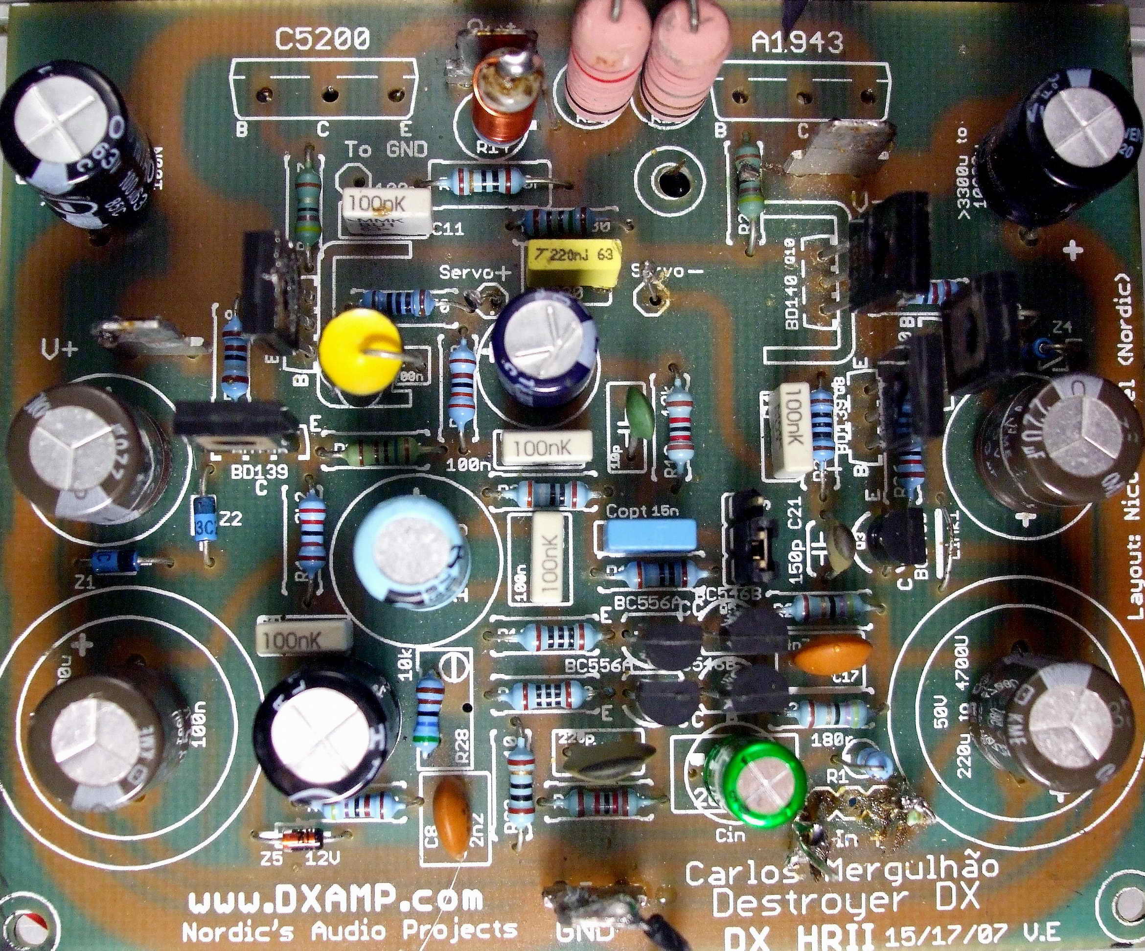

There's a picture from the HRII in this video....shows board assembled clearly:

The reality, dear fellows, is that we have some confusion
Here you have the HDII group buy..this was the first confusion, the amplifier is High Resolution II and Nordic have openned a HDII group buy.
The second confusion is that he made the board, and part numbers are from his schematic... we have the first schematic at Greg's site.
I cannot remember anymore, i have some troubles about memory now a days, but the HDII thread may help you to find solution... so, you have to study all informations available... even the Dx amplifier thread has something there too.
Here is the link, please read it entirelly:
http://www.diyaudio.com/forums/group-buys/108456-destroyer-x-amplifier-dx-hdii-version.html
I will search for Nordic's schematic to post it here.... sadly he disappeared, it seems he passed away, as he was very sick about nervous connection from brain to body.

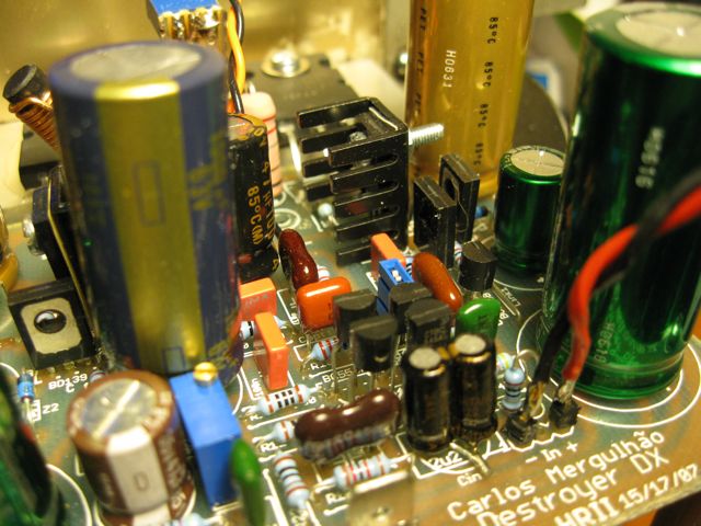

Further tests...
I looked at my boards against the schematic a few times and all seems well. So I decided to hook up the board to a bench power supply. The power supply can put out +/- 70 volts and a lot of current (I used a transformer from a dyanco 400 for this power supply). I run it from a variac to set it to output lower voltages.
1. I connected the power supply + lead to 10R 10W resistor, then from the 10R resistor to V+ on the hrII board.
2. Similarly I connected the power supply - lead to 10R 10W resistor, then from 10R to V- on the hrII board
3. I connected voltmeters across each of the 10 ohm resistors
Now, as I raise the power supply voltage, the voltage across the resistors goes high, probably too high e.g. 6-7 volts. I stopped the Power supply at about 22 Volts as the 10R resistors were getting a bit warm by now.
When the supply voltage was at approximately 20+ volts (6+ volts across 10R), I tried to adjust the bias at the servo trim pot and nothing happened to the voltage across the protection resistors...I only observed small variations in either direction of the trim pot.
It seems clear that the power supply I have in the chassis I plan to use has problems.
But now I am uncertain how to proceed with the bias adjustment. Are voltages that high expected across protection resistors when you begin to dial in the bias setting?
What am I missing here?
Thanks for your help.
Ryan

I have check for shorts between all the pins on the devices connected to the heat sink, there are no shorts there.
Bias not operating seems you have errors in the bias circuit
or errors in the circuit board.
Check the bias circuit till you find something wrong... the screw that fix the transistor to the heatsink sometimes produces short from the this transistor's colector to the heatsink, and the heatsinks should be grounded..this means short to ground... when you have no adjustment, seems the bias circuit or something in the associated circuit is wrong.
This is normal, happens with the majority of people, mistakes are common and very human.... we can see hundred times an inverted transistor without detect it, sometimes we have BD139 in a place we should have BD140, also happens with the small ones..sometimes people put the NPN output in the place destinated to the PNP output.
I cannot see with your picture, has not the needed quality of ligth, focus and angle..but i could see you're using a coil with a ferrite inside...remove that ferrite as soon as you can, it saturates and produces a "tac!" noise when you have high current crossing it...exactly when the bass comes strong.
Check everything once again....make a print copy of your schematic, put your board against ligth and check each copper track painting in your schematic in red..check each transistor soldered watching the model, if PNP or NPN and the position of Base, Colector and Emitter...check each capacitor and go painting this in the schematic copy till you cover the copy entirelly with red lines.
Check your supply voltage polarity, check if you're sending positive to the positive side.
Check solders and if you have shorted joints, use magnified glass (lenses)
I would like to be at your side my dear, to inspect this over your shoulder, but i cannot, so, you will be the one to check each part.
Also check each resistance value, you can measure it in the circuit and lift one side (dessolder) to check it if the value measure seems suspectious to you...the resistance value can be smaller because the circuit, but cannot be higher..this is the clue to lift one side to measure.
Also you can check resistances.... disconnect supply wires and measure from positive to ground (the board positive input), also negative to ground and also positive to negative..... INVERT your probe point tips and no measurement should me smaller than 30K.... it is usually around 500K or even more....but be patient, as your condenser will charge and the meter will have overflow..you should wait or remove all rail condenser from the board...if you have shorts...that's your problem and you may search for the part shorted..usually semiconductors does that.
Bias trimpot MUST operate, so, you have to read huge differences in voltage when you turn it, unless you have errors in the bias circuit, in the associated parts or in your circuit board.... there's no cake recipe to find the bug...there's hard work to check with patience.... each symptom can have many possible causes.. so, i am not able to point you the part missed, wrong or damaged.
Base to emitter voltage helps a lot...it should be from 550 to 640 milivolts.... also if you have not voltage from base to emitter, or colector to emitter..seems you have a shorted (burned) transistor.
Here you have the "method" to adjust amplifiers, you can see the bias trimpot operation..not your amplifier, this is to the blame..but the way we do is the same:
http://www.youtube.com/watch?v=Ku-w-WAxHs8&feature=related

getting closer...
Any insight is welcome. I know that I am getting close to an operating amplifier.
One channel seems to bias up just fine. 3 mV of DC offset, while in the chassis. The second channel biases just fine on a bench supply (see * below) , but behaves erratically when I put it in my chassis. I believe this is because of a power/ground issue (not a fault in the board). I have tested for shorts at about every possible location and have found nothing unexpected.
At my star ground point (at the common/ground of the power supply caps)I have connected:
1. Center tap of the transformer
2. Ground point of the board
3. Speaker "-"
The same is true for the second channel, with its own transformer and power supply capacitor bank.
NEITHER of these is connected to the chassis ground. Neither are the power supply grounds connected to each other. Is this correct? I have the earth wire from the mains plug connected to the chassis (where I have sanded down to bare metal). That is all for connections to mains earth.
* The second channel does bias just fine, but DC offset sits at about 20mV and I am unable to adjust it much at all with the potentiometer at the input stage.
I am about to try the second channel with the transformer and filter caps from the working channel to see if it behaves better. Then I know the problem is with the other power supply set up for certain.
Thanks for the help.
Ryan
3. Speaker "-"

Update
Just to update you on my progress ...
1. I removed a CL-60 current in-rush limiter on the mains neutral line. I don't know if that had any deleterious impact, but I wanted as few components to trouble shoot as possible.
2. I wired up a 300-Watt light bulb in series with a 5 ohm, 250 Watt power resistor and tested the power supplies in the chassis with this load (across +/- so roughly 70+ volts). Light bulb glowed, no blown fuses, the voltages dropped to about 32V at each rail. But the voltage was very stable. No hum, no buzz from the Antek tranformers
3. I checked to see that the bias settings on the amp were stable from the previous attempt. I used my bench supply and the amp warmed up to just where I left it yesterday.
4. I re-flowed the solder joint on the ground jumper wire beneath the board, on both channels, just to be safe.
5. Put the amp/heatsinks back in the chassis. Installed the protection resistors. And powered the amp directly from mains, without the variac.
🙂 Yes, indeed, the bias came up just as it should 😀
Discovery... when I attached an "old" voltmeter that I had been using to measure the DC offset, the bias settings went crazy. I suspect that voltmeter presented a load to the amp and was messing with my bias readings all along. I had tried so many times, and I don't recall when I did, and did not, have that meter attached to the output. As soon as I removed the connection, the bias settings stabilized.
I powered down and am having a drink to celebrate some progress. I will put things together soon and test.
Thanks for the help Carlos,
Ryan
Ryan
