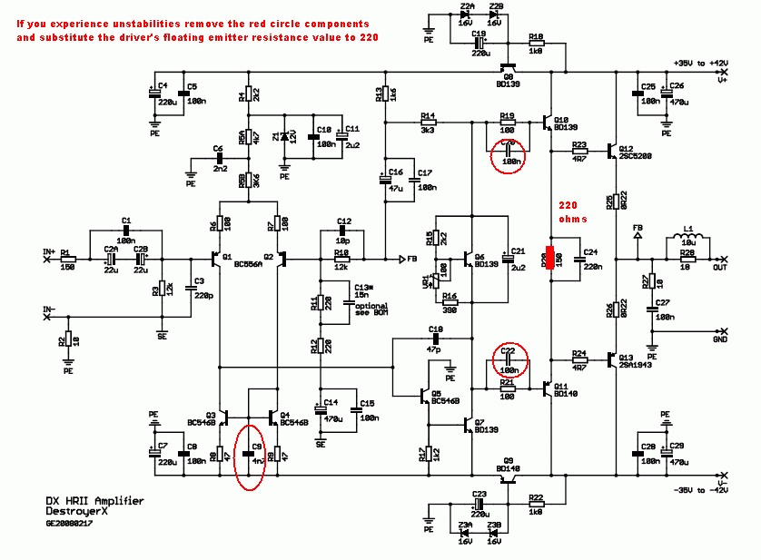

Because the scope dear Taj, i have found modifications to increase HRII stability
I see that it dislike 2.2uf in parallel with the load, and to work this way, say, facing capacitive loads, is a need or a target, because some speakers crossover/cables are very inductive, also very capacitive, there are some complexity in the load, speaker systems, passive crossovers, cables and speaker drivers.

I am producing some small modifications, reduction of phase advance RC value, and other small modifications, but this does not change pcboard layout.
Value changes, not circuit changes.....just one may be a problem, the zobel is not taken into the speaker side, not anymore at the feedback line side.

If you experience unstabilities using your HRII, them remove the red circle
parts, also increase the driver floating emitter resistance to 220 ohms.
I suggest you to listen your amplifier without the Phase advance system (Sansui), removing the 100n capacitors.

I am about to apply power to a set of Nordic's boards for the HRII. Before I do that...
1. What is the voltage rating on the 47uF cap (C16 on the schematic on Greg's site)
2. Can someone help me find a post/link to start up procedures. I have searched the 3 or 4 HRII & Dx threads and have not had much luck. (Maybe I don't know well enough, how to use DIYaudio search tool) What I would like to know is: size of and expected voltage across initial protection resistors (those in place of fuses). Also, at one time, Nordic had a 'checklist' on his site. I am unable to find that particular page.
Thanks in advance for the advice.
Ryan
Ryan
Dear RKH,
C16, as the bootstrap capacitor, is recomended 100V (or rail to rail voltage, as minimum).
http://users.tpg.com.au/gerskine/dxamp/DX%20HRII%20Amplifier%20Green.pdf
About the startup procedures, I think you can use the DX Amp procedures, but the DC offset that not applies to the DX HR II. See in this link:
DX Amplifier Adjusting the bias, and trimming DC offset
Best Regards
Best Regards
