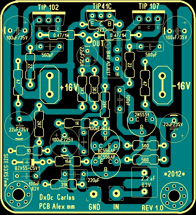

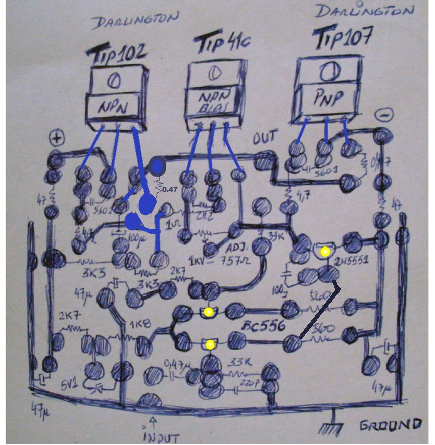

DxDc PCB smaller ?
...... I'm back again with my last PCB project DxDc and I hope I have done right....... Just my little contribution 😉
Regards Alex. 🙂

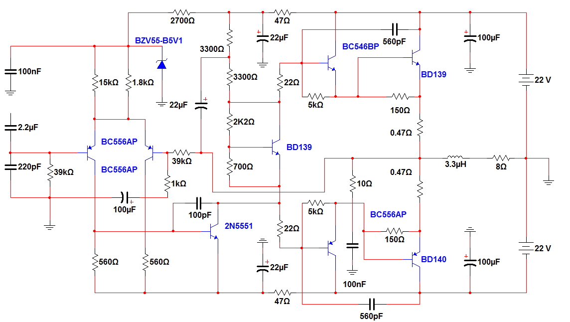

It is not correct dear Alex because i am not using discrete darlington in the output
As i have explained to Norazmi, the schematic is not the final one and i was using discrete transistors because i have no good darlington unit in my simulator..... the reality is that i am using darlington...but people can use the way you made because will work too..they will have to replace the output by a bigger units because BD139 and BD140 will explode if used in this circuit with all that supply voltage..... i was trying to make, to fabricate, to create a darlington.
The amplifier uses darlington in the output dear Alex mm ....so.... despite not wrong, and that can be even used, it is not the correct amplifier.
Also i have the intention to make the board even smaller...i am publishing videos and there you see what i am doing to reduce size.... vertical resistors i am using in order to reduce size.... see some videos if you have time dear Alex....here you have the link to videos:
destroyersoueu - YouTube
A brazilian friend was invited to make the pcboards...he even have made, but i have not published because the amplifier is not ready to go....i am testing for a while...he made the pcboard and i have asked him to hold on till i finish.
You are really fast Alex mm, but seems you have lack of time to be reading....you take schematic and go ahead....the schematic shown was not the one...not correct..... the output is a fake, fabricated, darlington alike style construction, made to substitute the real darlingtons because the lack of these parts in my Multisim 11.0 (Professional full Edition)
I will post another schematic showing the real thing soon....with some small darlington in place to show you the small amplifier it results using these transistors.
regards,
Carlos

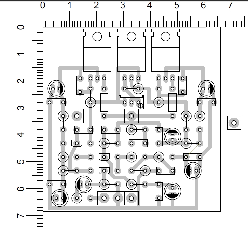

As a tradition i use to make one pcboard my style, and always
i use pcboards from cooperative friends...Alex mm is one that is always present and made several of my amplifier's pcboards...very welcome his job to us.
Also Herman, a brazilian friend is doing several projects to help me...he made this suggestion you can see below and i have asked him to wait a little bit and to move the lower condenser to the right side in order to fill the empty space we have downwards and right side.
regards,
Carlos

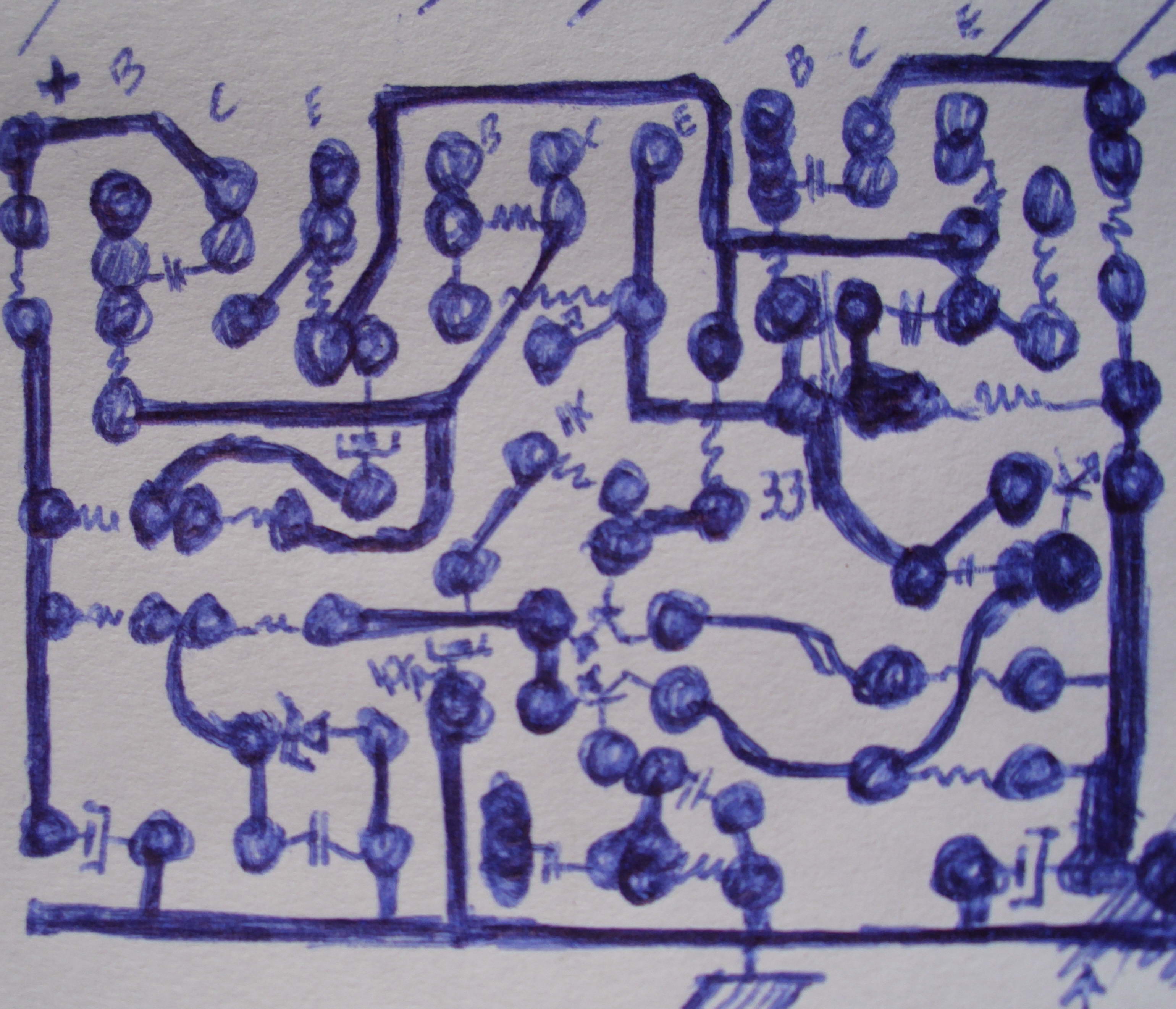

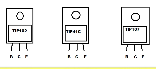

To make your board usefull, dear Alex mm, we must change things
and use it as a discrete darlington output amplifier.... pins must change because BD139 is different compared to TIP41/42.
But what i really want is something made to darlington..with vertical resistors to make it as small as possible (the main idea, the philosophy, is to substitute an integrated circuit by a better discrete design)... the board should be as small as possible...a micro board is what i want.
You see an image with me trying to make your pcboard usefull and another image show the output that i want placed in your pcboard.
thank you,
regards,
Carlos

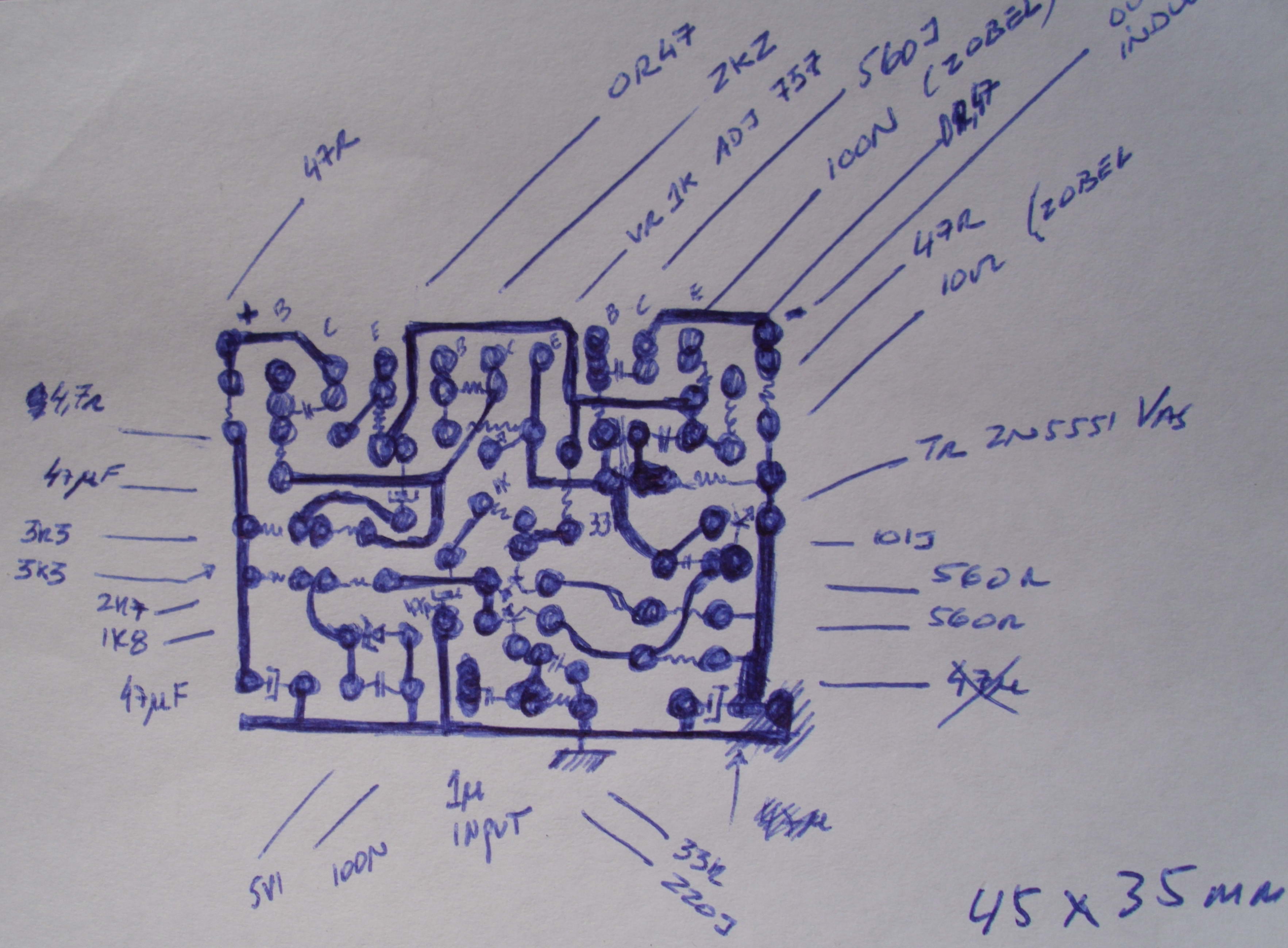

@fireworks , my software, it's Sprint Layout 5.0 licenced, with modified library by me acording to my taste . I not use automatic router , only manual , that's the real artwork. 🙂
@Carlos I do my best ,as usual, to layout with small component, and right size of PCB .😉
Regards Alex.

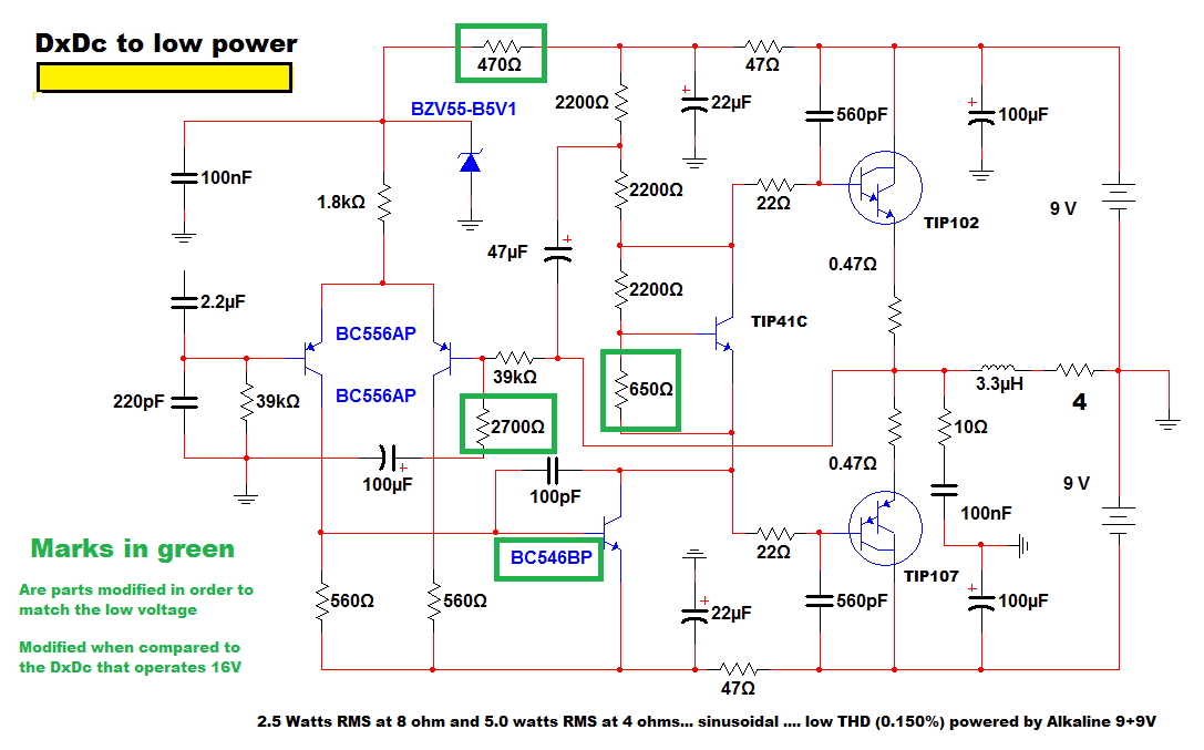

Thank you Alex.... small is very important because the idea that is
behind this amplifier is to substitute (with advantages of audio quality) an integrated circuit.
Another idea is to produce something that can be installed inside a small bookshelf.. and this ask for small dimensions and reduced power.... this video here explain you how i decided to make this one:
http://www.youtube.com/watch?v=5i9LV1IJhsc
Something able to work with 9 plus 9 volts from AC-DC small outlet converters and even Alkaline batteries to very low volume as a monitoring amplifier.
The amplifier must work with 22 plus 22 volts to 8 ohms loads and do it in a reliable and safe way...also to operate with 16 plus 16 volts accepting 4 ohms and being safe.
This is the main idea..... so, to be small is the most important thing...the use of darlington transistors was the choice to reduce the parts count...to be small.
More important than to be pretty is to be small and reliable.
Posted goes the 9 plus 9 volts schematic to be tested...not approved yet....of course using batteries they will be exausted in a very short time.... this will be tested and evaluated soon.
regards,
Carlos

Impressive what Alexandru did.... i could not make it smaller
I made the challenge.... impressive he has beated uncle this way..... that was nice too.

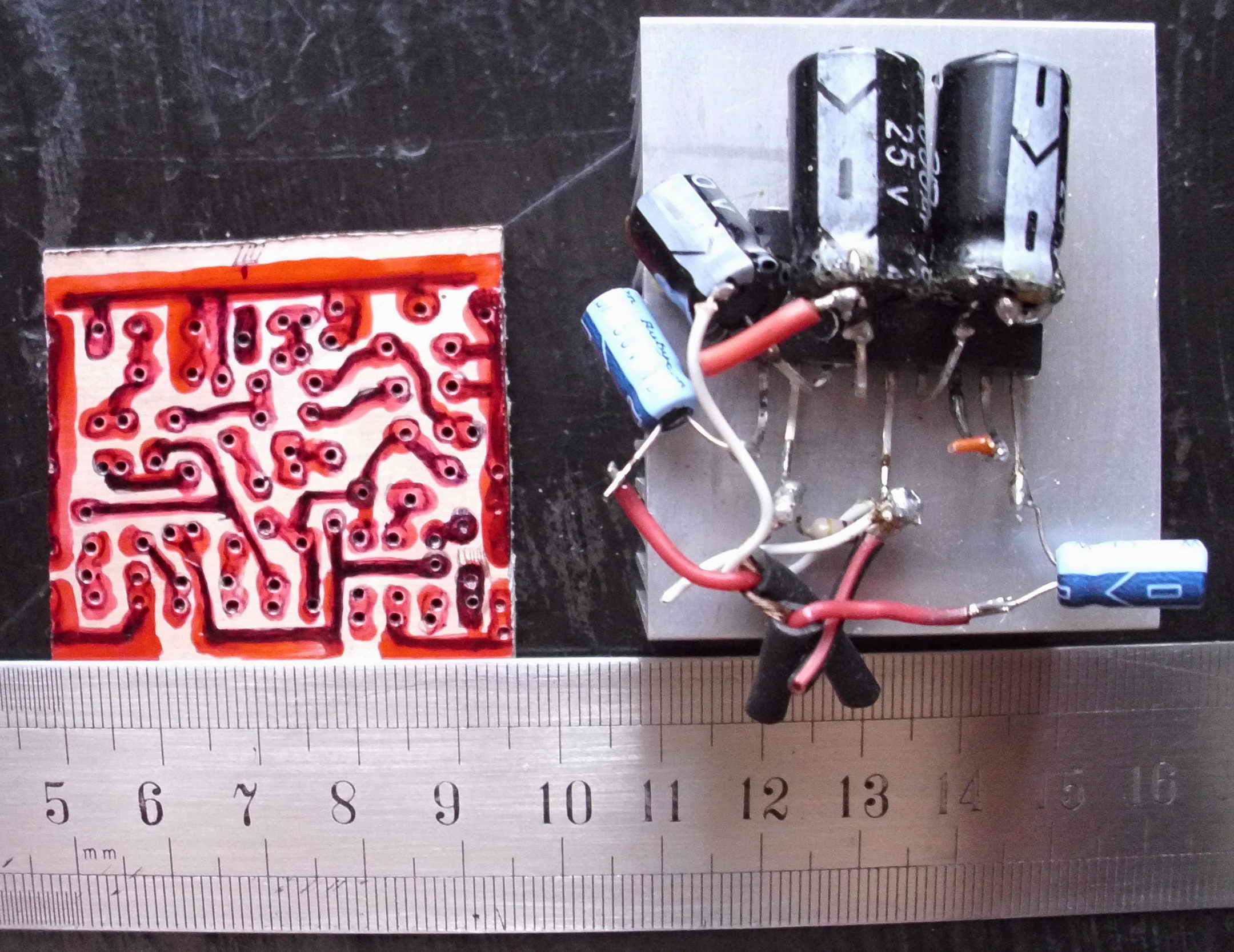

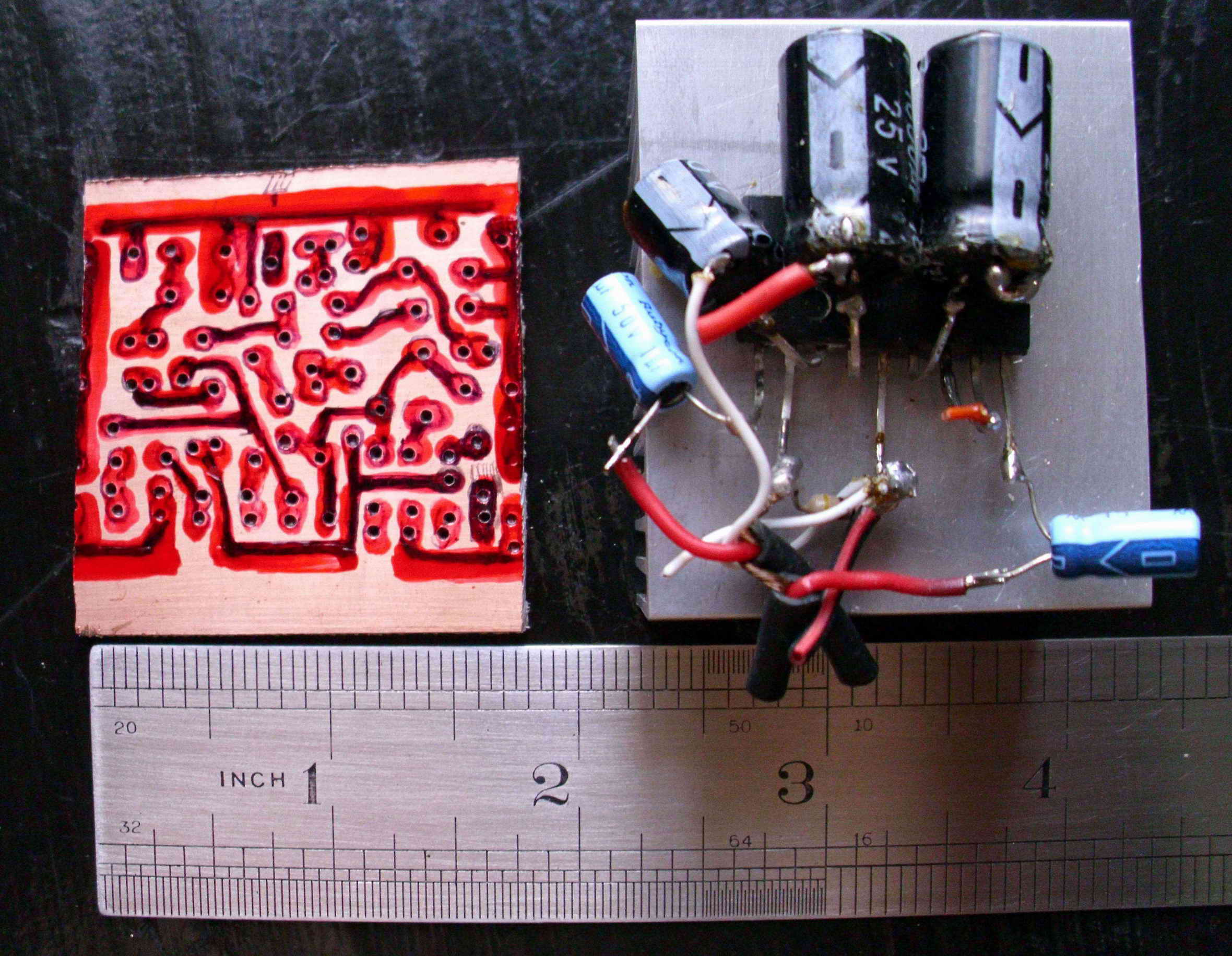

Will cut and finish and assemble my tiny board today....it will be squared and i gonna do it using flat surface, ruller and sandpaper..also shorts will be removed prior to etch.
regards,
Carlos
