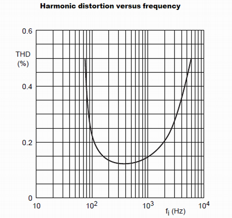

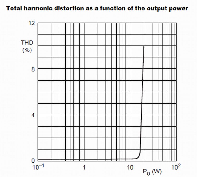

The main idea is to make it small with superior performance
When compared to a chip (IC) audio amplifier..... or will be much more clever to assemble an Integrated Circuit if we cannot make it small.
You see this one..... TDA1519.... look at the performance and distortion in the datasheet...and it is small and stereo..... if not small and better, would be more clever to build a TDA1519.
I think i will make it.

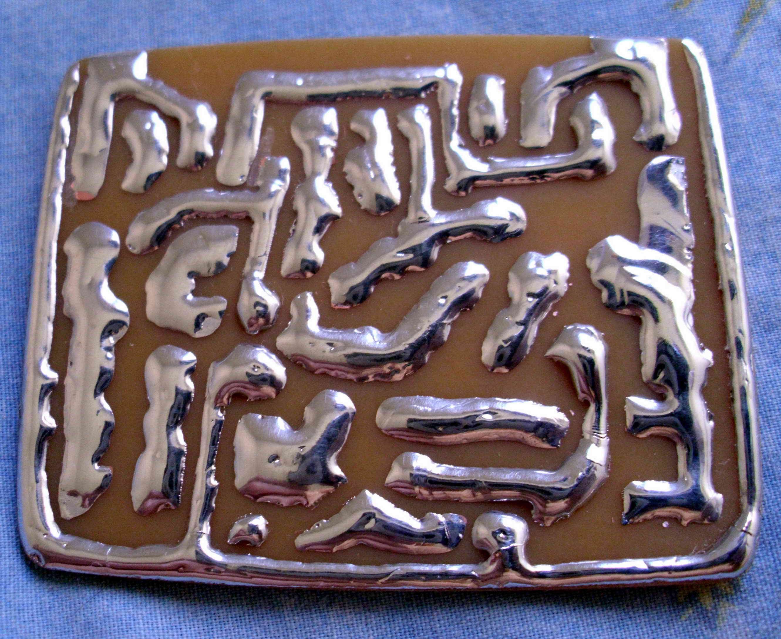

The board is ready...soon i will assemble
Have to ask permission to my surgeon...he said i cannot be sitted for more than 3 minutes.... also he said that is much better to avoid to sit and to be layed down in the bed in horizontal position.... i have 100 centimeters cut into the bely that can be damaged (open) if forced.
Here you have a video about the board being made:
Dx Dc prototype board ready to go! - YouTube
regards,
Carlos
Here you see how it gonna look
It is not complete, not ready and have no values because i gonna decide the final values in the workbench.
It may have errors....but when assembling i gonna face them and will fix them...also will inform you when posting the real world assembled board.
Board artistic style is ancient Maia.... the shape reminds a stone from Machu Pichu .... Inca and Aztecs
regards,
Carlos

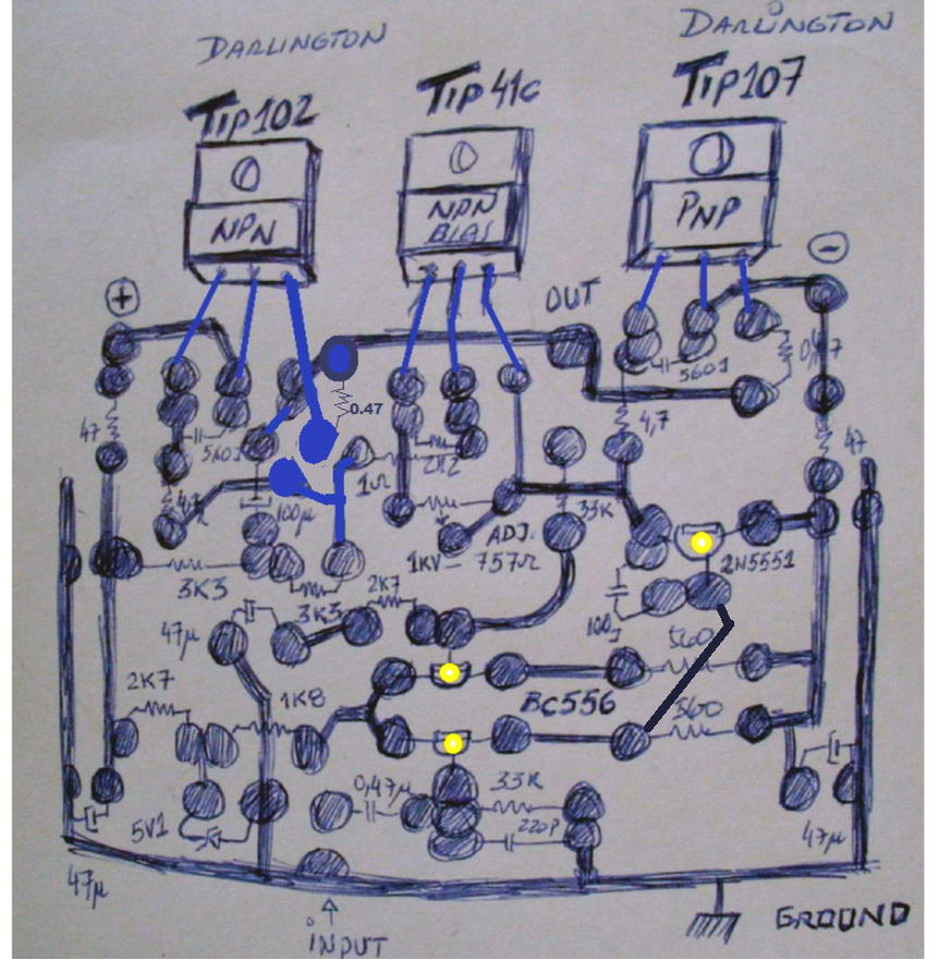

I am thinking to use darlingtons in the output, to make the amplifier simple, this way only two transistors to the input differential pair, one small transistor to VAS and two darlingtons in the output... the ones i have to make tests are TIP102 and TIP107.
I am not sure if it will result stable.... really, to be sure i have to tweak and try and to use all resources i have.... we gonna see what gonna happens.
The idea is to make it simple, small, and better in sonics than regular integrated circuits..... using discrete parts in some kind of high dense construction...the board i am showing is too much big...i am thinking it can be reduced 30 to 40 percent in its dimensions.
I do not know about other darlington transistors...... but it seems that any 30 watts darlington transistor (or more), able to dissipate 20 watts or more, that can face 40 volts from Colector to Emitter, and able to face 2A (or more) from Colector to Emitter will be good to be used... the ones dedicated to audio will be better than the ones are advertised as "switching power transistors"...these ones will work, but will be more problematic.
I will inform the transistor types as soon as i test.... BC547/557 or BC546/556 or 2N5401/5551 may be used to differential and voltage amplification stage...these ones will be tested.
I am healing from surgery...as soon as my surgeon say i can be sitted for long time i will work hard and soon you gonna have results that you can trust...and tests will be made, not only real life but also into simulator...also live tests will be recorded in audio and video.
If darlington results not good..then i gonna jump to the highly tested Dx amplifier...and then we gonna have a good amplifier anyway.

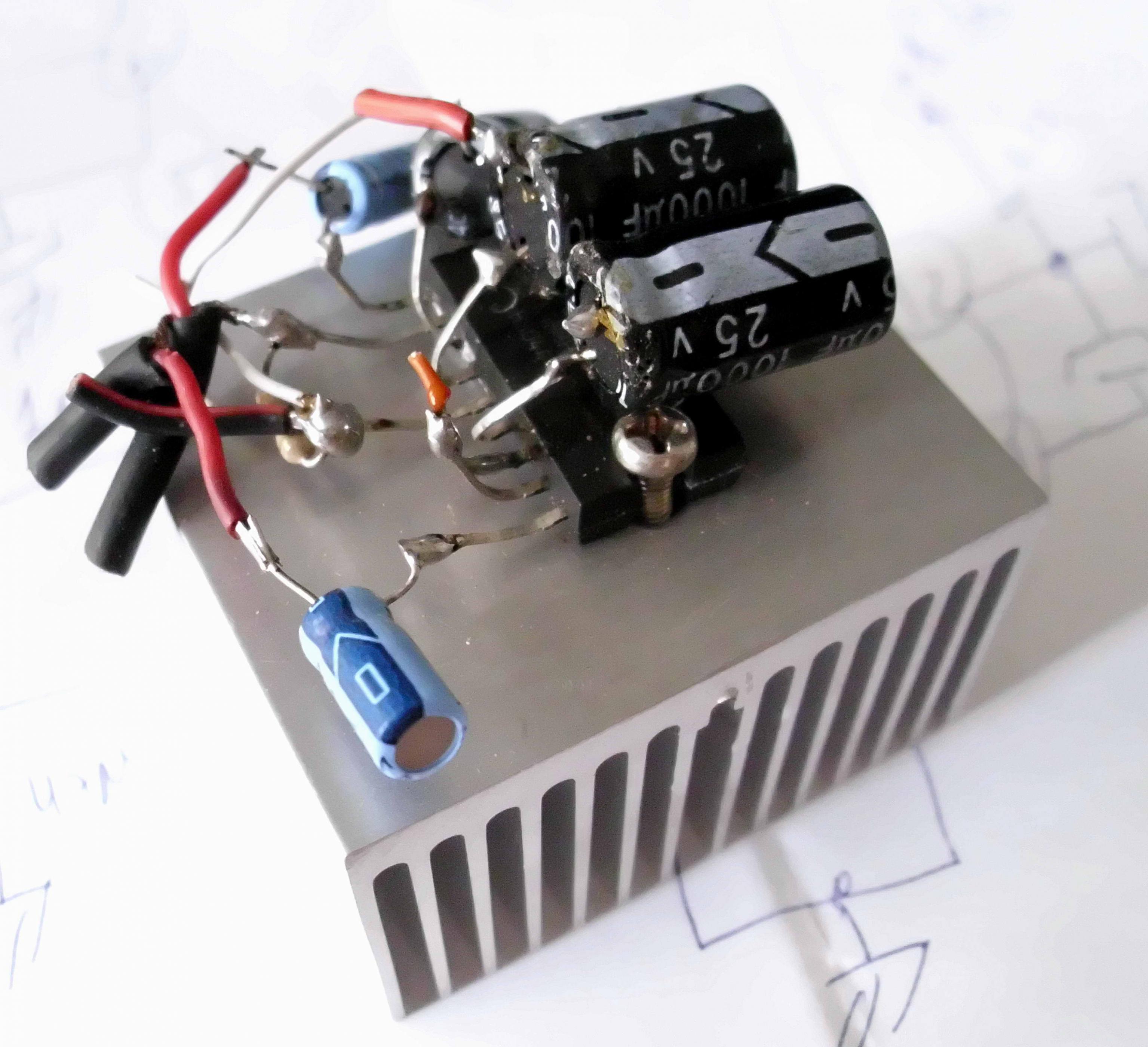

DxDc amplifier today..... the way it is today...not ready..under testing
I have already shorted two pairs or darlingtons....first was because i made a mistake and the stand by current was 400 miliamperes...this forced the amplifier to an idle power consumption (and heat of course) around 16 watts..then the small heatsink was not enough and the transistor was shorted..blew up.
There's no signal of unstability and oscilations.
The second pair i have shorted was because i have installed one transistor loosen....the screw was not tight and i have forced the amplifier for long time into distortion, the temperature arise and i have not perceived..the current increase and the thermal control was not enough to reduce it (small heatsink) and then transistor shorted.
Not only this stuff, but also i have to tune it better....i do think i would need a little bit more high end..the capacitors applied to the darlingtons seems too much big...this make it more stable but not good for high end reproduction, speed, slew rate, transient and so on (560pf)
This schematic may change a lot..not approved for a while..do not assemble...or do it under your own risk.
I repeat...not ready to go...just to show you something is progressing.
Sound is great... also power is enough (Rolls Royce)....i will make better recordings using the Kodak Playfull Ze1 camera...then you gonna perceive the audio quality....gonna do it today...not a final quality that may increase...but the way it is today.
