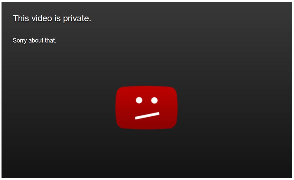

can you update the video link as "unlisted" I can not see it 😕
