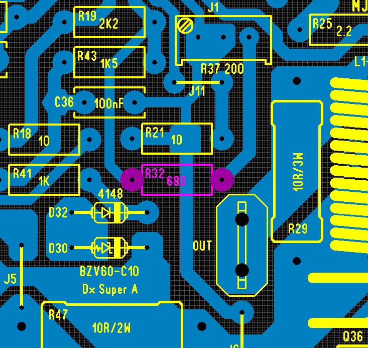

Dx Blame ST together Dx Super A
Caps removed
I watch the video and I was amaze that just a simple cap can make a difference wow ? I'm right now heating my hot iron to remove them thanks Carlos 🙂
by the way yes the leads space has to be update on the boards, I thought you will instal them this way as this image but is good that you saw the detail of the copper that is really close to the edge of the PCB "my bad" 🙄
ok caps off, sorry I was removing the caps while writing this jejejejeje
Best Regards
Juan

OK I took willy's TO-3 design and managed to get it to a transparency to make a photo etch board pair. This is the first time using positive pre-sensitized boards and I must say it is vastly superior to the old toner transfer method.
Progress so far...Just need to finish stuffing the boards, just the front end transistors and the jumpers, thats about it. I put the TO-3's in there for the photo op...I love me some TO-3 transistors.
Well I finally got the amp fired up! So farso good...although even at 40v+/- I can only get the bias up to 170mA. I have a 200 ohm pot so iguess I need to adjust the 680 ohm resistor...increase right? I always get that mixed up....
Offset is hovering right around 10mv or less
Anyways the amp sounds really nice and is very quiet.
Here's a pic...still need to clean upmthe rats nest.
PRmUEA0rkMHEGgwKGUnCcndECWzlcbHg5gV4o4jvNtI=w516-h387
oh my God ! 10mV offset wow man looks really nice, 40V power supply is ok I'm running the ones I have at 43V, Carlos hasn't seen this yet he will love it!, hey rapid question here, did you use white thermal paste from L shape adapter to the main heat sink ? it looks really clean 😀
About the 680 ohms resistor probably you can lower it to 500 ohms because you are using 40V +/-
the voltage I read from the 10 ohms resistors in place of the fuse on my boards I always adjust them to about 2.5V +/-
Regards
Juan

The Vbe multiplier output voltage, or bias voltage, is given by:
Vbe * [Rupper + Rlower] / Rlower
If Rlower is a 680r and a 1k VR, then the bias voltage can range from:
[2200+680]/680 * Vbe, to [2200+680+1000]/[1000+680] * Vbe, i.e from 4.24Vbe to 2.31Vbe
If you maximum bias voltage is too low to turn on all the output transistors then you can increase Rupper and/or decrease Rlower.
OK guys...I re read much of the thread and finally realized that the goal is 250 mA per rail, not device.
I am stable now at 75mV across each emitter resistor @0.5 ohms. So I am really at 150 mA per device or 300mA per rail.
Andrew, thank you for that vbe multiplier formula, that is a keeper and now it makes complete sense to me.
I need an empty house to crank it up and see how it does at louder volumes!
Thank you Carlos for an interesting circuit and thank you Juan and willy for some great layouts.
.............................Andrew, thank you for that vbe multiplier formula, that is a keeper and now it makes complete sense to me....................
That is the basic to get you into the ballpark.
You now need to take account of the different Vbe in the 5 or 7 transistors to "design" the Vbe multiplier with it's resistors to take account of tolerances.
That is rarely done in this type of guesswork Thread.
