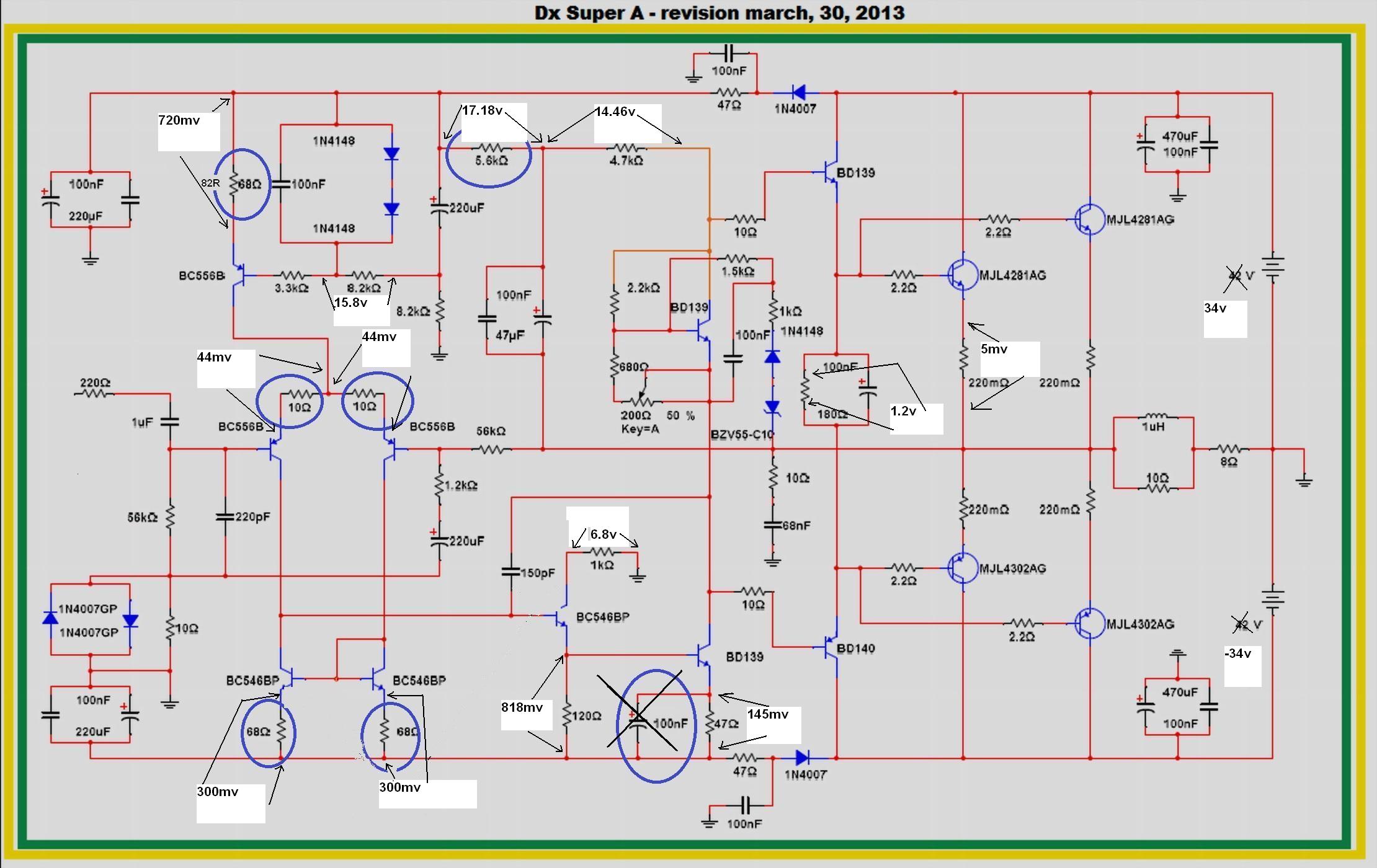

Today i have remove c 38 (100nf)and this amplifier is tested again.
Unfortunately overshot is present in MY amplifier.😡

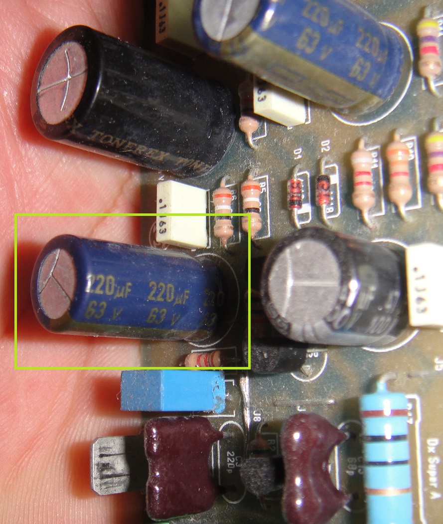

Can someone answer about these components ?
I am not an expert in electronics but photos Thimios his post # 1181 C3 and C13 are ceramic capacitors, this is a good choice?
Thanks dear and what about these 100nf parallel to 220uf?
yes they are in parallel I forgot to mention that 😀
Regards
Juan
Ceramic capacitor also works fine
It is not that stable compared to silver mica...but the instability it can provide/generate is small and will not harm sonics.
Silver Mica is more stable when you have variable frequency into it.... as a load or tunning capacitance counterpart in tank circuits..much more effective in SSB Radio Frequency transmitters..... we have small variations of frequency and voltage.... we have not supressed carriers....we really can use ceramic too.
Into Radio Frequency output of high power (high voltage) Single Side Band transmitters, in tuned circuits, into colector tank circuits, the one and only capacitor you should use is Silver Mica..for audio is optional.... connected to faith and believe...overkill is the real word for that.
Some choices are more to give us "psychological" support due to our faith and beliefs than to add a real performance advantage.
In almost all amplifiers i have made the Silver Mica was there.... why?
Because people believe it can be magic...and if you say it is not magic, they will not believe your amplifier is good.
Zimmer, the Brazilian-German that made last pcboards and decided to provide kit of parts, have asked me if he could use ceramic to reduce cost.... and asked if performance would be harmed...is said real performance would not be harmed...but expectations would be harmed.
What i mean..... the one believe Silver Mica can produce better sound..if not use it, will always be thinking "how could be the sound using Silver Mica"...to this one..better to install Silver Mica .
Got it bro?

Ok Carlos.
I thought the capacitor C13 ceramic could be unstable problem encountered Thimios but I am absolutely not an expert then chuuttt! 😀

Mine shows a little over shoot on the scope but sounds really, really nice. As good as any of my other amps.

Agree ! - use good quality multi-layer NP0 ceramic and you will be very happy. This is the best quality ceramic and in terms of technical performance of the capacitor, it is better than silva mica.
Silver mica ... silver wire , gold plate. It is our DUTY to consume ALL rare earths
and precious metals. As is proclaimed by our corporate overlords !
BTW - SM caps have the best PPM/C tolerance. A ceramic might change 67 (to)68p over
50C ... not a bit of issue with standard Cdom.

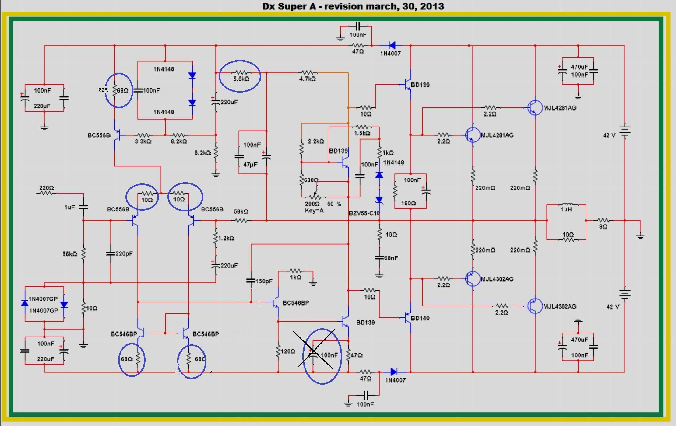

PSU - check
yes, I did, those Murata trimmers are expensive, but they really pay off!!, I can dial pretty much to 0.1v easy 🙂
Me too, 🙂 I always get Bours brand trim pot a bit expensive but I rather have a really accurate adjustment as possible, about the adjustment keep in mind that after you hook up the amp and the speaker is on place, probably you will have to adjust it again after load is present
as Carlos mention to about +42 - 0 - -42V DC, take your time if you are putting together the audio boards, enjoy the build sir 🙂
