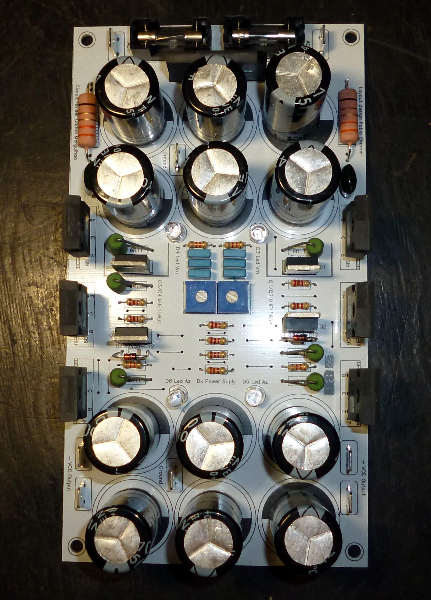

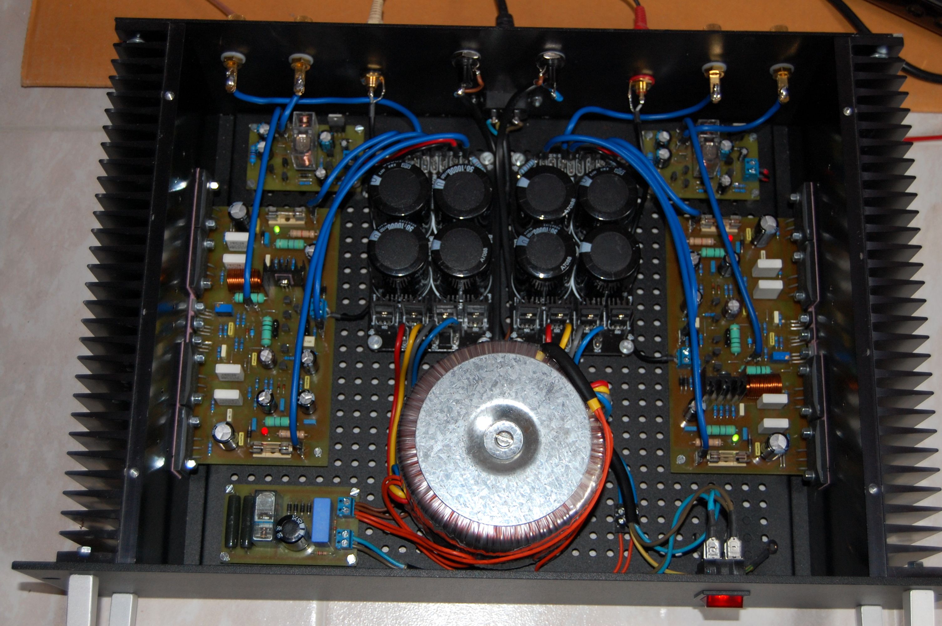

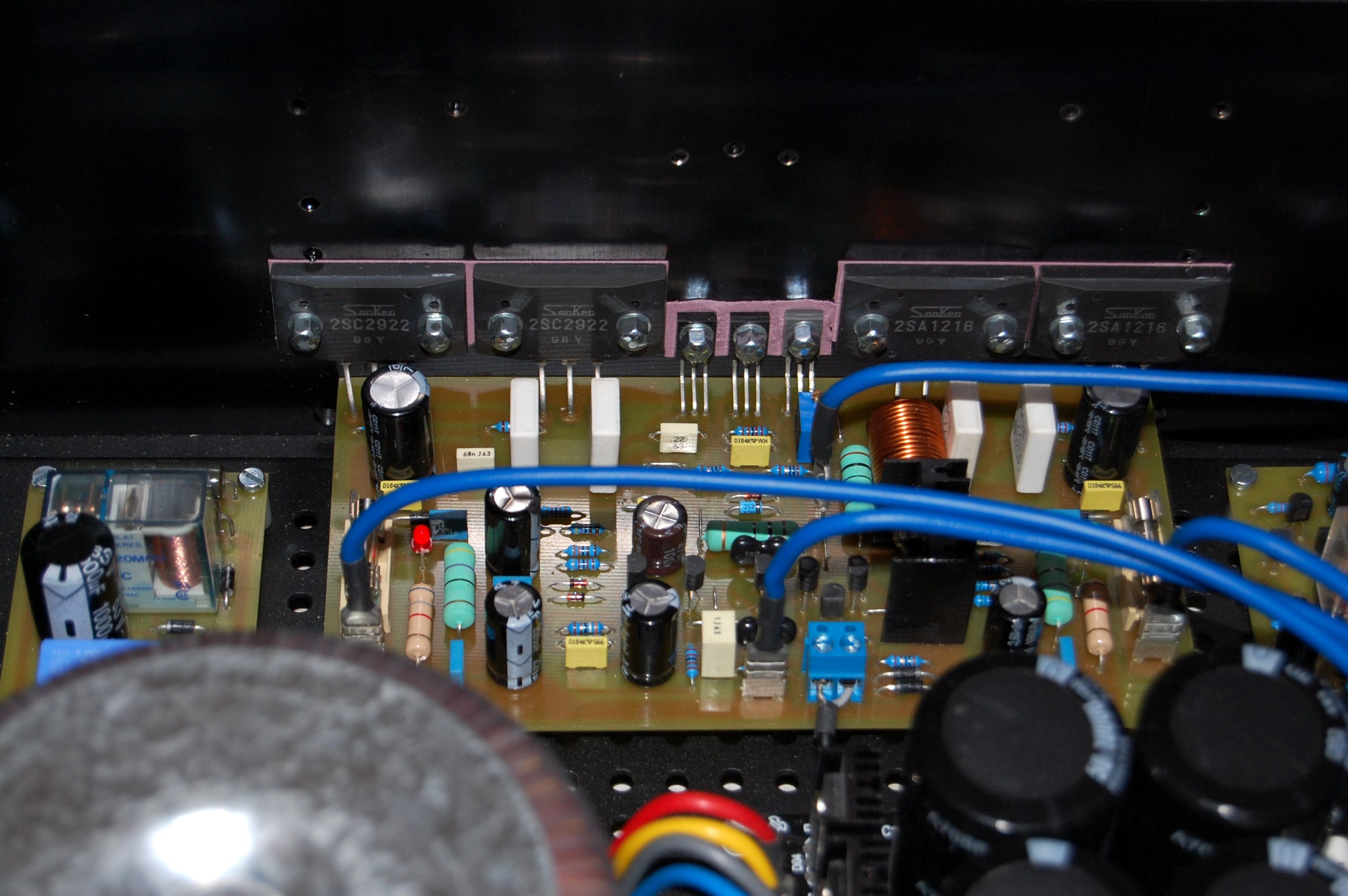

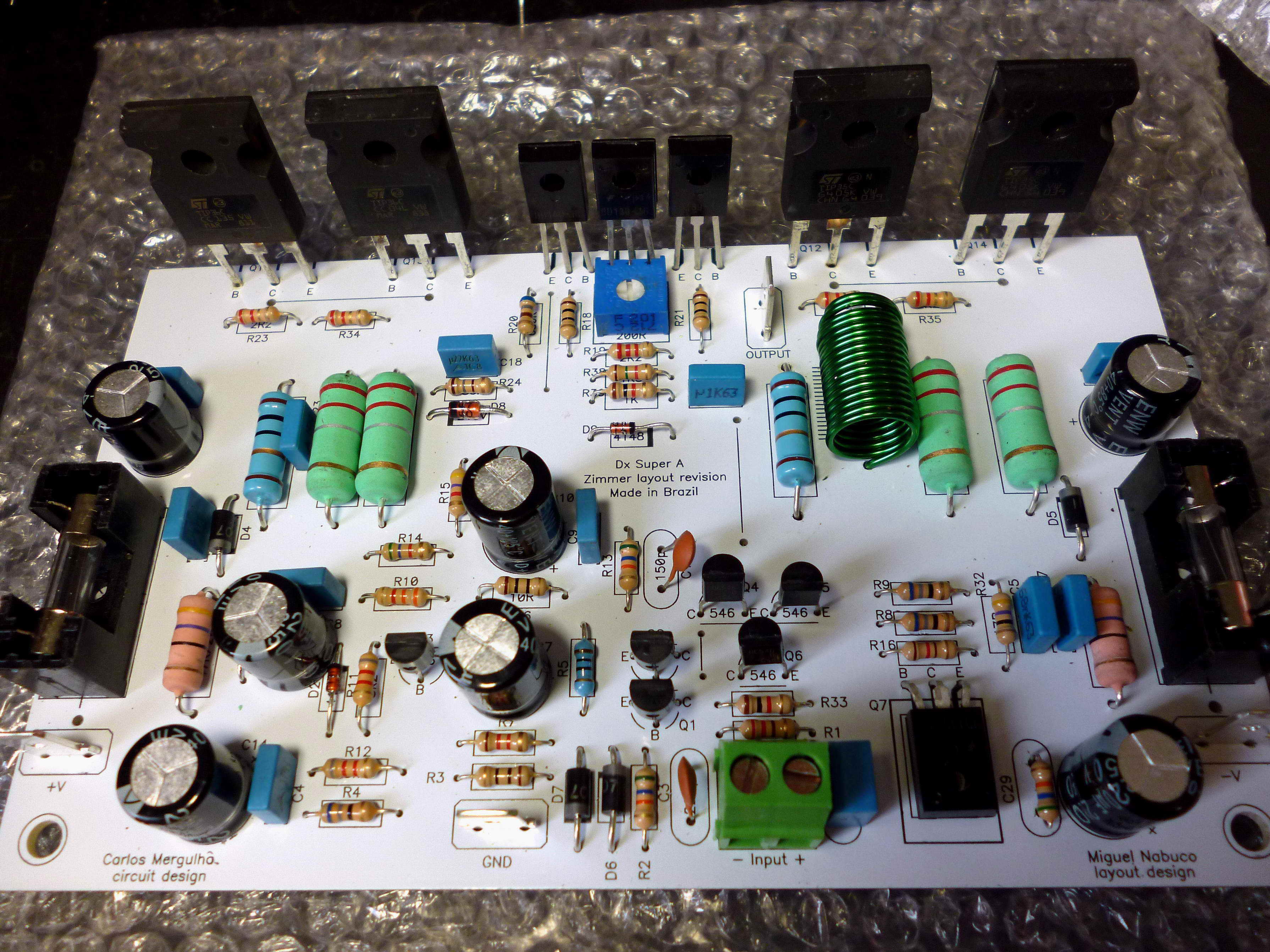

Dx Blame ST together Dx Super A
Very nice bro very nice colorful and sexy amp Carlos will be happy as I'm 🙂
Regards
Juan
Thank you very much bro and of course without your worderful layout mine will be nothing.... So you deserve a big thanks from me and everybody who build this amp....😉
massive... looks huge.
What about the sound... are you satisfied?
regards,
Carlos
Very happy and very satisfying sound my dear uncle charlie...
No hum or hizz, Mid and high are perfect for my taste specially the punchy bass....
A treasure that can be proud to have this kind of lovely amp.😉
Yep..... a nice sound machine.

Dear Carlos!
I took my time but here are my impressions of this amplifier!
For the settings, no problems!
I have provided the DC amplifier protection and a sofstart.
Each channel has its own power supply and are not interconnected by the mass (in fact the two channels are completely separated them).
The supplies are not stabilized because the two transformers that I had too low a voltage output (2x22v - 220VA), which allows me to supply + / - 30v.
After the stress of commissioning, this is happiness!
A power amplifier generates no noise or breath is complete silence!
This amplifier has a lot of punch and speakers who cash it needs.

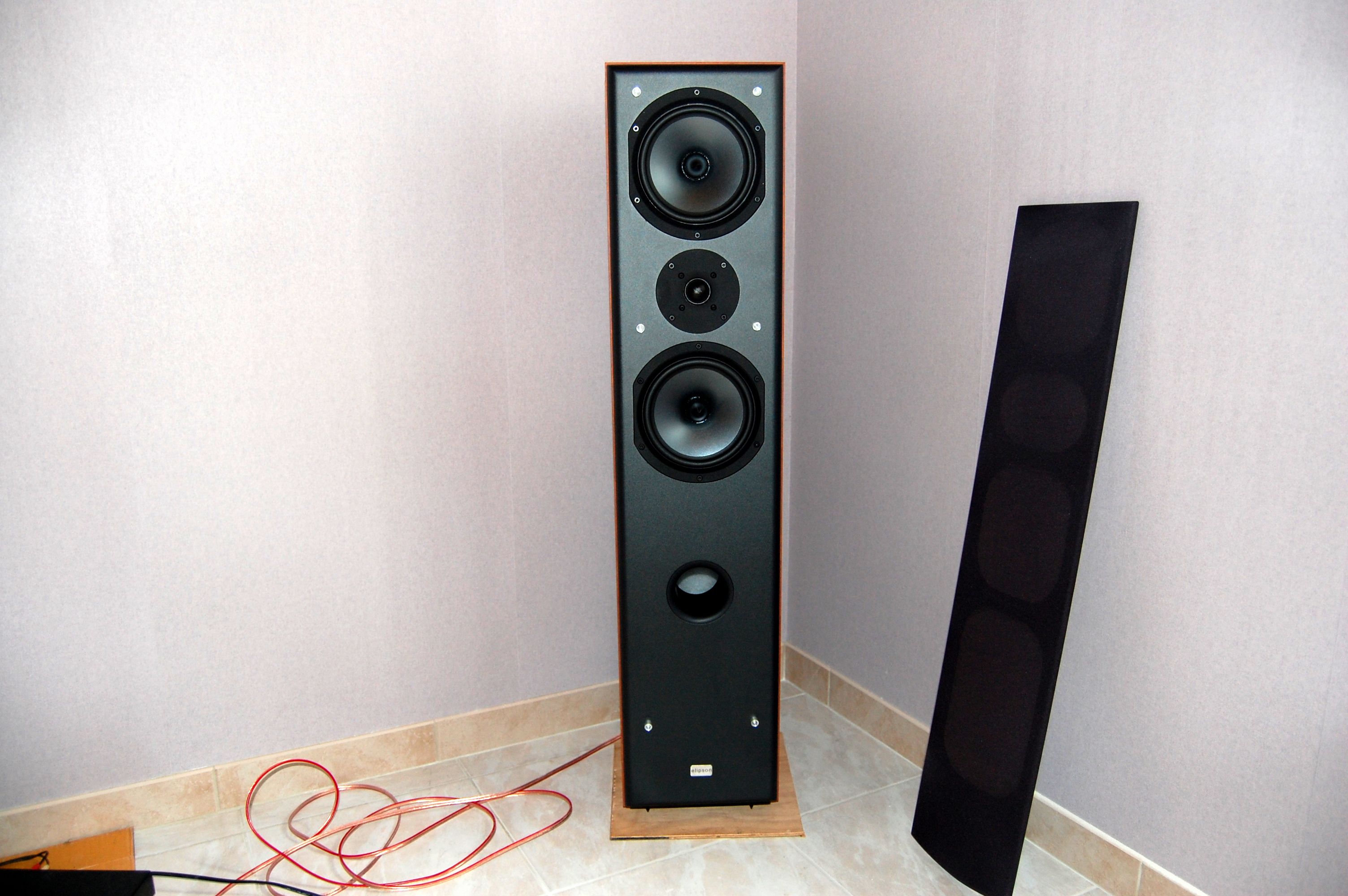

On my Elipson Prestige 3 (8 ohms) I have a warm and immediately surprises is trebble precision (very detailed) sound, voice going beautifully.
The medium are present and do not attack the ear and for me it is a very important point.
The bass is punchy and powerful (even on my small Elipson), only my speakers have a bit of trouble to transcribe the low end.
After several hours of listening to my realization heat sinks are moderately hot and I still have the margin to operating temperature.
To summarize this is a really good amplifier I do not regret having built and success is guaranteed!
With stabilized power supply that must be giant!
Well done Carlos for this achievement and thank you for all the advice!

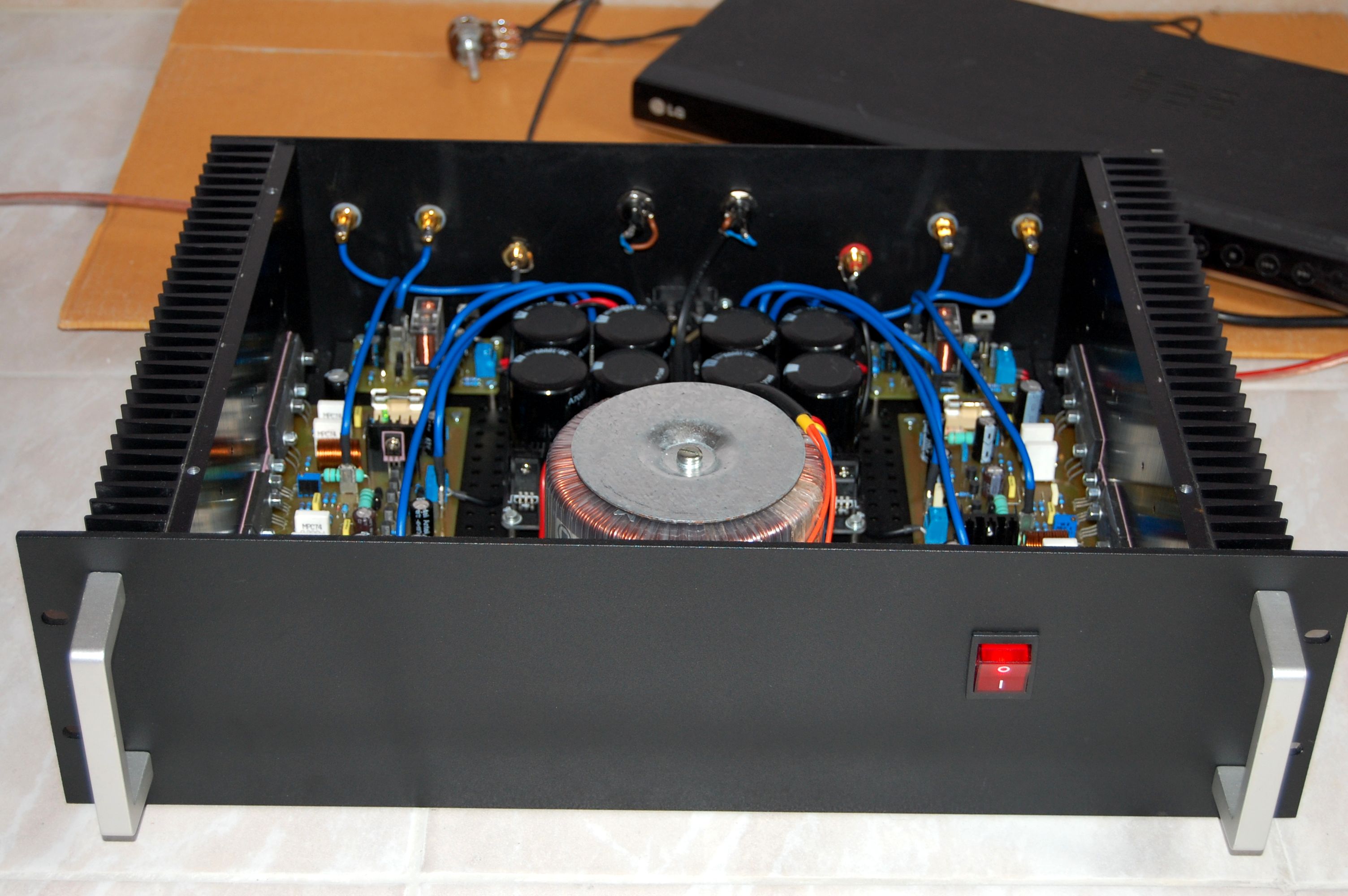

Dat case is beautiful! I wish I could get my hands on cases like that. Are these premanufactured or did you do the metal work yourself?

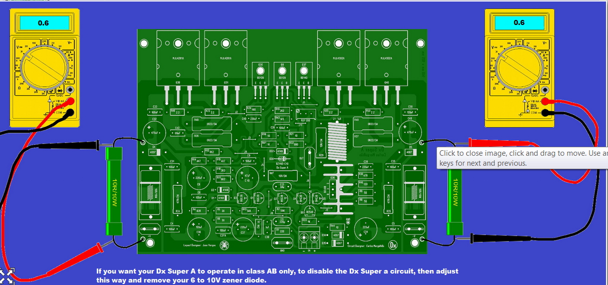

If you do not want to have Dx Super A operation because of the heat
Or the low power in class A...or because your heatsink is small, or because you do not listen classical music and the feature gonna be disabled all time long..or because any kind of other reason..then readjust your bias to 600 milivolts in stand by mode and remove the zener diode (6 to 10V zener diode..the only one in this amplifier).
Then you gonna have a standard class AB amplifier with awesome sonics and with low third harmonics.
Juan will make a better image..this one i have modified and the result was not good.
regards,
Carlos
