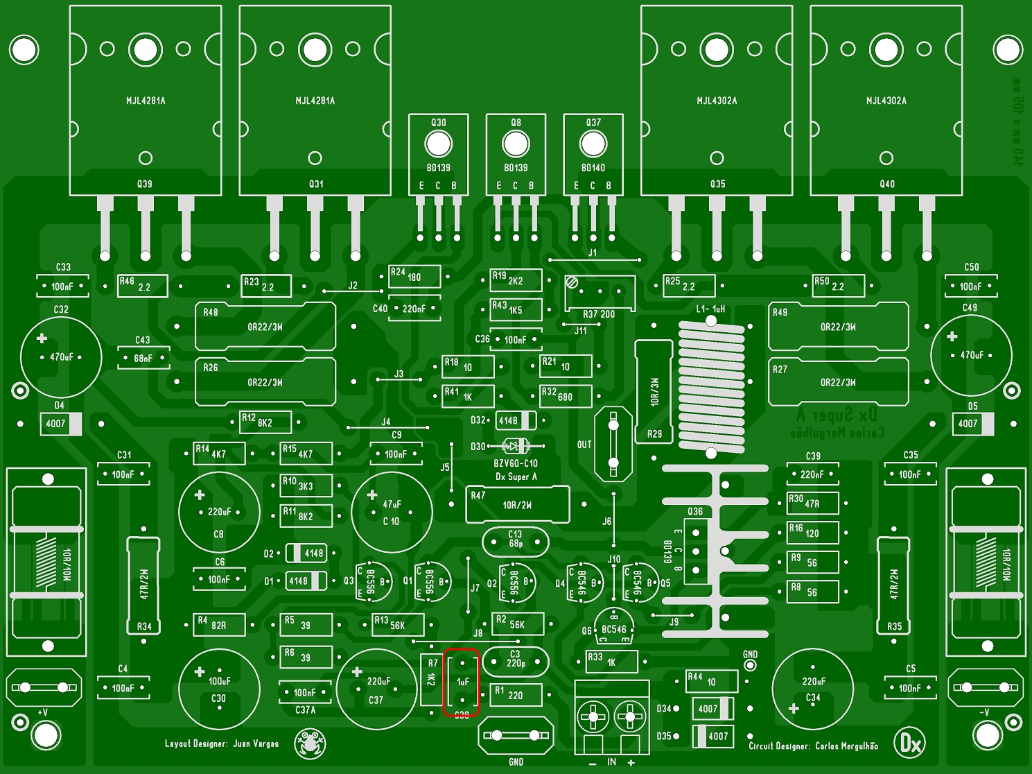

To attack my DX Super A, i need an impedance matching circuit between the player and the amplifier and the Pass B1 fed symmetrical pleases me.
I have a question about the DC input on the DX.
The capacitor C38 surrounded on the images it protects the DC if a problem occurs in the B1?
Regards!

The input capacitor you have highlighted and the 220uF electrolytic in the NFB path make this an AC coupled amplifier.
This is the safer way to drive your speakers.
Faults up stream don't blow up your speakers.
Only a serious fault inside the amplifier puts your speakers at risk.
That's where fuses and soft starting and temperature switches and speaker delay relay all come to your speakers' aid.
This capacitor blocks DC from the audio source

You can use any 50K or 100K potentiometer you find
wire it with the most short connections you can, a good shielded cable for audio and be happy.
