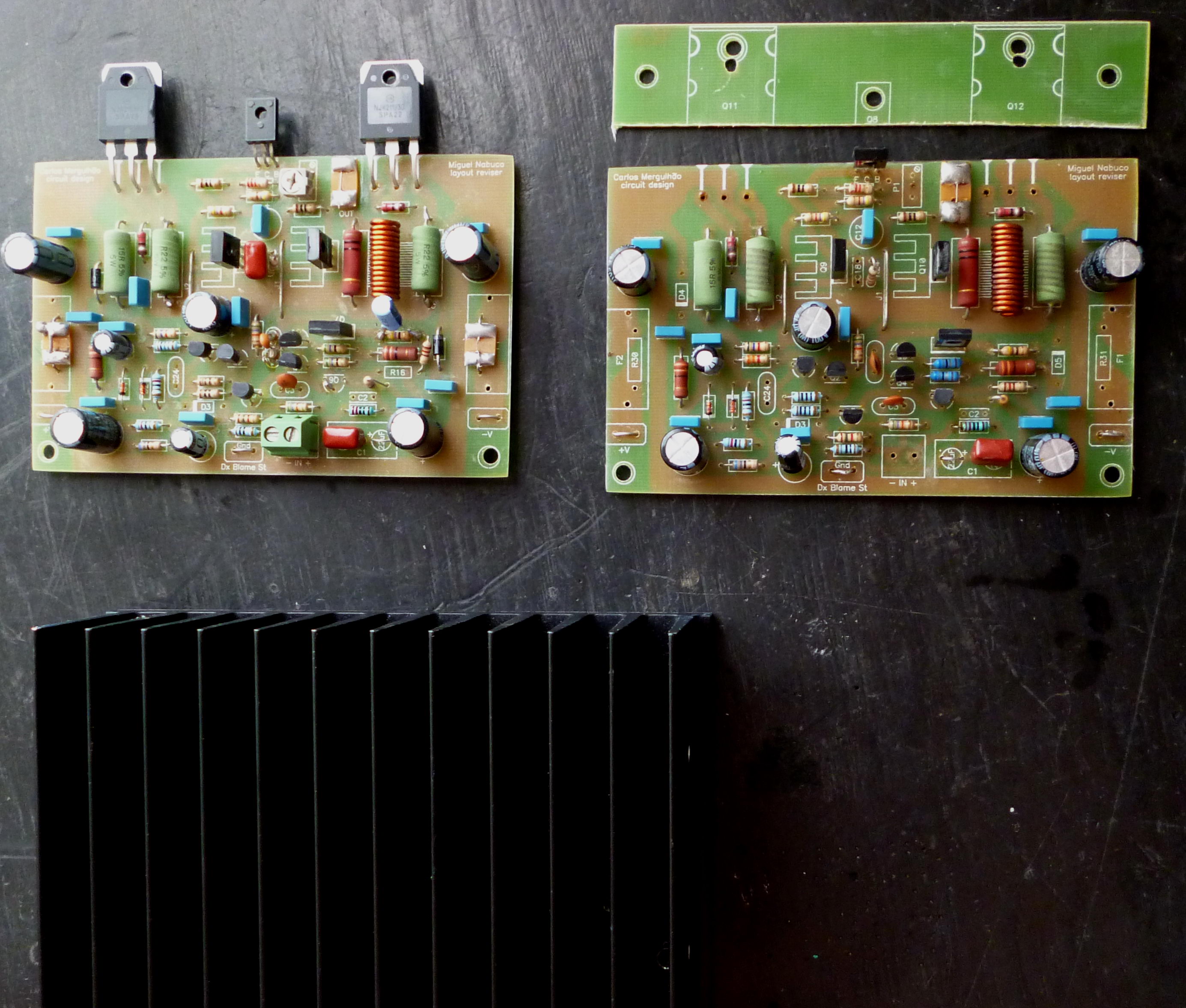

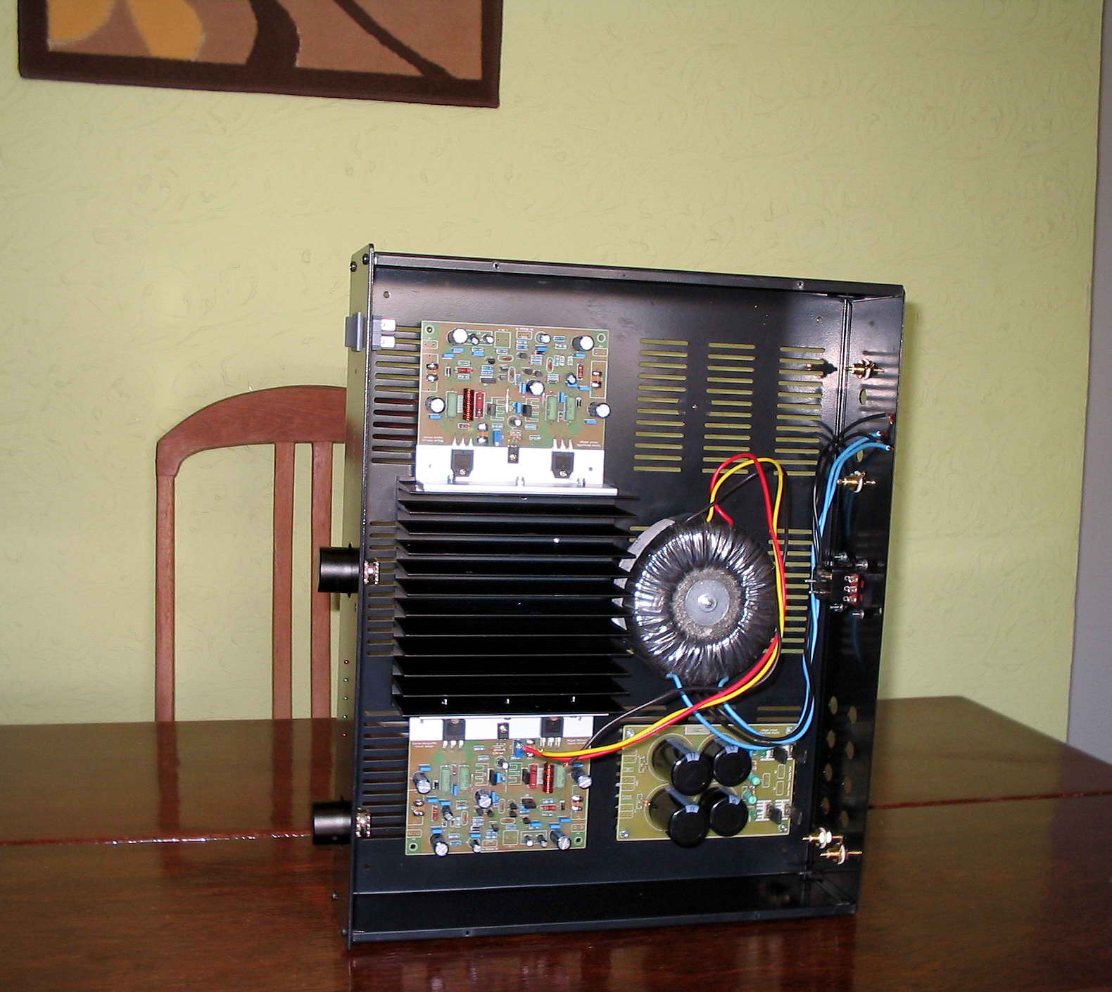

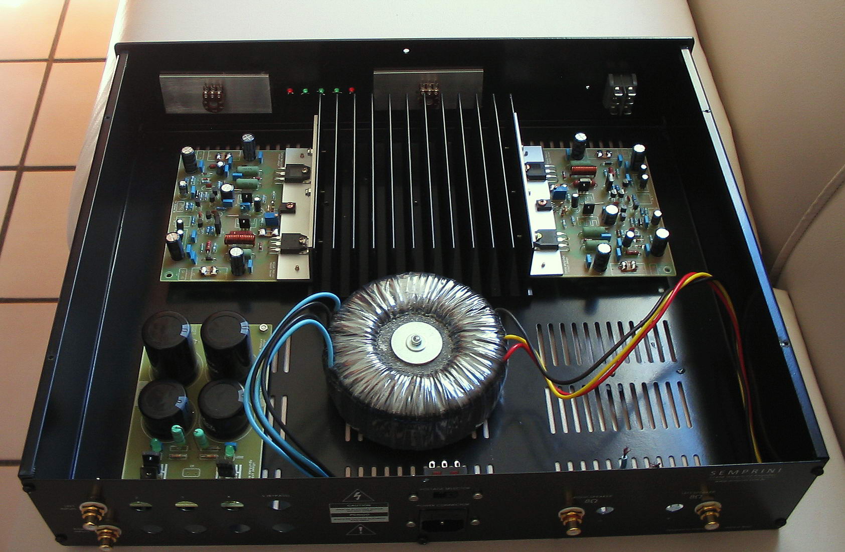

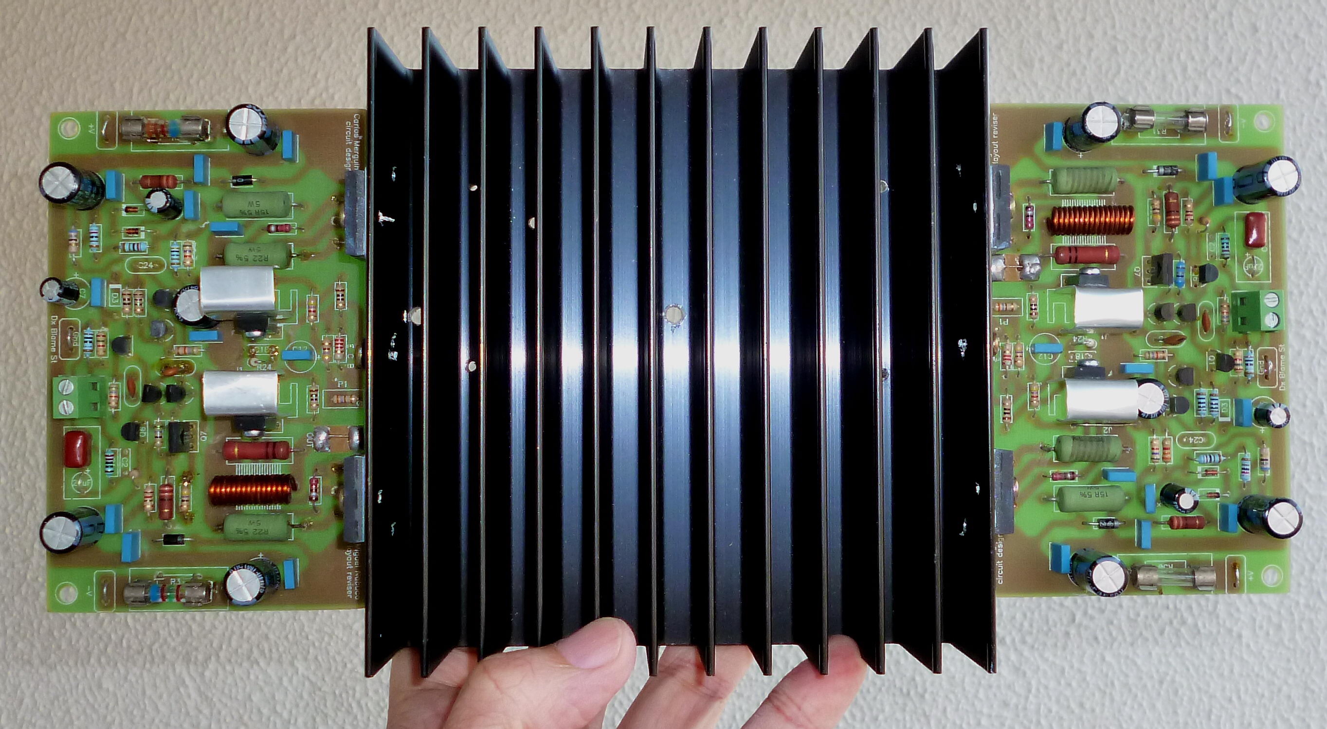

I have assembled the Dx Super A into the Dx Blame ST pcboard
was adapted to operate 8 and 4 ohms only (one single pair of output transistors)
It is not ready...some parts must be adjusted and fuses should be installed..no bias trimpot, i will use fixed resistor instead.
You see the enclosures i gonna use..they are the Dx Blame ST model, now i will put Dx Super A in my main enclosure and transistors will go direct into the heatsink using mica insulators and thermal compound.
The Super A diodes and circuit will be below the pcboard assembled in a mini circuit board.

Now it is time to check, to clean, to measure resistances
from positive rail to ground, from negative rail to ground, from positive rail to negative rail, from output to ground and to inspect all solder points.
Then i will install series protective resistors to check bias, this one is using resistor preset, some kind of "plug and play" bias (trimpot replaced by a fixed resistor)
And then it is only pleasure and strong emotions when driving it hard.

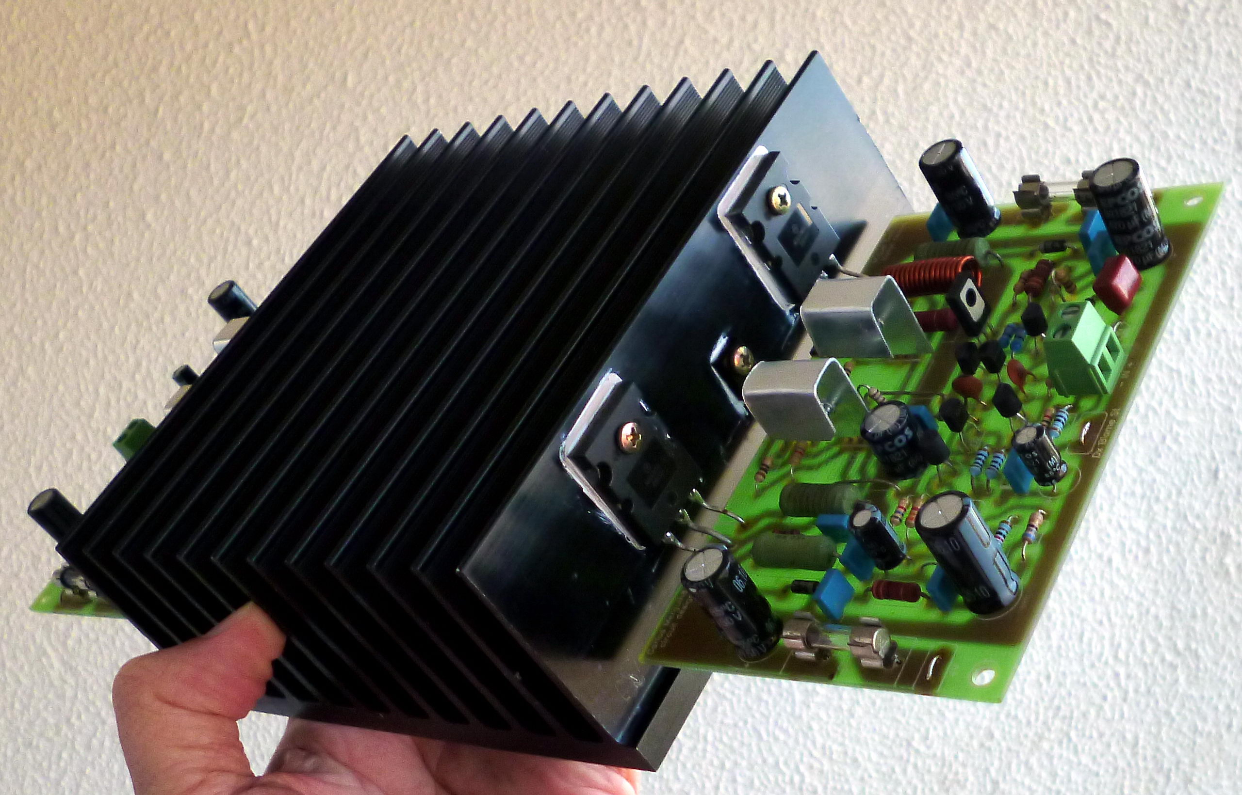

You see..transistors direct into heatsink, mica insulator and thermal compound.... a fan will be installed too.
This is to 8 ohms and 4 ohms only.... reason why i am using only one output pair.

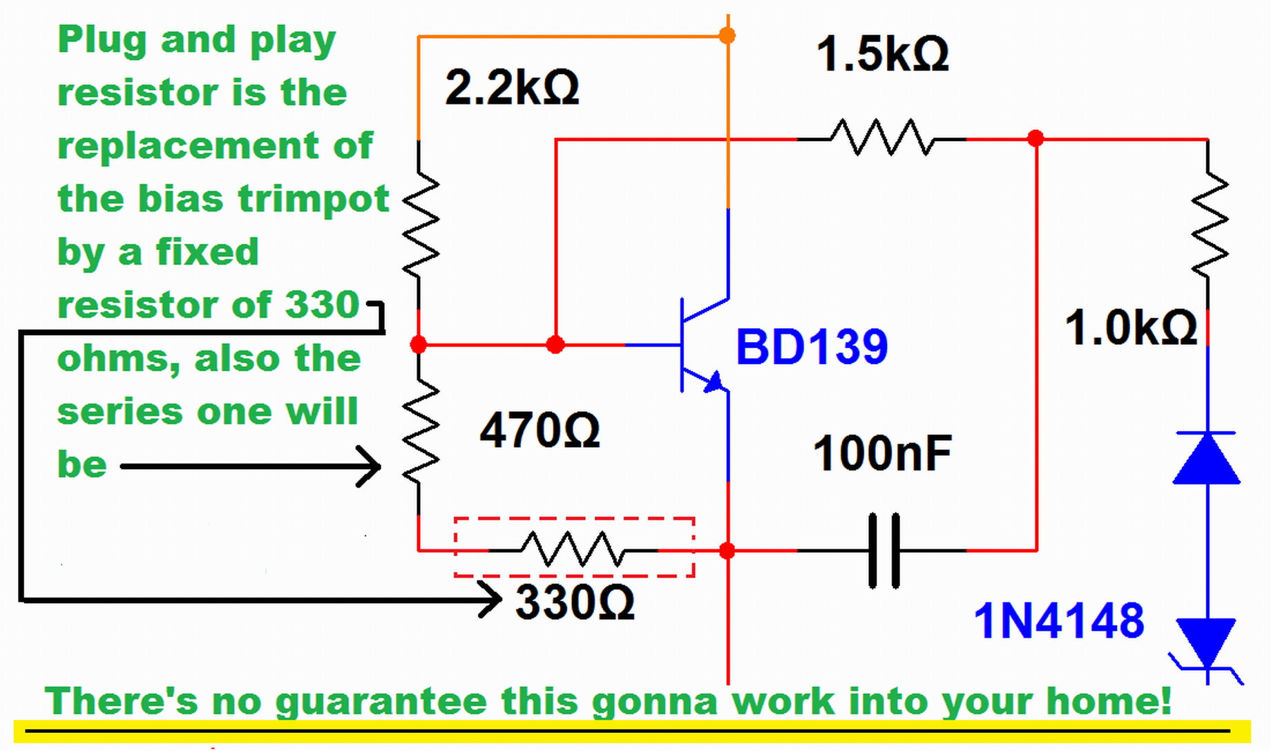

Hi Mr. Carlos,
I will be interested to see your plug and play, pls explain also how you do the adjustments and parts to change.
Thanks,
Wattodo
Thanks,
Wattodo
It is a 330 ohms fixed resistor in the place of the bias trimpot
But this will not work with all BD139 you can find in the market...so....it may work to me and not work for you.
Fixed resistor is 470 ohms.... added to 330 we have, as a result, 810 ohms from base to emitter into the VBE multiplier transistor (bias adjustment transistor.... stand by current adjustment transistor)
Current can result too much big or too much small depending the gain you will have in your selected BD139...will not have same result as i have at my home unless you use the transistor i have at my home...ahahahahaha!
Plug and play the same way we had plug and play pcboards to computers in the past...never plug and play..we had the need of software and adjustment and to ask windows to search for a better driver.... it is a plug and play you plug and sometimes does not play the way you want...the same we had in computers.
You do not know me Wattodo, i love to be kidding as i have a very good mood, i use to be ironic related the lack of decense and truth we find in human kind..... plug and play was a hoax applied into the market!...not serious....and my plug and play is just to have fun...will be plug and play to me...only to uncle charlie, because i will plug and will play with it and will not bother if the current is a little bit higher or lower...will be plug and play only to me!
Plug and play, sometimes resulted fine..also this fixed resistor, sometimes, will be good.......... you inow what-to-do whattodo.

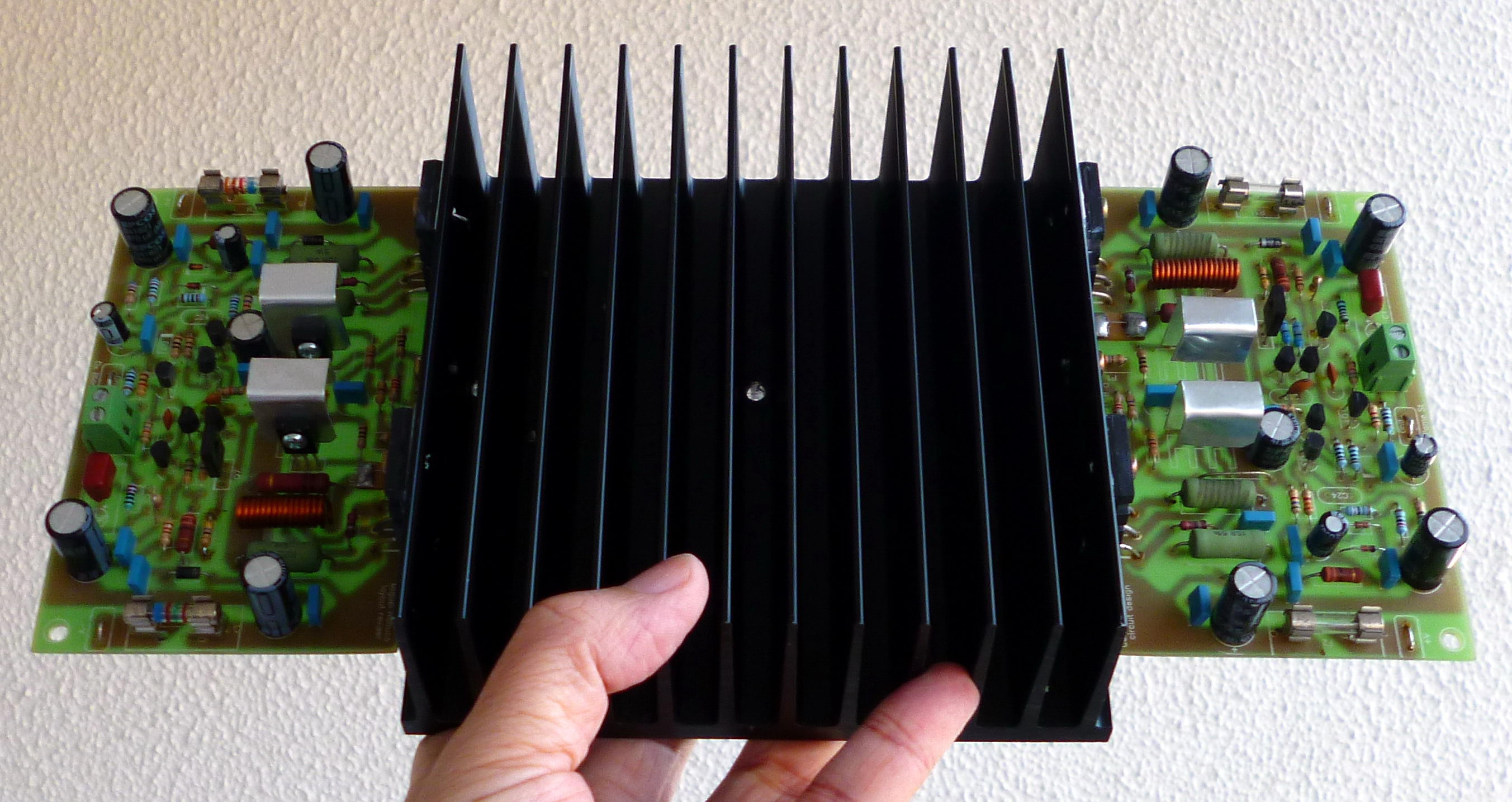

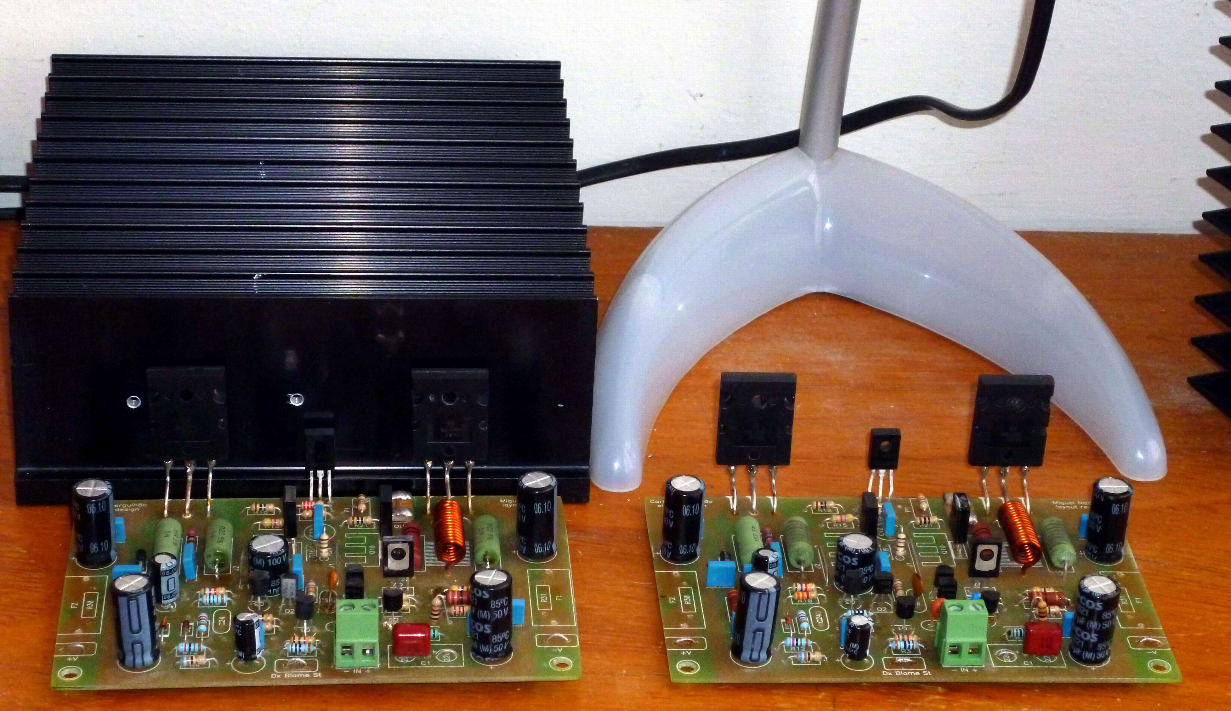

hello Carlos!
I'm not an electronics expert but I have a question running through my head.
Q30 and Q37 (BD139, 140) mounted on the same heat sink as the final transistor they will have no problem to evacuate their own heat?
Apologies if I say foolishness. 😀

I do not discuss theories.
If you feel afraid of thermal drift...do not assemble this amplifier..it has and i made it this way..i calculated it this way..i want the effect.
Was tested and no problems using fan.
Theories only creates troubles..... questions alike that, drive people to "land" here to discuss the sex of the angels (they have not sex)..and this does not help us.
Theories does not make sound.... analises of my design also does not change it's real world behavior.
So, it is a big waste of time, as i use to test to make my units shielded against buggers.
People when cannot create things, have not courage, or skills, hate you because you do and then they try to destroy your design...and all starts with an innocent question alike yours.

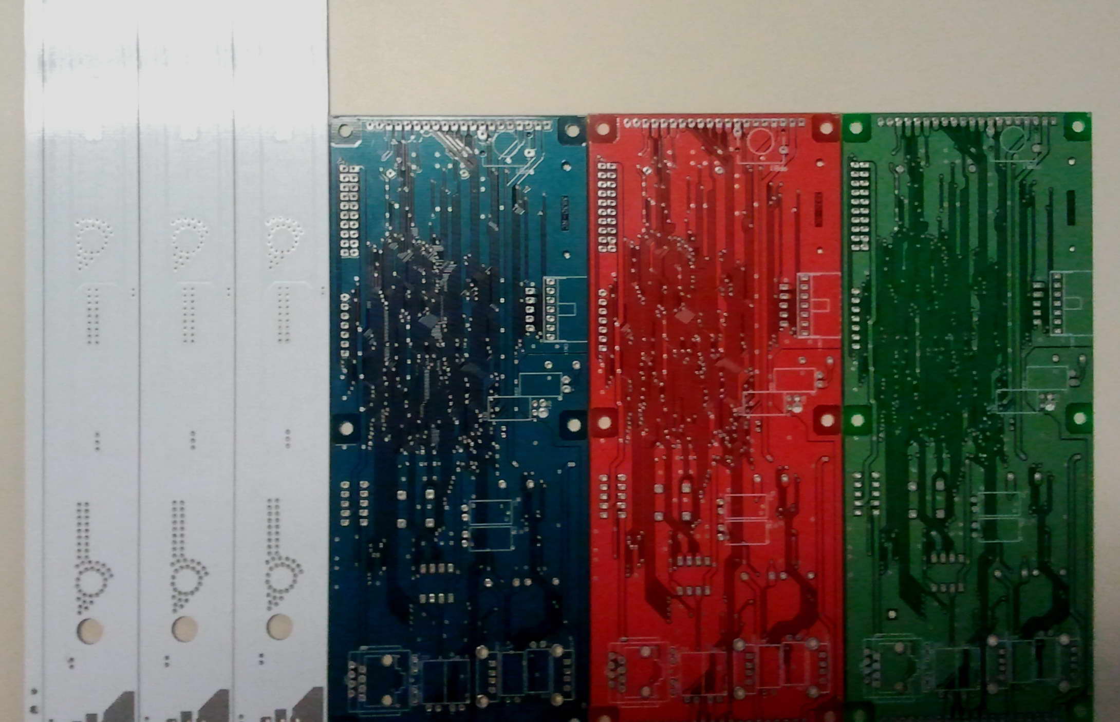

I am so happy Zimmer found a Brazilian factory that does the pcboard
In white with black silk screen...and can put the silk screen in any colour i want.
Sadly could not make the pcboard at the light brown milky colour i wanted... alike light Coffee mixed with Milk.... something traditional in my country is Coffee mixed with Milk and bread with butter (french bread we use here..baguette).
But white is also reasonable...and sometimes because some ink metalic component, it becomes yellow when time passes by and may reach the colou i want when time passes by.
I had a Technics system this way...unforgeatable unit and i regret i have sold it...was a terrible foolish i have made...the unit was very good....and it used this kind of pcboards.
